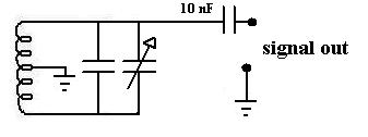

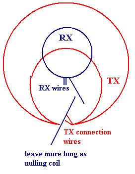

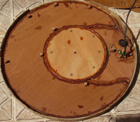

    I built some omega coils, because I start building I/B detectors with Heathkit GD-48 of 1969. This is very precisse for pinpoint items. For example I found 30-40 g extremely pure and white silver nugget at depth no other detector can detect. Good relations for these coils is transmitter 27-28 cm in diameter and receiver 11-12 cm, but in general receiver can be 1/3 (33%) of the transmitter diameter. In previous adjust you can select for non ferrous items, this is the coil has 2 critical adjust, one for all metal, and other for non ferrous. Is important that receiver coil will resonate with minimum capacitor, in Heathkit case no more 1,800 pF, better is you wind more wire and only use near 1,000-1,200 pF. You must fix very well all the wires, but you can leave free an only wire of receiver (is the wire you found that influences in fine final adjustment as nulling coil, this mean, this no glue wire can actuates as nulling coil). Also, you must adjust the coil with all metalic part inserted and don't use simple paint for the housing coils, prefer synthetic, no based on metalic lead pigments, this destroy totally the balance. You can use a small capacitive trimmer in receiver for to resonate well at the receiver TX frequency as for more critic adjustment.

      Hi boys
      Why you do use this heavy and hygroscopic wood plate holder?
      Why do not use lightweight, withstand and cheap plastic flower pots (salver)?
      Like this suite of plastic flower salvers (usable for factory coil protection too):

        Hi Esteban,
        I don´t understand how you null this coil, there is no overlapping between them.Is this the way it is built?
        regards,
        Fred.
        • #79
          ... but you can leave free an only wire of receiver (is the wire you found that influences in fine final adjustment as nulling coil, this mean, this no glue wire can actuates as nulling coil).
          Hi Esteban,
          You mean both receiver wires, the ones which are conected to the capacitors, right?
          The center tap can be glued. Agree?

            Hi boys
            Yes, you're right, this was old coil built more 20 years ago...
            • #81
              You leave more long an only receiver wire that you note thats affect adjustment. This actuates in this Heathkit, don't know is useful in other detectors...
              • #82
                Ok i understand ,
                So the omega Tx in under the round wooden disk...
                regards,
                Fred.
