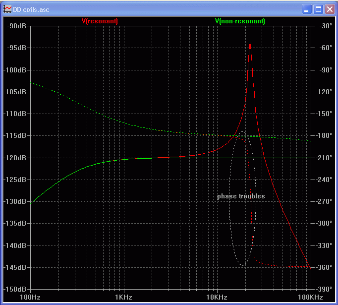

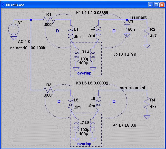

    Now regarding the IB coil systems. I made a LTspice simulation of a DD coil system, with values according to my gut feeling. I tinkered a bit with coupling to achieve some 120dB Tx suppression, and copied everything to show situation with resonant Rx tank, and a non-resonant Rx coil. This arrangement is as such for future experiments purposes - I did not put any target there yet.
    Even here It is obvious that the tank resonance screws up phase so badly that any discrimination at resonance is doubtful. Also it is obvious that below resonance there is not much going on that would be any different from a non-resonant case.
    So, have fun and play with this. This arrangement will be easy to adapt for concentric coils as well, and of course with more life-like values.

        My thoughts went to that direction as well. There are too much "wet grass" etc. effects called upon with a common denominator: E-field coupling. I'm almost certain my Rx coils will be bifilar with center tap to the signal ground, and Tx will be fed via separate pair.
        Yes, a number of people have gone through that exercise, but always good to have another sim to play with, thanks.
        It does illustrate why Tesoro (and others) probably go with off-resonance designs -- any little component parameter deviation (manufacturing tolerances) would create a hefty phase bias if the TX frequency was at RX tank resonance.

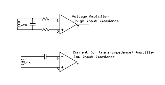

              Both parallel or series resonance are the same phenomenon, but the way you take a signal off it makes it series or parallel. In series you see a very low impedance, ideally only parasitic resistances of the tank components, and you are basically measuring current that passes through. Equivalent circuit of an ampere meter is a short circuit. Simultaneously you may measure voltage across a coil and from that point of view it is a parallel resonance tank. In both instances a coil has some voltage across and some current going through. As the voltage is a function of magnetic flux, you are better off if you allow current to flow - thus maximizing power transfer. To ensure current flow you may either connect a capacitor to a coil and achieve resonance, or you may connect it to a low impedance preamp.
              Because of the phase problems in resonance, I think the way around it is using a low impedance preamp. If you go too low you'll have some phase shift, but uniformly so, and not a step function as in resonance.

                          Ok, sounds like your talking about minimizing noise, different topic from "on-resonant" design phase-shift problems.
                          I'm guessing that you are comparing these two configurations for noise?

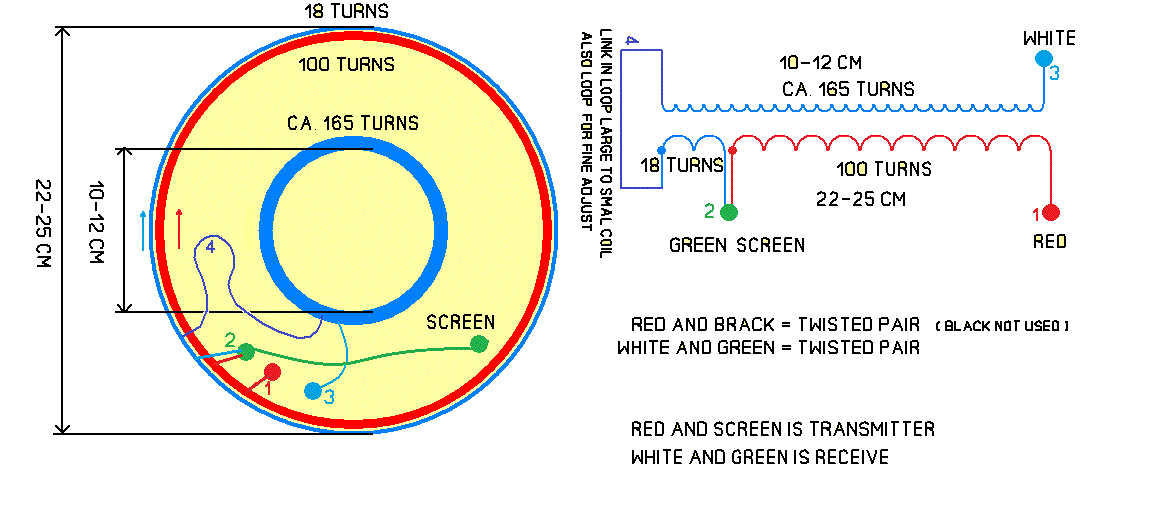

                              Hello Dave,
                              Made some photo’s from the coilwindig forms I used… they are from late 1980’s …so no computer software then, but the made coils worked fine.
                              To make a CC coil :
                              Start with the transmit coil, as seen on the large 22,5 cm form 97 turns give’s 14,5 KHz, (114 turns is 12.5 KHz.) Wire used is 0.25 mm and the coil is connected to the Tesoro transmitter so the cap from the oscillator has also influence at the transmit frequency !
                              The first receive coil, 18 turns, is added at the 22.5 cm coil, same wire and turn direction . Transmit coil and first receive coil both clockwise !
                              This 18 turns will , just like in a transformator, pick up a part from the transmit signal .
                              If the transmit signal is 15 volts then there is 15volt /97turns = ca. 0.15 volt per turn wire so the first receive coils 18 windings pick up 18x0.15 volt = 2,7 volt.
                              Now the trick is to null out this 2,7 volt … this must be done by the second small receive coil, As the distance to the transmit coil is greater the magnetic field is smaller, so less volts per winding.. so more turns are needed to get that 2,7 volt. AND that voltage needs to be in opposite faze , so the windings for the second receive coil have to be counter clockwise !
                              For a 10-12 cm coil form some 160-170 turns are needed, also 0.25 mm wire. The two receive coils are connected in series but picking up the volts in opposite faze's so the result is zero.
                              If you have to move the small receive coil towards the transmit coil (stronger magnetic field) then you have to add windings at the small coil….if you have to lift up the small receive coil (less magnetic field) than you have to reduce windings…
                              For the receive capacitor look at the first opamps output… select the cap for a nice sinus out.
                              Good luck !

                              Apberg, would you please draw a schematic of this coil?
                              • Originally posted by Wiltran View Post
                                the cable used is a 2x2 pair screend cable, the ground connection for the receiver is made in the coil, this is needed this way for the twisted pair effect, .. the black wire is not used.. prevents earthloops...
                                If the small coils is picking up a much to large signal... just turn it upside down......if it needs to lift up to get a null.. there are to many turns , if it needs to be moved to the large coils for a null ... some more windings are needed.
                                Hope it is all ok ..... but if needed corrections are welcome...
