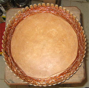

    All sorts of coils have been made for PIMD's.
    Are there still improvements possible?
    I believe there are many improvements possible.
    Attached are some pictures.

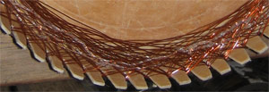

    1mH_1Mhz_coil and close-up of the winding, is a coil winding, still on the winding form. The coil has a diameter of 27 cm.
    Inductance is 1mH.
    Self resonant frequency is 1Mhz. I hope this coil will give a broad RX sensitivity field.

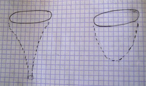

    Coil Focus are representing RX sensitivity fields.
    To the left, a deep going sensitivity field that is funnel shaped. It goes deep, but the sensitivity focus at the deep end is very narrow.
    To the right, a broad sensitivity field that does not go as deep but will have much better coverage.
    I have not found much information in the public domain about focusing the detection sensitivity fields of PI coils.
    Any information would be welcome.

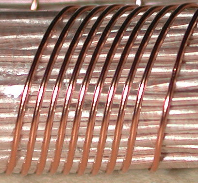

    c) Using very thin enamelled wire wound across the wires. This wire goes from the coax shielding (soldered to shielding) to half of the coil. Another wire is wound on the other half. They are not connected together - they are only connected on one point of the coax shielding. The windings could be spaced on every 1-2 mm. It depends on the wave length, which EM fields you want to screen out. The closer the windings, the higher EM's could be screened out. But the closer the windings, the more capacitance it will be.
    c) is probably not used yet. But this gives much improvements on PI coils and one should make some tests on it.
    Aziz
      Following image illustrates the very low eddy current shielding ( option c):
      I haven't built such a coil but it is an idea to check out.

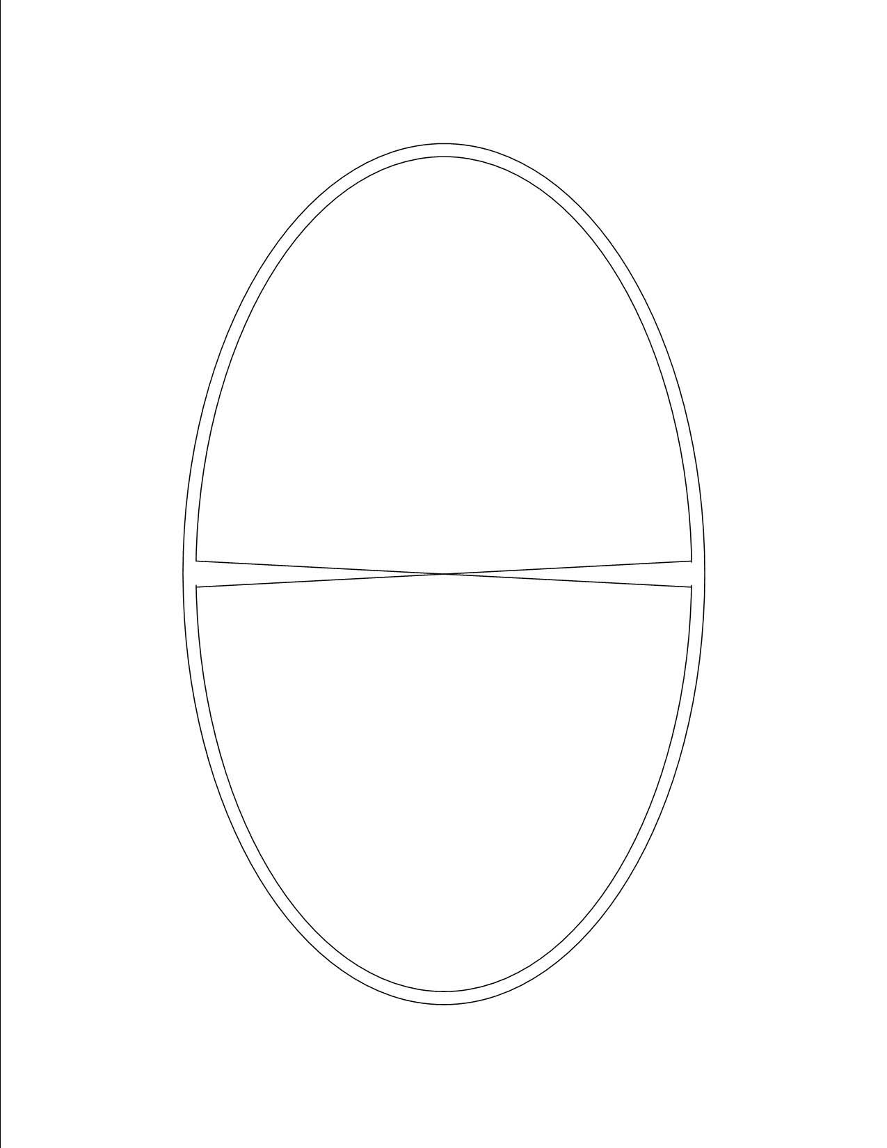

        BTW, I made a 9 1/2" x 4 1/2" eliptical figure 8 coil (as in attached diagram). I am pleasantly surprised by the results. Every bit as deep (maybe even deeper) than my 11" DD, and much much quieter. Windings were: Tx 7.125" 23 turns 298 uH, RX 9.54" 27 turns 575 uH. I think I may make a 15" x 4" rectangular version of a figure 8. I really like that coil!

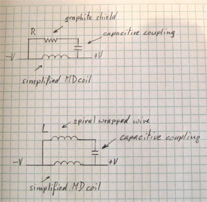

          2)Shielding
          a)+ b) I have been using a spacer of 8mm Polypropylene/air board between the coil winding and the graphite composition shield. The results are good.
          Again, there is a compromise to be found between distance and capacitance.
          Air is the best spacer, therefore foam material is ideal for securing the coil within the housing to avoid any movement. Glass micro-balloon filled Epoxy resin would be easy to implement and should give good results.
          b)Hmmm, the way I see it, the spiral wrapping wire would act like a capacitively coupled inductor.

              The method c) is not inductively coupled to TX coil. It is only inductively coupled to any possible external magnetic field.
              Reason: flux area is perpendicular to magnetic field generated from TX coil.
              A spacer like the shielding should be used before winding the super shield. An insulated thin wire core with thick insulation would be fine to keep the inter-wire distance constant.
              Anybody interested on the super shielding?

                Hi KingJL,
                your elliptical coil looks very interesting. Could you make a few tests for me? Compare it's depth with a 9 1/2" mono coil?
                Do you sweep the coil in it's longitudinal direction or the narrow direction?
                My coils,
                The 1mH, 1Mhz coil is wound on the cut-off bottom of a plastic bucket. I have not tried it out yet. If it works good I will remove it from the mold and use it together with a TX and a Bucking coil, shielding all 3 coils.
                I lost count on how many turns this coil has, kind of hard to count the turns after it is made.
                It is wound with #30 magnet wire.
                I am planning to make the TX coil of larger diameter and the bucking coil the same diameter as the RX coil.
                The bucking coil in close contact with the RX coil, above the RX coil.
                The TX coil wound in a square bundle, adding Polypropylene/air spacer between the windings.
                The bucking coil wit the same kind of spacer, but spiral wound to have the same maximum and minimum diameter as the RX coil and then lay it on top of the RX coil.
                The drawing of the coil with the funnel-like RX sensitivity field refers to a coil that is spiral wound with only a small hole in the center. I have built several coils with this configuration and observed the RX sensitivity field in experiments.
                      Aziz

                        Tinkerer,
                        Sorry but I have no mono coil to test with. Only a 11" DD and this figure 8. In the future, I am going to make a bigger figure 8 and a 11" coplanar concentric.
                        The eliptical figure 8 is mounted with the long axis pointint to the front and back. The front half of the figure 8 is the 'in-phase' signal (giving a positive response) and the back half gives a 180 degree 'out-of-phase' signal (negative response). The housing is from Hays Electronic. It is the 'Goldbug' style.

                          Which coil current? I have no idea, what you mean by that.
                          The second fact of this super shield is, that only middle part is connected to coax shield. Other endpoints of the shielding has no potential to any electronics nor to each other (because not connected).
                          The shield acts as a very low eddy current causing EMF shield.

                              Hi Tinkerer,
                              there is still improvement to squeeze out:
                              1. Coil capacitance and effectivity:
                              Coils making not too much wider. Instead, one could wind in the height direction too. So some distance ring could be used for this. The result will be a square cross-section coil. The wire intercapacitance can be kept low to make PI coils faster.
                              2. Shielding:
                              a) Shielding should not be directly made on the coil wires. Some distance 1-2 mm should be used, to lower the shield capacitance.
                              b) Using low eddy-current shielding:
                              High impedance (high resistance) coil shielding can be used. Such as with graphite shielding.
                              or
