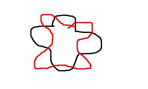

Hello , I think Tesoro spent so many years on improoving their detectors that they left the search coils alone. Now they are following the pack . Whites has new "300" search coils and minelab [last time I checked] added some new coils. I don't think Tesoro added electronics in the search coil housing , Just improoved the coil itself. If anyone hear's different please comment..........EugeneAttached Files
