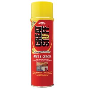

              I was wondering if anyone has tried this product for a search coil sealant ???? And does this product have any electrical characteristics , that may have a negative effect . It is spray foam I have used for plumbing insulation , but I do not have a can at the moment . I am not trying to sell or endorse this product !!! But , it is just an idea for quick search-coil making . .....Any ideas on this , or a similar hard drying Foam ????.............Eugene
                Great Stuff is OPEN CELL type foam. No Water Proof.
                  Neutral Buoyancy Coil
                  Thanks Homefire , If it is not waterproof then we will scratch it off the list , or use "Great Stuff" as primary , and have a secondary type paint or coating that is waterproof. I am sure there is something similar on the market that is waterproof . But ApBerg has found a good system to set a coil . And I am sure others will post on this subject also.........Thanks......Eugene
                    I just wanted to point this out, in case anyone decides to try and go down the same path I did.
                    I tried using "Great Stuff" to fill a void area inside a coil enclosure. I drilled a hole in the enclosure and sprayed "Great Stuff" deep into the void using the tube that is supplied with the product. It foamed out of the hole, and the overflow dried to a nice firm consistency.
                    I figured all went well, until I removed the foam covering the hole. The foam inside the housing did not expand and dry like the foam that came out of the hole did. It is now just a gooey mess inside the housing, not hard foam at all. I guess I'm going to hope it eventually dries and just leave it as is, with a big void.
                    Hopefully this warning will save someone from the same frustration that I have right now.
                      Hello Hobbes,
                      Tray to find 2 component PU foam (polyurethane) it is a closed cel structere foam that after 1:1 mix expands its by volume 25x. You need very little to mix for a coil , the time you can work with it is ca 2 minutes ! it is hard after ca 60 minutes .
