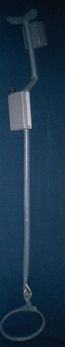

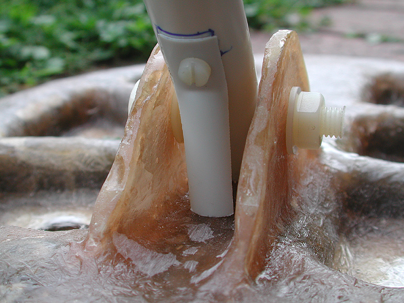

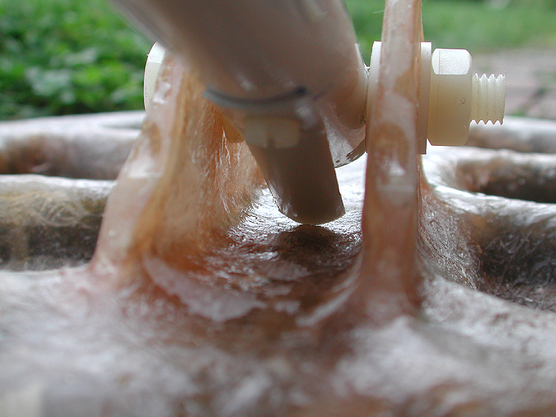

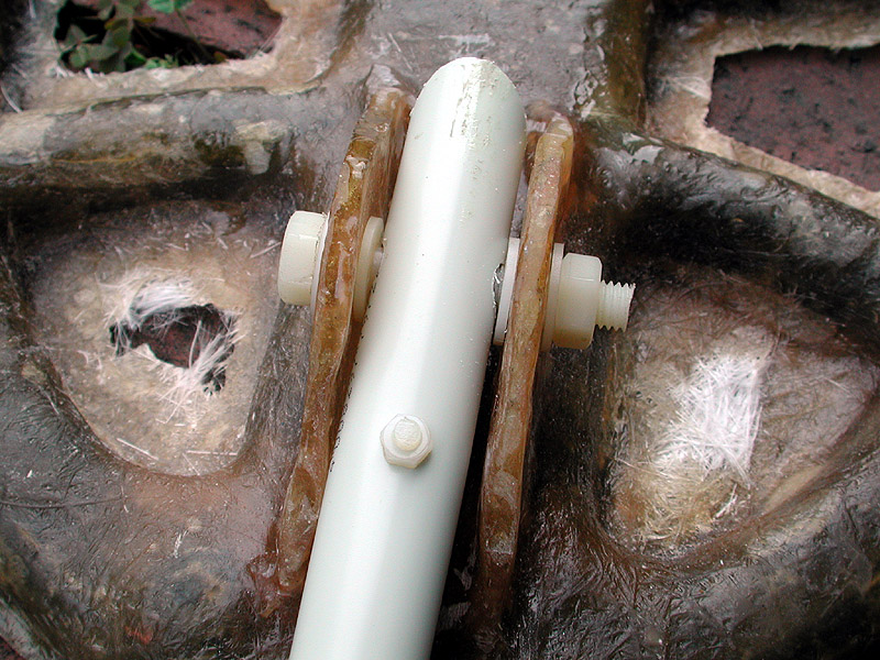

    Now the stem mounting is finished. See below the basic assembly. The stem can be layed down for convenient search operation. It is very basic but working well.
    Aziz
      Love it Aziz -- very interesting everyone's homebrew manufacturing, looks excellent! Hope the stem supports are strong enough, I was wondering if they were a little thin from the beginning, but looks like you thickened the bases nicely. Fiberglass is tough stuff I guess. Should be a really good coil, looking forward to hearing results.
      Cheers,
      -SB

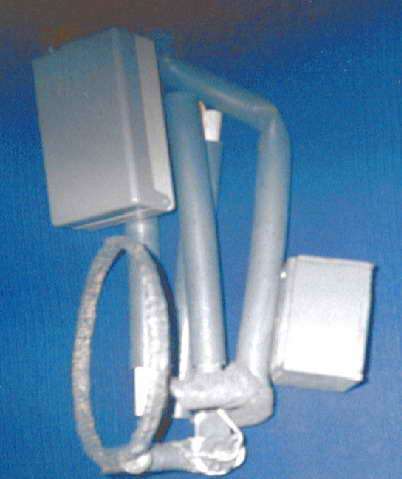

          Well, this one looks quite ugly, but must be easy to disassemble and carry.

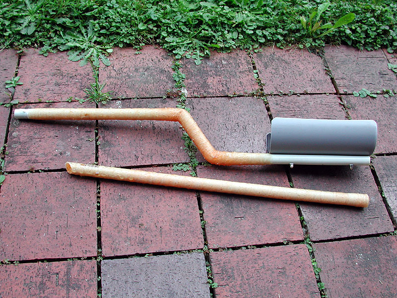

                    I have filled the plastic pipe with PU foam. It seams, this is not tight enough. The stem is bending over and swinging. Telescope stems are quite tough but not metal free. I have searched and searched but nothing convenient found yet. Bamboo would be good - but I haven't found yet.
                    If I find not an appropreate stem, I will tighten the stem with one layer fibre glass + resin. Also the whole stem will be stickable to put this in a luggage. I am planning to take my first prototype with me around the world.
                    Aziz

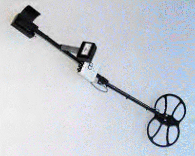

                      You could also make a wooden stem, like the earlier Nexus detectors. It folds in the middle, instead of being telescopic.
                      You can just about see it here:
                        Maybe not sleek but perfectly practical -- will probably use with my bamboo.

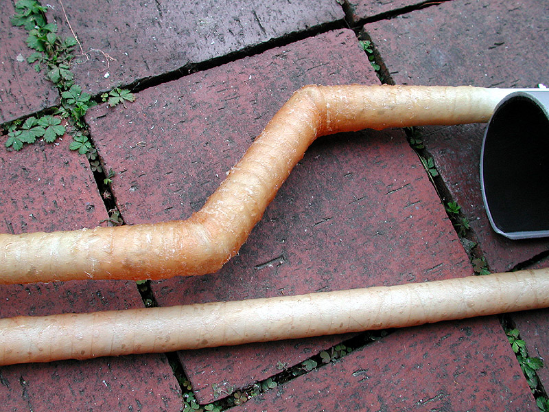

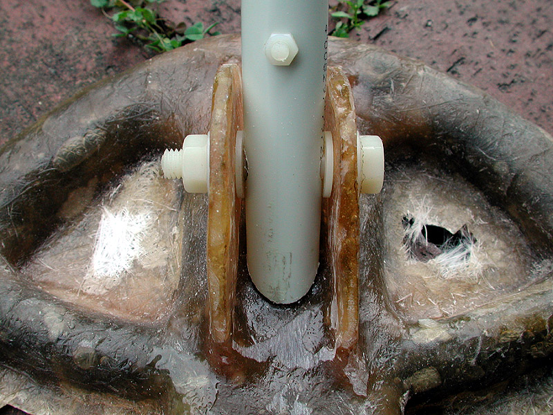

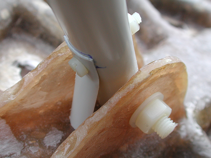

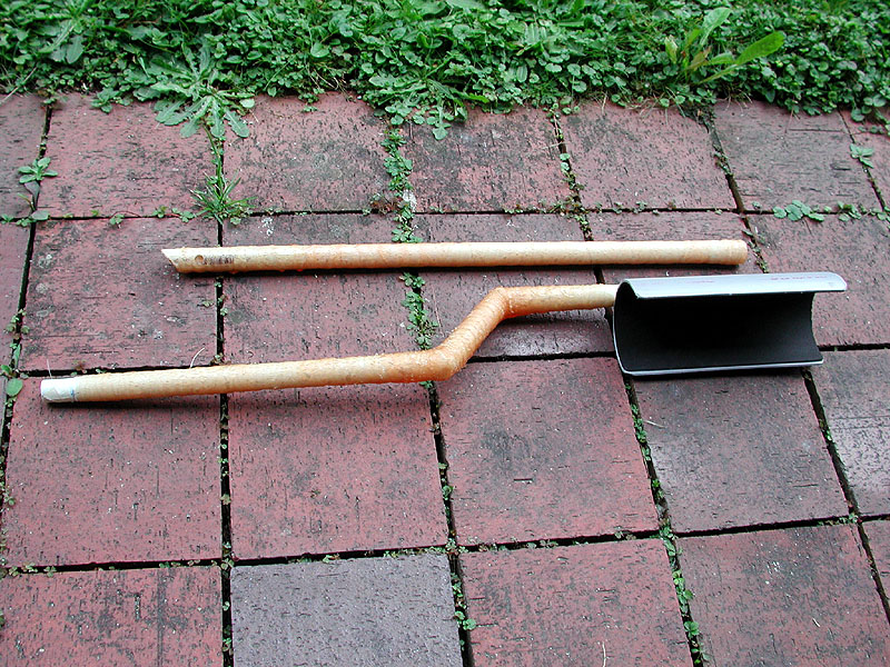

                          I have started to tighten the coil stem with fibre glass and resin. Even one layer is not tough enough. So I have to do at least two layers. On the bound part, where the stem is be held even three layers. This makes the stem heavy but very tight. It looks aweful. But I want a good working detector - not a good looking one. I will paint the coil and the stem with white paint, when the coil is finished.
                          Aziz
                            I am now satisfied with the mechanical stability of my coil stem despite of its weight. See enclosed images. It consists of two parts which are sticked together. It has to dry at least one day before grinding and painting them.
                            Aziz

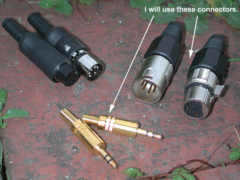

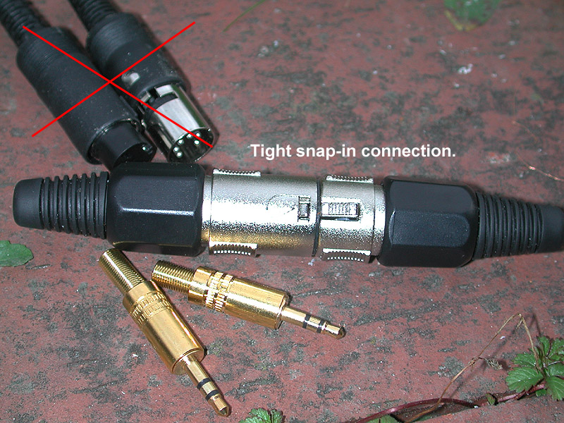

                                I am going to use the following connectors (see below). There are high quality 5 pin audio connectors with gold plated pins. Also two 3.5 mm stereo connectors for the sound-card input and output. I will not use the shown left one (low quality). I haven't found the right cable so I will use three RG174 coax cables which are bound together with tape.
                                Aziz
