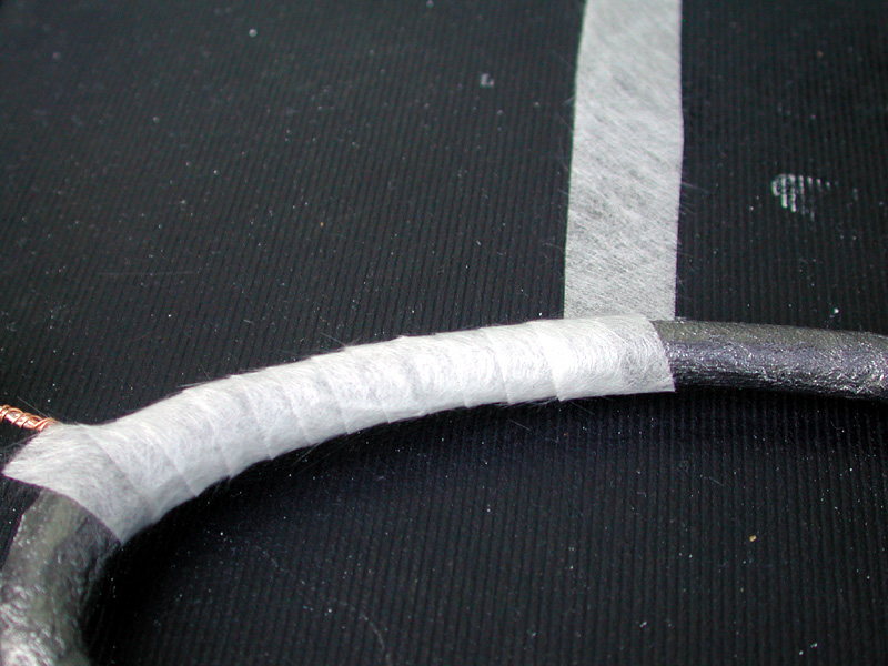

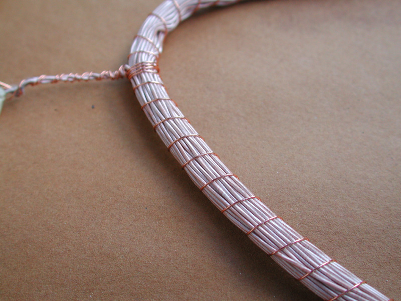

    I am fixing the coil windings first with a thin enamelled copper wire. One end of the wire is connected to shielding. The other end is left open and isolated (potential free). Or you can bind the windings with some fishing thread instead of enamelled copper wire.

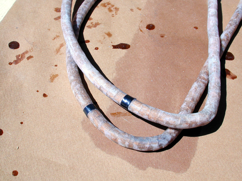

    Then the windings will be fixed with fibre glass and resing. After that the shielding is made. To protect the shielding, a second fibre glass layer is done. Although this makes the coils quite heavy but very very tight. One layer of fibre glass is also quite stable. The resin goes into the coil windings.
    See pictures below.
    Aziz

      That sounds very good, the resin going into the windings. Should be a very quiet and durable coil. It is exciting to see your laptop MD being born.
      Keep us posted,
      -SB
