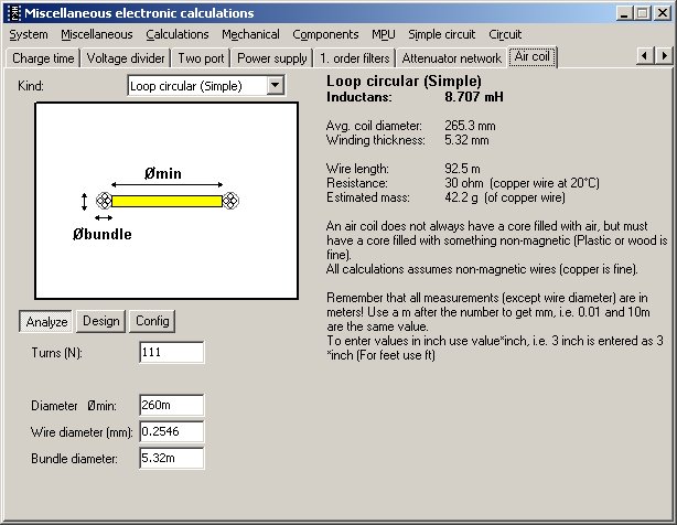

              I downloaded MiscEL and ran a comparison on SB's data:
              In CoilCalc I entered:
              Inner Radius = 130mm
              Wire Thickness = 0.2546mm
              Number Of Turns = 111
              Results calculated as:
              Mean radius = 132.66mm
              Coil Thickness = 5.32mm
              Inductance = 8.111mH
              In MiscEL I entered:
              Kind = Loop circular (Simple)
              Selected Analyze
              Turns = 111
              Diameter (min) = 260m
              Wire diameter = 0.2546
              Bundle diameter = 5.32m
              The result was:
              Inductance = 8.707mH
              Since MiscEL expects everything to be in meters, you have to enter an extra 'm' to switch to mm, except for the wire diameter.
              SB has measured 12.3mH for a real coil with this number of turns. It would be interesting to know what wire type was being used, as both these calculators presume the use of enameled copper.

                        Where is inductance displayed in MiscEl? I don't see it?
                        -SB

                            Top right:

                                Top right:
                                Whoops - problem was I also filled in wire diameter -- over-specified! Only fill in red fields is the rule -- probably obvious to anyone with good fashion sense...
                                (Another rule - in some inputs, must have leading 0 before decimal fractions, e.g. "0.2546", not ".2546"! obvious???)
                                Now I'm getting a little closer with MiscEl:
                                Multi-layer, N=111, L=3m, Dmin=260m, Dmax=262m, Inductance= 10.23 (compared to 12.23 measured).
                                Using "current sheet" formula with same params gives Inductance=10.77.
                                Let's try tweaking parameters in multi-layer:
                                Multi-layer, N=111, L=.5m, Dmin=260m, Dmax=262m, Inductance= 12.21 (compared to 12.23 measured). Exact!!! But unrealistic coil length.
                                So the beat goes on...
