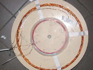

    I tried to build a coplanar coil. the transmit coil consists of 88 turns of 0.51 mm (25swg) enamelled copper wire,for a diameter of 22.5mm. The bucking coil consists of 27.16 turns of 0.51 mm (25swg) enamelled copper wire rolled up on the reception coil of 270 turns of 0.2 mm enamelled copper wire and for a diameter of 11.5mm. The assembly is made to work at 10khz. I respected the indications given on the site for the coplanar coil construction but that does not work. after several tests with an oscillator, I can't obtain the balance with the bucking coil. Somebody could help me to find what does not work in this assembly

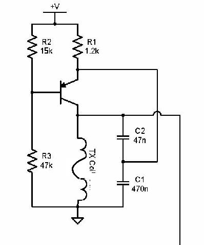

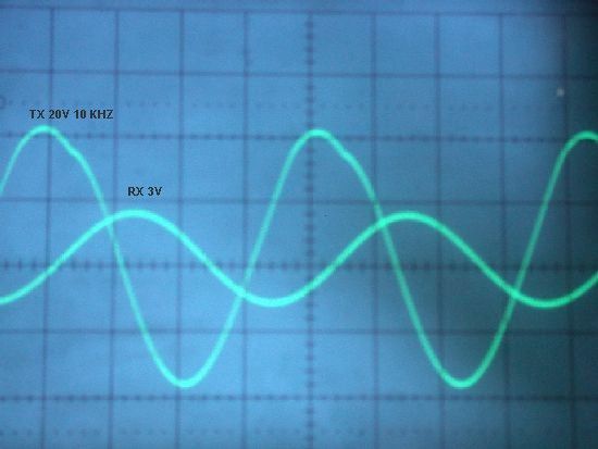

        I send the oscillator that i use and the signal that I see on the oscilloscope, with out metal near the coils

            Leaud
            I have to second exactly what Dave Emery replied to your earlier post. Looking at the amplitude of the receive signal from the coil it sure looks like the bucking coil is wound in phase with the TX coil. I just made my first concentric coil myself and got esentially the same thing as you till I reversed the leads on the bucking coil. It then dropped to 2mvpp on the receive coil. Another thing is are you sure that there is no metal anywhere close to the coil? I don't believe that I am getting as good of a null as I should even the 2mv signal is almost 6 volts peak to peak out of the amplifier. The extra half turn left loose between the TX coil and the bucking coil has almost no effect on the null in my coil no matter where I move it. I also read the patent that Dave referred to. I tried the placement of a shield between the receive and bucking coil, grounding it to the ground side of the TX coil. The null actually got worse. My next step will be to remove a few turns from the bucking coil to see if the null improves or gets worse. Good luck and let us know how you made out.

                For a 2mV signal to cause a 6 Volt output from your coil amplifier you must have a gain of around 3000. Woof!!! That is way too much for a VLF and extremely high for a PI. You need to reduce the gain and lower the output signal.

                    the bucking coil is connected the right way and I don't use a separate shielded cable.I followed your advices, I unwound some turns on the buking coil. the signal then dropped to 1 Vpp on the receive coil without metal near the head.The extra half turn left loose between the TX coil and the bucking coil has almost no effect on the null in my coil, I don't know why. I built this head for a VLF detector for bandido.

                      Looks like you did I nice job. I would change the cables to seperate shielded ones. I also use the small RG 174 for both Receive and Transmit. What do you have the Receive coil connected to, and what capacitance do you have across it? It's difficult to see for sure but is that a metal screw in the center of the coil assembly, and what are those 8 small round things around the outside of the receive coil form? I can't tell from the picture, is that the wire color or do you have the TX coil shielded? It looks almost like copper foil. Other than changing the bucking coil 1/2 turn at a time and retesting I don't have any other suggestions.

                        The receive coil is connected to nothing there is just a 100nF cap connected in parallel. In the center it's an acrylic resin screw and the 8 small round things around the outside are 8 holes. the TX coil in not shielded it's the wire color.
