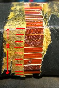

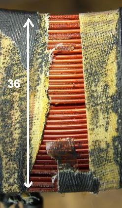

                36X8=288
                where is the mistake ?
                Edit: i see , you assumed round (or square) wire

                  Yes - I agree. It looks like 36 x 8 from the photos.
                  I think the mistake is assuming that the wire is square, when in fact it is rectangular. In other words, it's a flat cross-section.
