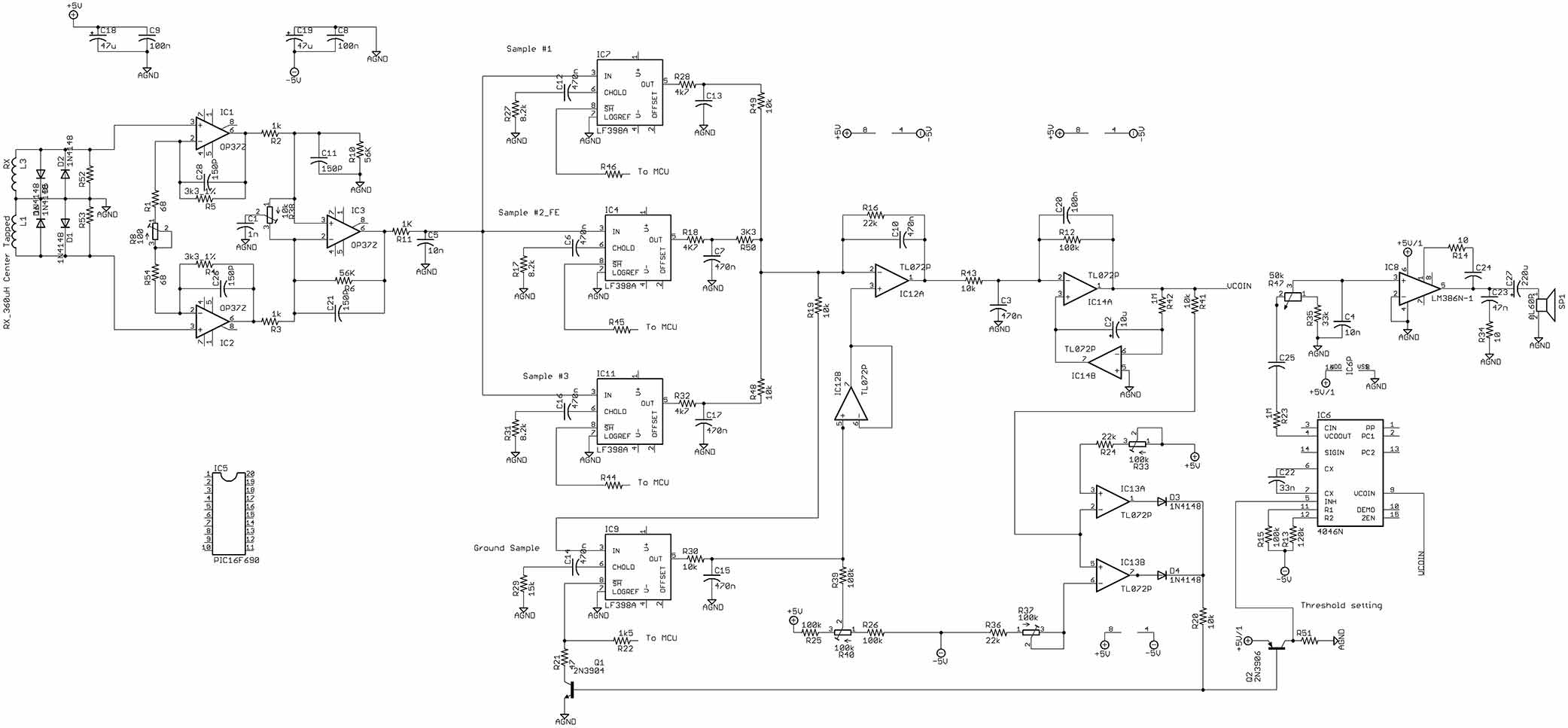

        Qiaozhi,
        thanks for the info.
        Two to four seconds per pass seems to be about one to two feet per second. So I would be somewhere near "normal"
        Now, about the pinpointing:
        If the TINKERERS has a reasonably fast response, the audio should indicate the presence of a target with a precision of about one, maximum two inches, when in tracking mode. A coil with an open center, or if DD open sides give an advantage there.
        For the TINKERERS_V1, I designed a tracking ground balance that switches automatically over to pinpoint mode with the presence of a target.
        Well, at least, this is the idea. There are still some problems to be solved.
        Problem #1, the pinpoint mode latches up at switch on. I need to add a reset button.
        Problem #2, the threshold:
        The signal is bipolar. It goes positive for gold and negative for iron. the threshold should be set at the edge of the noise level, in this case, there is a positive edge and a negative edge. At present I set them individually with R33 and R37 (see attached circuit), looking at the signal on the scope.
        I need to find a better way to do that and it has to be easily field adjustable.
        Any ideas are welcome.
        Tinkerer
