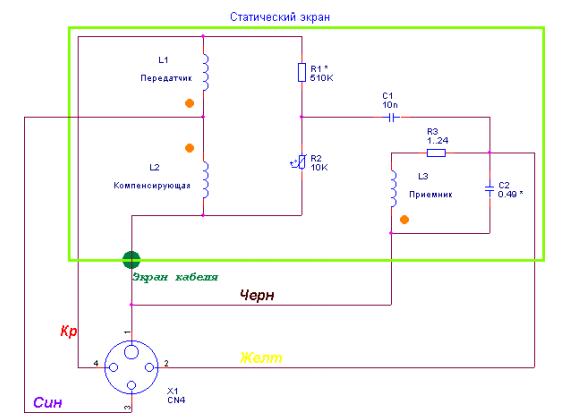

    Since he shows no photo or schematic for a visual. Here's one from a Russian Phazitron design. Maybe it will give you an idea or two.

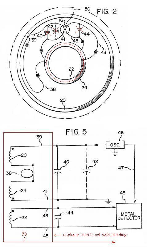

      How's this statement for you: Dave Emery does not show a resistor because there is not one to be shown in constructing the coplanar search coil. Ask yourself, If you were to tear apart a paticular Garrett Coplanar search coil should there be any components hiding there?
      Patent Drawings~Figure 2 shows capacitors used with a Garrett design. I have redlined the pics as in tearing apart a defective Garrett Coplanar...currently there are no components there at the search coil. Figure 5 should now be a more accurate view as I believe the components should already be apart of the boxed electronics.

        It probably depends on which Garrett coil you are referring to. The GTAx range do have components in the search head.
          Backwards Engineering At It's Best...
          Qiaozhi, Thankyou. Hopefully I will be able to come across a defective GTAx search coil. More important to me is to come across a defective TDI search coil first.

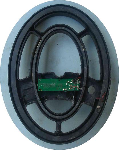

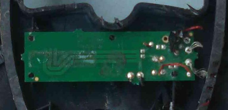

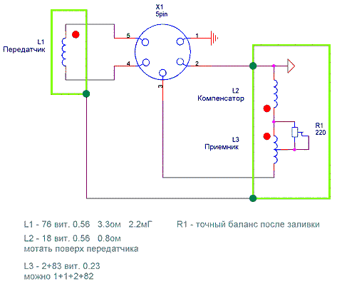

                Ace 250 coil schematic
                I was looking over the schematic forum when I came across a post by kt315 linking to a russian site. The site offered schematics with one of an ACE 250. Unfortunately, the cable was already cut off but the pcb is right there near the middle. Good pics, to bad only one side of pcb is shown.
                  interesting use of 220 ohm vari pot to null the bucking coil , but then i suppose in manifacture it's quicker to twiddle a pot to null than play with a moveable loop !
                  very interesting in fact , had a thought , a mosfet could be used insted of the resistor , or with the resistor and the coil could be automaticaly nulled remotely either by ecu or via clever feedback so that maximum gain could be used at all times.
