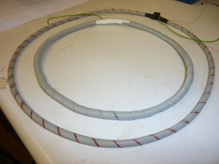

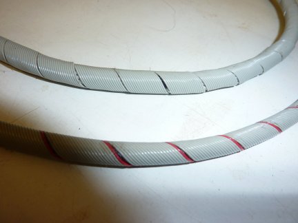

              so , what is the "ideal" resistance per square inch for use on a PI then ??
              so that us people with ocd / the want to be perfectionist people, can aim for , and then feel happy with knowing we have the perfect shield.
              not sure about using ribbon cable as a shield though maikl , allthough i bet it works , not sure if it's ideal . with it being wrapped round will it not develope interferance ??
              kev , the other thing about that diy blackboard paint i remember was that after painting on a non magnetic surface it enabled you to stick on those magnetic markers / fridge magnets etc on to it, so , by my rekoning it had to be a ferrous based conductive paint , which would be no good for any of use on here.
              one thing for sure , anything has got to be better than kitchen foil , tried this , my home brew detector can "see" it , so currently run with no shield ,
