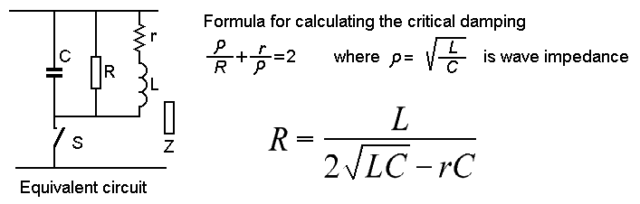

    Msysta,
    The short answer is yes. But, you need to also include in the resistance value all the resistance that is in series with the coil including:
    1. Coil resistance
    2. Any current limiting series resistor in the TX circuit
    3. MOSFET on-resistance
    4. Coil coax lead resistance
    Also note that the flyback voltage amplitude is also governed by the pulse width which is also a factor of the coil's charge time constant. Therefore, critical damping of the coil is based on a particular flyback voltage amplitude range that is being damped by the value of the damping resistor in parallel with the coil.
    Look for a free program called miscEL.zip on the web and use the coil charge and discharge calculator. It has a nice graph output where you can see the effect of changing the pulse width time. Somewhere just after about 1 TC the slope of the current rise will start to rotate from being more vertical at lower fractional TCs to being more horizontal with higher TCs.
    If you want to see the coil discharge TC using miscEL, use the value of the damping resistor as the discharge path.
    Do a search on this forum on "damping resistor" to see more details about this.

      Bbsailor,
      My greatest thanks to your reply. It was very clearly put to understand and with an excellent reference. The MiscEl looks amazingly useful for me! Seems to be a true versatile multi-tool.
      This issue was bothering me because I have an old Surfmaster as a project and I´m learning by planning about what to do with it to make it more powerful -my ultimate goal is however to gain understanding of how that machine works in detail. I am planning to add adjustment for 555 freq, duty cycle length and for damping resistor plus to add pinpointing; actually to take soil balance out of use. Also the original TIP will go.
      I made couple of experimental coils, wanted to test with something that is not normally used and put one together using 1mm solid copper wire. Radius is 40 cm and it is a monotype circular coil. L according to my multimeter is 350mH. Resistance is of course low compared to regular one, 0,5 ohms or so, and it comes back to my original question which is now more clear. As can be predicted by those who know, the coil was not a huge success with the original control box. But now I know better what part to adjust and, which is more important for me, why to.

        Formula for damping resistor
        Simplified equivalent circuit for damping of monocoil at open switch S. To obtain the actual equivalent circuit, must include an impedance Z, which is shown not connected from the side. One part of it, which represents RX Front end, appears to be in parallel to resistor R. The other part of it, which is time (frequency) dependent, represents environment. It is in series of coil resistance r.
