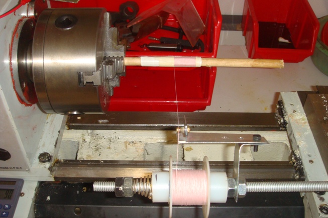

    Here is the way that i wrap coils until 24cm diameter.
    When i wrap solenoid coils, i use it at automatic mode

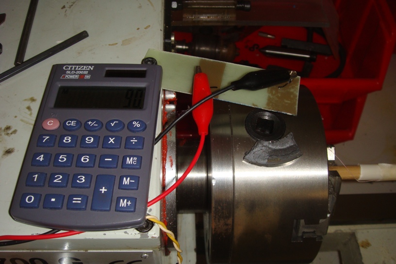

        Here the way that i measure the turns.
        I use a magnet on the rotor and a magnet contact on the arm of the lathe, that drive one simple calculator.
          Very creative Geo. Much better to use calculator as counter than as decorative part of LRL.
            Hahaha... i agree.
            Of course it is and very easy than to construct a digital counter!!!
