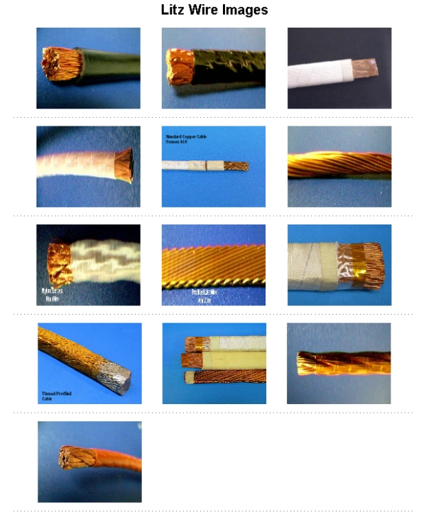

                          Litz Wire
                          Litz Wire Manufacturer and Information
                          LITZ-WIRE.com (see Litz Wire Images below):
                          http://www.litz-wire.com/
                          I have made a PDF-File of there Technical Information added as Attachment, which can also be found here on there WebSite in HTML-Format:
                          Litz Wire Technical Information:
                          http://www.litz-wire.com/technical.html
                          Interesting however, is a Table that shows the recommended Frequency VS. Wire Gauges. It seemingly looks like they recommend far thinner Wire Strands than you would expect from the depth of Skineffect Penetration for a given Frequency range for a Single Wire Strand.

                              Yes from some of my old radio days,Litz wire was Square for max surface area coverage in multistrand an cotton covered. very nice to see these pics. Now some of the later day detractors to what litz wires mean physical can see!the range of difference,all under the term Litz wires an know.
                              Coil winding an development may have taken a bit of a retarded trend to what it once was,with such a narrow focus on just the generic wires we use today an poor use of science an understanding.Wish you all well anyway with your various coil developments.
