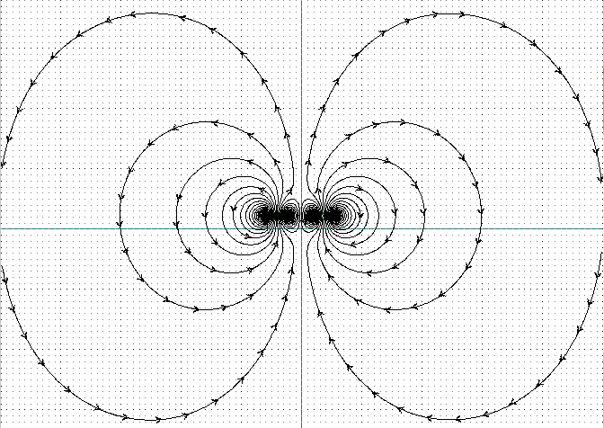

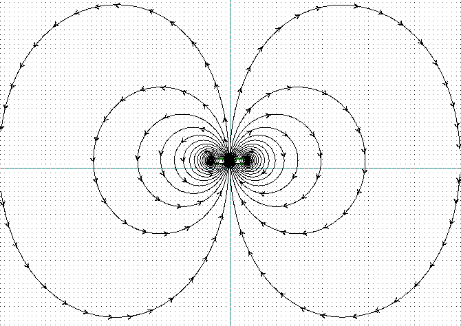

                            • #74
                              OK, maybe I'm missing the point here, take a look at the two analyses of my interpretation of a DF coil, I don't see ANY benefit over a single field, although in theory DF SOUNDS like it would be a good idea.
                              Maybe my analysis is wrong but from what I see as an output, DF is just a marketing gimmick and I do NOT expect this from Whites as I thought they were above that sort of thing.
                              Can't say I was impressed with the TDI though. Spectra V3..now THAT'S a WHOLE different ball game.. VERY nice!!
                                Probably you are one more impressed by user interface.
                                Did you done comparative tests between mono and dual field coils or you only theoretize here?
