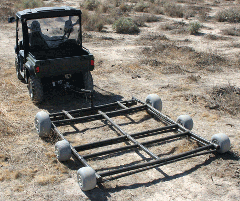

square coil 1mx1m for sniffer xr71p
  • square coil 1mx1m for sniffer xr71p

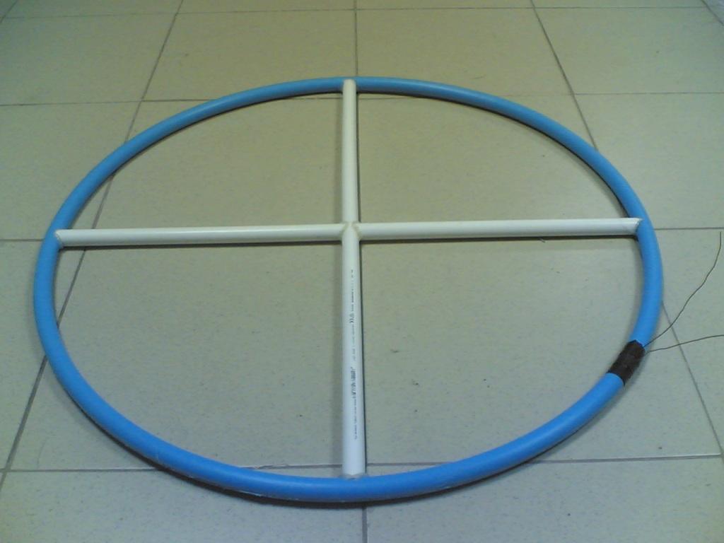

    Hello everyone
    I just buy on ebay a sniffer xr71p kit
    I wish I construct a framework of 1mx1m
    the board manufacturer wire 1.5mm2 16 turns
    AC seems to me much 16x1.5mm2 ????????
    there does it have another way to achieve
    If yes, with her son that
    if you want pictures or information
    write me
    I thank you in advance for your answers
    cordially

        Hi.
        For 1x1m coil you need 16 to 17 turns.
        It is good to use wire with diameter at least 1mm. You must use a resistor in series with the coil if the total resistance is lower that 3 ohm.

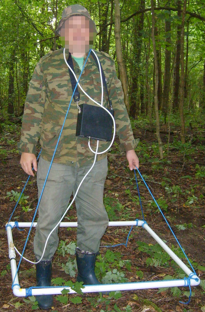

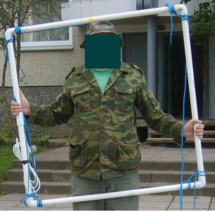

              for you re pictures
              best regards
                Hi KT...
                Good photos but... Why you hide your face?
                  large square coil
                  This large square coil hanging around your neck. Does it not detect that box with the metal clips etc.
