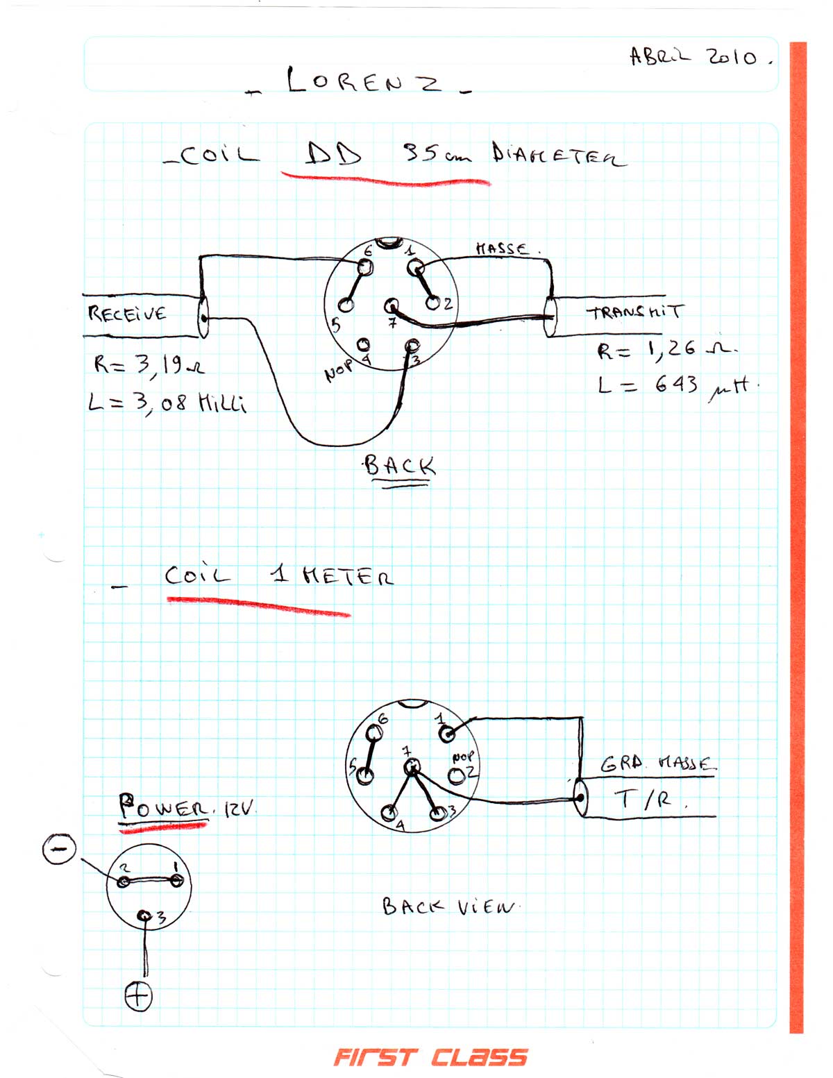

    I need the coil connector wiring for a small (26cm, 35cm or 45cm) MONO coil (for DD will be good too) for Lorenz. It is different from the connector wiring for large coils - e.g. 1m x 1m coil, which I already have. So if you have one of those coils, I just need you to disassemble the connector, take a photo of how the wires of the coil cable are soldered to the connector pins and send it to my e-mail address (p.m. me for details). In return, I will send you $25 via PayPal. You must have a PayPal account.

      As the supplement. For the monoloop diam. 450mm.
      Pin1 is connected with pin2, pin5 with pin6, pin3 with pin7. Concentric cable - "masse" is attached to pin1+pin2 and "hot" is attached to pin3+pin7.

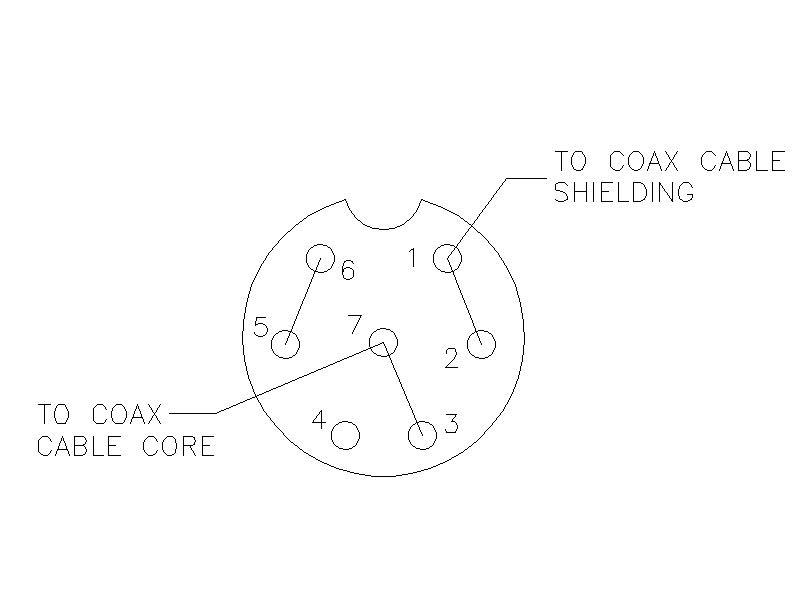

        Thanks Alexis and Mrand. I am just back from field testing my Lorenz and am pretty happy with the results. It will probably become my main coin machine now. Nothing too spectacular, but for coins it gets depths that none of my other detectors can reach. I don't have an oscilloscope to measure the frequency, but I suppose it was working correctly - at 1300 pulses per second as opposed to 700 pulses per second (as when the coil was connected in the same way as a 1m x 1m coil). The detector was producing higher pitched tones and it was "faster". The increase in sensitivity to coins was obvious as well.
        I started with the diagram that Alexis provided for a DD coil and assumed that for a Mono coil it will be like this - see my diagram below. This is eactly as Mrand says. I was using my 12" Dual Field coil from my White's TDI (330uH, 3 Ohms or so), but only the outer of the two coils of the Dual Field. I connected it to pins 1 and 7 of the Lorenz connector with a special adapter which I made. The inner coil of the Dual Field is not used and being a metal object it reduces the sensitivity of the coil, I suppose. I will probably get more depth with a simple mono coil. But it still was very good.

          According to my measurement, the 450mm monoloop has: L=356uH, R=1.4ohm, selfresonace is 410kHz.
