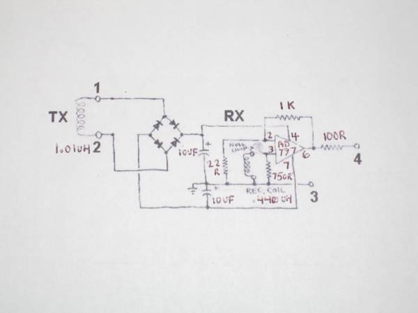

    I am looking for the schematic for the AD797 coil amplifier in the sovereign. One that has all the components identified, I can only seem to find the LT1028.
    It is my understanding that the AD797 is an updated version and a bit better?
    I constructed the "Sovereign" amplifier with both ICs. Practical no difference.
      Here is the AD797 circuit
        Awesome, thanks for the replies!!!
          Can someone tell me the voltage created by the transmit wires (1 and 2) for powering the AD797?
            I can tell the preamp is a drawing I posted about 8 yrs ago with the LT1028. Someone just changed the values.
            I guess it depends on which Sovereign. The original model used a 12v battery pack. Since it is a non resonant type coil more like a pulse transformer with rectangular waveforms applied, the total voltage across the transmit coil is 24V. The H bridge FETS switch 12V across the coil on one half of the cycle then 12V in the opposite polarity on the other half of the cycle.
            There are a lot of new choices out there when it comes to low noise opamps for the preamp.

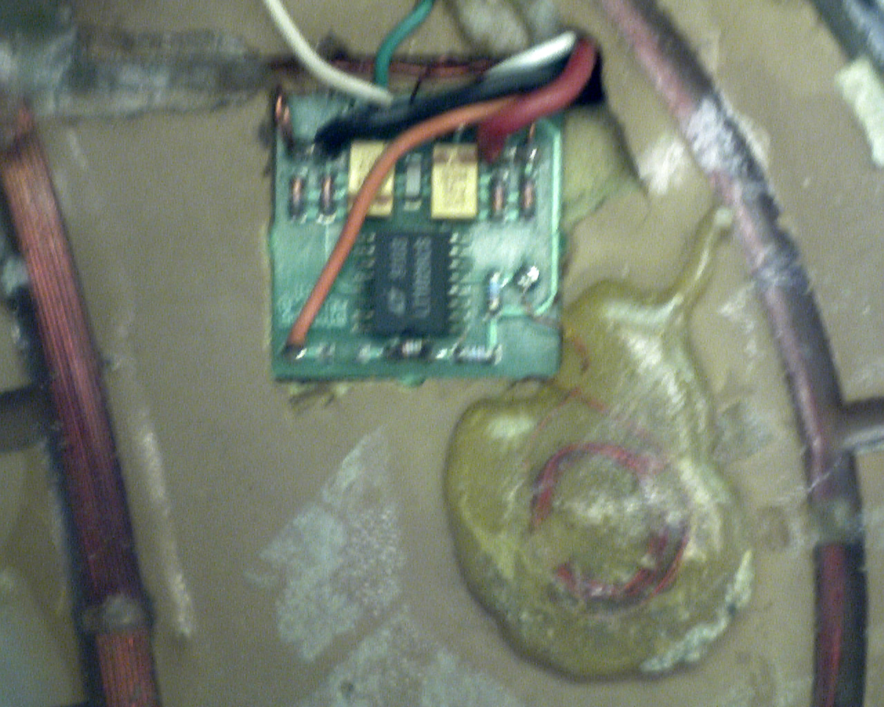

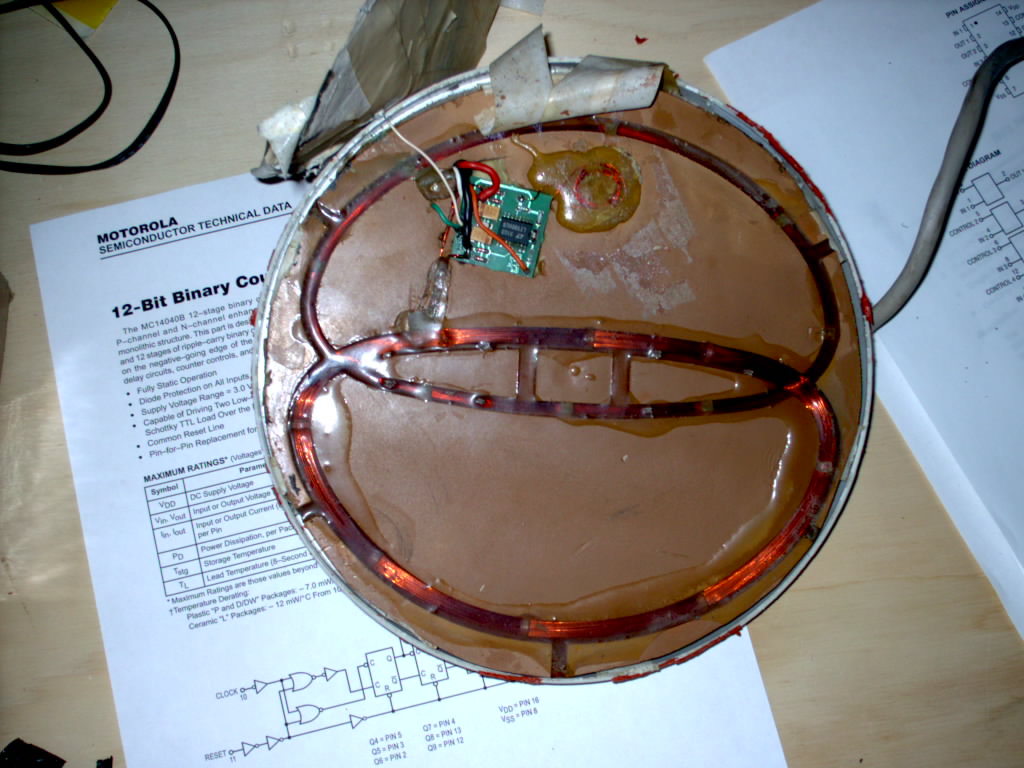

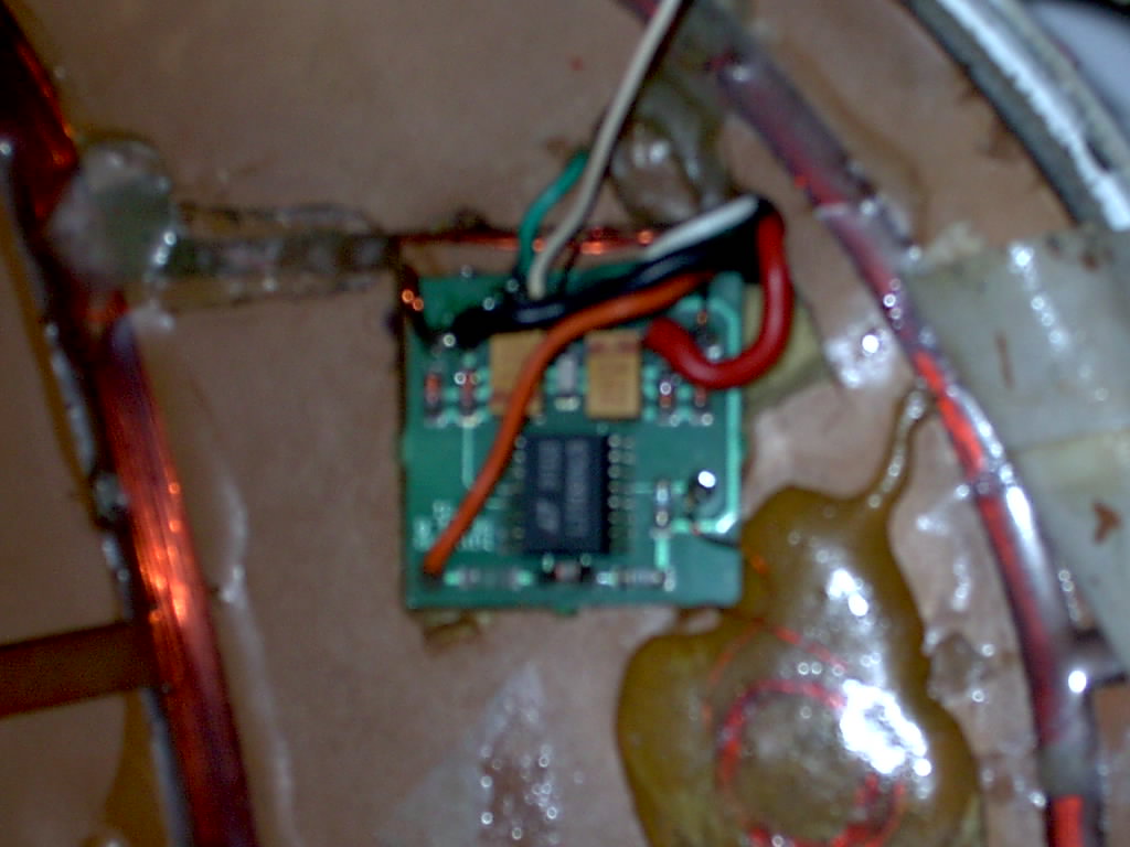

                    A picture of the LT1028 BD. I guess they changed over to a 50 cent amp with a discrete low noise front end on the latter version. Probably works just as good or better. I am experimenting with a OPA1611.
                      David, please do your photos on sunny day time. wait this time and do. I ask all people NOT DO SAME VERY BLUR PHOTOS LIKE THIS ONE DAVID SHARED.
                          DavidB,
                          I have already used the OPA1611 as a replacement in the AD797 circuit above with great success. Use the AD797 values not the LT1028. Give it a try.
                          Bob
                            Those 2 are pictures of my coil that I posted some time ago. You can tell by the shape of the glue blob and those are my data sheets. The last one I posted was from a cheap microscope camera and I was holding it. I had forgotten all about the original post. I also posted some partial Sovereign schematics back then.
