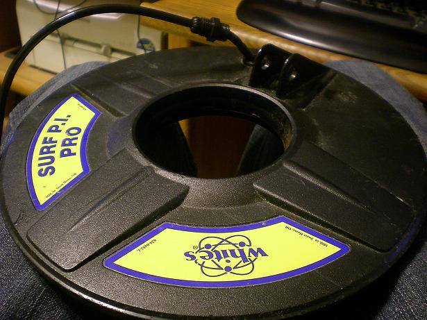

    I discovered the PI Pro I am restoring from saltwater damage has a bad coax cable, starting at the box and leading down I don't know how far yet. Water got in at the waterproof feedthrough due to flexing I guess. The copper coax shield is seriously corroded to the point it is open circuit. Is there a watertight inline connector you would recommend or is it time to make this a "water resistant" machine and just replace the coax using a heatshrink coated splice? Or I suppose I could just put a coax connector on the box as well... (who sells a (salt)watertight one?)

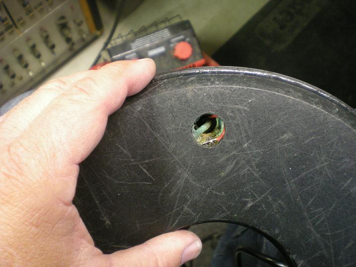

        Awww crap. That still did not work. I was fooled into believing the connection to the coil was good. Today I thought I'd spend some time teaking trimpots and discovered the coax remains open. So I unscrewed the plastic connection at the coil and a bunch of water came out. I would think this means the whole insides are compromised(?). What next at this point? I'm thinking the housing is seriously glued together, right? Should I try drilling an access hole on the bottom side to see/fix the coax connection? I could always later glue a scuff cover over the bottom...
          I decided to go ahead and drill a hole. I found two wires hanging in the air - one was the coil, the other the shield I'm thinking. The center coax wire was still a good connection.

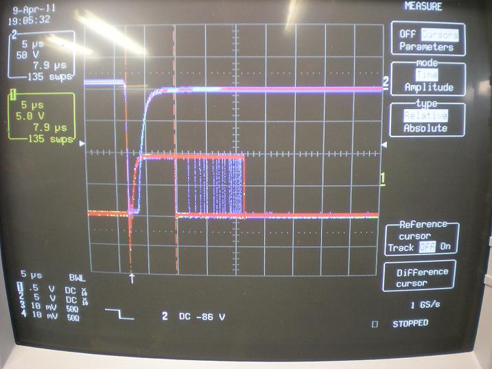

          I put it all together and now it works - sort of. I'm thinking it should work better than it does. A quarter or a gold ring has about 5-7 inch detect range in air. I think my Surfmaster PI_950 detects better. The PI Pro has a bit different circuit than the 950 (has a gain and tuner control and the PI_950 has a Pulse Delay and Tuner knobs). Anyway, I've attached a scope photo showing the coil signal (190V peak) and the 4093-pin 10 - showing the adjustment range of the timing trimpot. Does this look right? (8-20uS after TX release)
            I'm guessing my issue now is the water contamination of the coil housing interior. But how do I confirm that instrumentally? How do I prove by instrumentation my coil is faulty? Would it be a resonant frequency test? The flyback voltage of 190V seems quite a bit higher than the 130V I get on the PI_950 coil. Is that just due to the mosfet used or is the coil that different? (I'll find out fairly soon as I plan to try it) The inductance is 233uH and resistance .9 ohms (seems a bit low..).

              Just do a Ohm test on it.
              Shorted?
              That high of a Flyback would tell me No.
