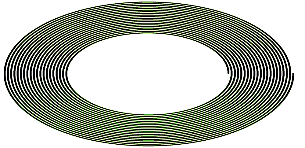

              result: see png
              Nice idea ApBerg, thanks.
              Probably Aziz can do this (ellipse) without resizing line thickness?
                Please note that copper lines are not the same width here. As the spiral is squashed into oval, so are the copper traces
                  Hi guys,
                  yes, I can make elliptical & rectangular coils as well.
                  Just specify it exactly!!! Otherwise, I'll respond with "Syntax (T)Error!"
                  Aziz

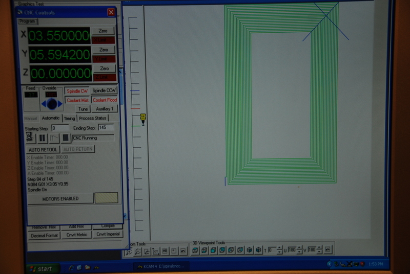

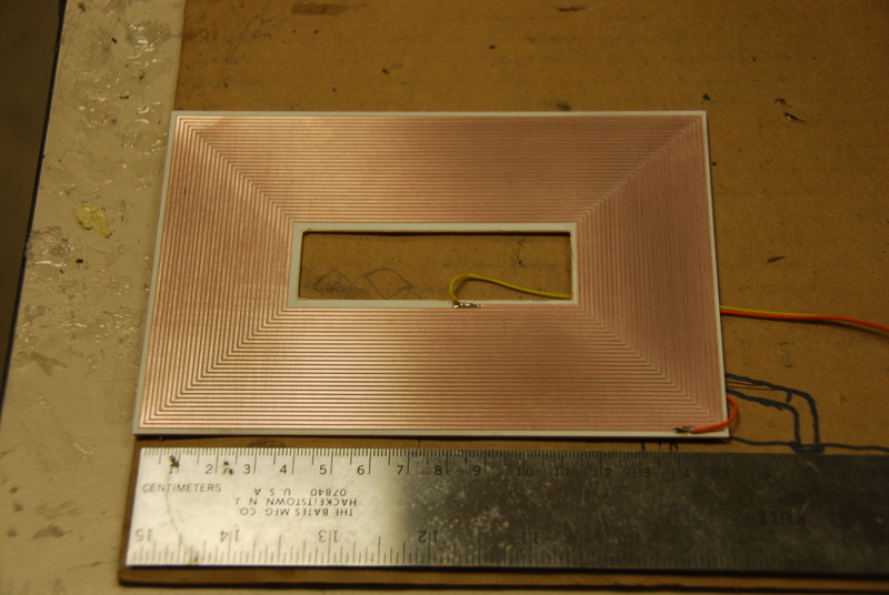

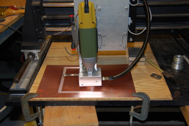

                          I was making some pcb's on my cnc router today. So I decided
                          to try a quick pcb coil.
                          It is 4" x 6" has 30 turns and the traces are about 7mils
                          Results in 122uH @ 7.6ohm
                          It appears this is more suited to larger coils which require less turns for usable inductances. Or stack boards to get more inductance. It would be neat to do OO coil with an overlapping windings one on top, one on bottom.
                          Does anyone know how to do spirals diptrace?
                          Here's some photos

                              Yes,
                              The resistance is quite low because it is 2oz copper instead of the standard 1 Oz.
                              The manufacturer can do anything I specify, resistance can be lower still.
                              The shielding doesn't support eddy currents, only within the width of each finger.. can make the fingers smaller if necessary.
                              Yes, the capacitance measurement to shield is wrong (just done with a multi meter).
                              I think at this stage, Coils wound with wire are cheaper and better.
                              Because shielding can be above and below (Wrapped around)
                              The coil needs to be as rigid possible
                              and there needs to be a spacer between the coil and outside world to stop things getting too close.
                              I have made another coil with a rubber hose as a former, I will try it out and let you know.

                                CNC
                                Altra,
                                That CNC router is awesome,
                                I wish I had one.
                                I use Diptrace by the way, I didn't know how to use spirals so I did the circles.
