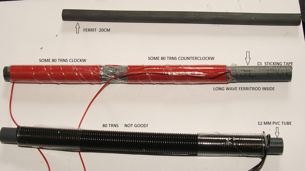

A photo from the coils I made this morning, the red coil works good, more than 15 cm for one euro at the side's ( euro..
) ...can be more ... this is the first proto!
