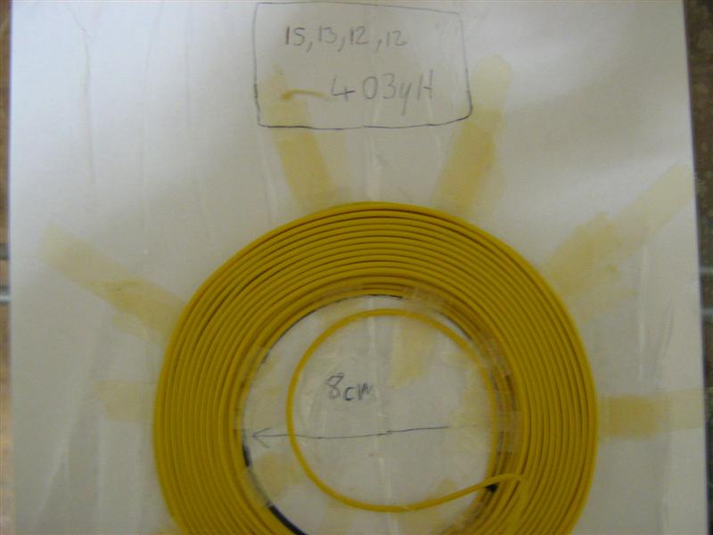

          I have attached a picture of my exactly 400uH (403uH) 'park-master' coil, I intend pinpoint $2 coins amongst thousands of pulltabs and bottle tops...so it is small, specifically for parks..

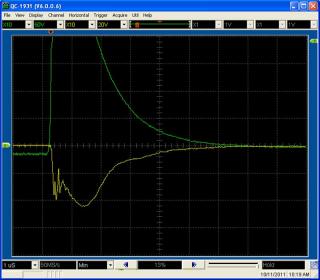

          Instead of going fishing today, I set up some tests (see graph)
          The bottom axis is pulse width/10 (eg 25 = 250uSec)
          The y axis is a magic ratio I was measuring.
          The DASHED lines are magnetic (fe) targets.
          The SOLID lines are not.
          What I think is interesting is the nice parallel-ness of the solid lines
          Light green = copper coin
          Dark blue = 20c
          Light blue = old-style pull tab
          Dark green = 5c
          And look at the bobby-pin (dashed red), bouncing all over the place with different pulse widths I am guessing because it is a complex shape.
          The yellow dashed line is a bottle cap, it looks the same as a non-fe target...
          But all the others, sag away from the ideal shape mapped out by the non-fe targets..
          They are more complex...

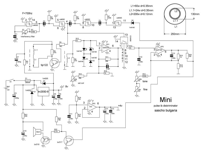

                                Frankly, i didn't have success whit this. Inserting toroid (basically current transformer) in series whit coil means measuring current thru it, not voltage across it. Changes whit different materials can be observed, but due to coil parameter change (increasing L whit Fe and decreasing whit non-Fe), whit large targets very close, not due to eddy currents, resulting in low sensitivity. As far as i know, no one use this, but maybe something can be done...
                                And two more words of caution. First, machine like one posted in #25 is not PI, it is induction balance, and you can use any waveform, including PI one for IB (ML does, so what?) Still, all issues whit ferrite and ground balance remains, and must be sorted out some way. (Not going into discussion what is PI, IB, hybrid or whatever, any cat catching mouse is fine, just terminology)
                                Another is coil behavior, why #25 is not built using DD coil. Well known and probably many times discussed here, coil phasing. Due to it's construction, DD coil exhibits specific response, observing Rx side, signal polarity will change whit object orientation, going in one direction if, say, coin is vertical, and in another if it horizontal to coil plane. This is unimportant in VLF like Tesoro, Fisher etc. typical "two channel second derivative "designs. Simply, both channels will go in same direction, no matter which one, and only difference is measured.OO coils work differently, giving unambiguous response for Fe or colored in definitive direction. This may be important, depending of how signal is later processed. Best way is to build the coil, balance it, (some terminating resistor is needed on RX side too) and observe on scope responses for different targets. This will give you best idea what next step should be.
