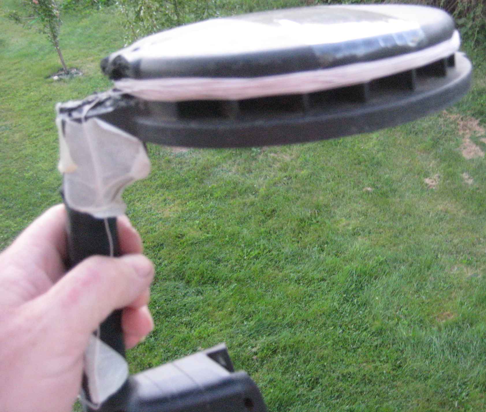

  • Thanks, I just checked the self shielding on it and like all the others I can grasp the coil without the detector seeing it with the sample delay set @ 8us.

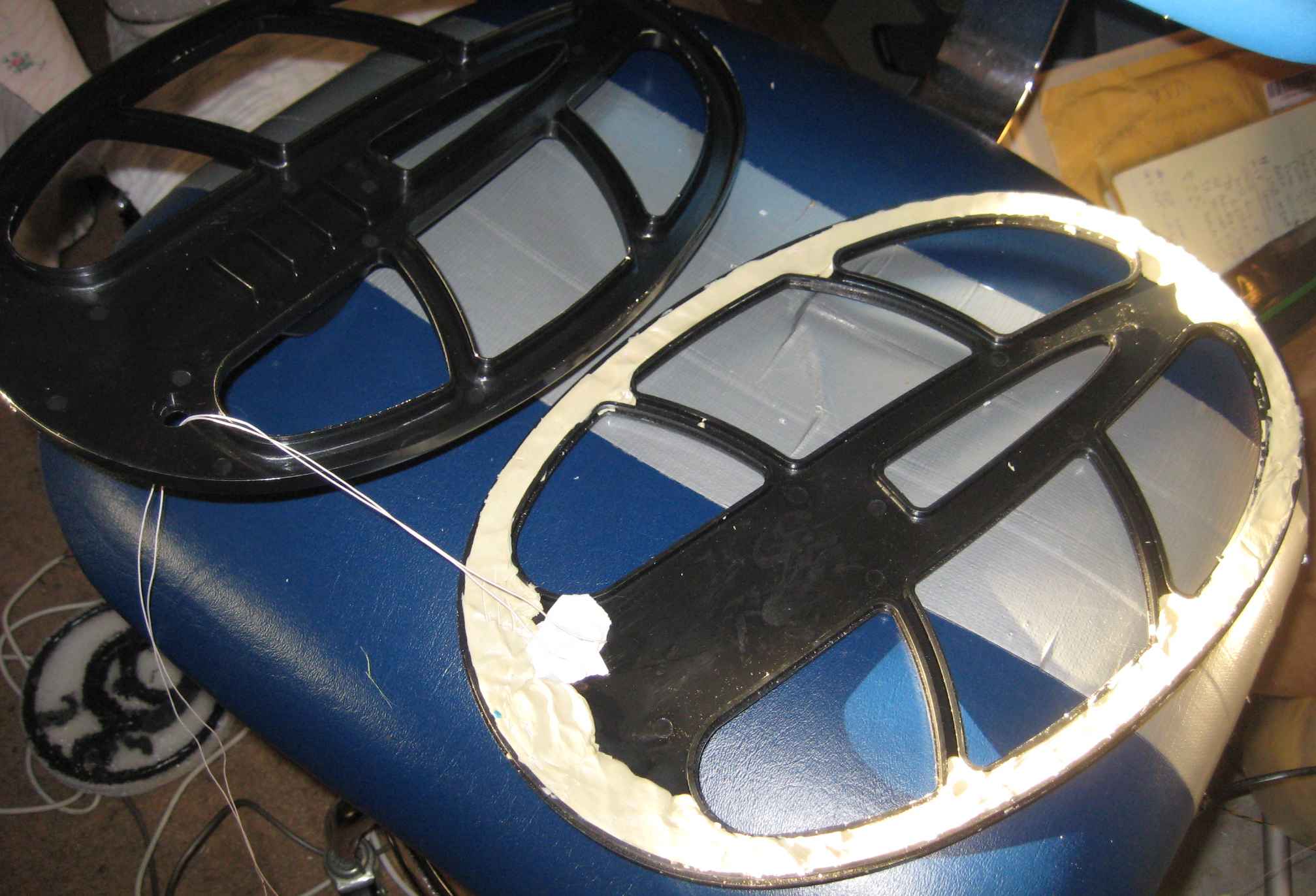

        Built this coil using no machine tools to show that it is easily done following the procedure of Post #126 of this thread, and to get a larger 3:1 prototype for my tests in the ''Elliptical Coil Question' thread.
        Forgot to mention that reversing the leads from the coil at the detector, i.e. putting system ground on the innermost windings, the detector immediately sees my hand.

          • Originally posted by baum7154 View Post
            I have built a 4" X 12.5" oval coil with 8.5" parallel sides in accordance with Eric's 3:1 profile recommendation. This coil is a fast spider coil using the instructions I posted in post #126 using only simple tools. The construction pictures are posted below. I will post test results for this self shielding coil in the next few days.[ATTACH]31039[/ATTACH][ATTACH]31035[/ATTACH][ATTACH]31036[/ATTACH][ATTACH]31038[/ATTACH]
            Are the dimensions the mean, inside holes or outside holes? If I calculate correctly the circumference is the same as a 9.4 inch round. Larger than your 8 inch round. Are you happy with the size? Would you try something different? Thinking about making one.
                Actually the 4 X 12.5 size is measured at the midpoint between the windings edges and is visible on the pattern I used in the photos. It is the center point of the coil form and it is the point of greatest winding density. It seemed that the winding centers were the best way to define this. I actually calculated the included area of this coil to be equivalent to a 7.7" diameter round coil. I very much like the sharp 'blade' search field of this coil which is about 8" long and appears pretty consistent through it's length. It should allow much faster coverage of an area than the cone shaped field of the round coils. I also like the pinpointing ability of the rounded ends. The physical size gets into smaller spaces than the round configuration. All this said, I still need to revert to the 530kHz filters in my detector to regain the very small gold detection before I can truly judge performance of this coil.
                I'll post results as soon as I have them.
                Dan
                        Yes, this is the coil with some self shielding. My 334uh 8" coil in the pictures posted earlier does not see my hand fully encircling the coil with the detector set at 8us sample delay and 'wide open' in all other settings.
                        Your hand acts as a capacitor plate. Since the coil's capacitance is already low your hand won't add enough to get the coil into the unstable region. Coils with larger capacitance will be affected by your hand. It's not "shielding", it's just low capacitance.
                        • Originally posted by Teleno View Post
                          If what you say is true then why does it detect my hand when the system ground is put on the end connected to the innermost windings?
                          Dan
