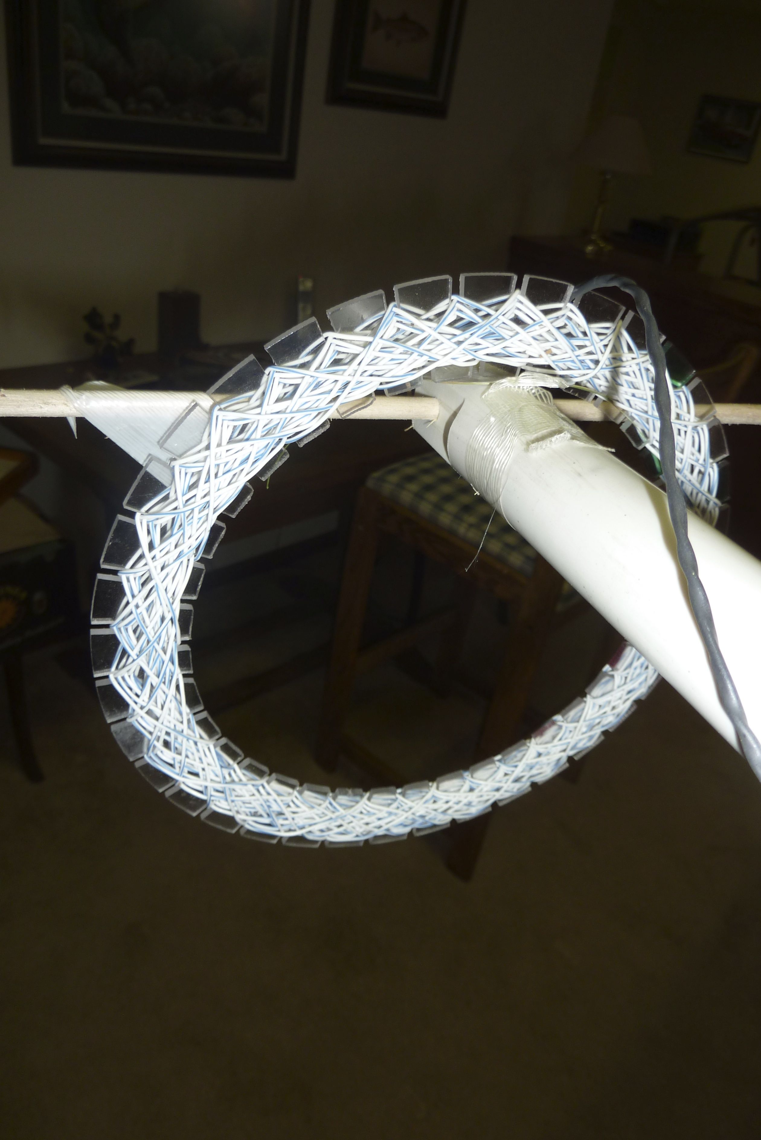

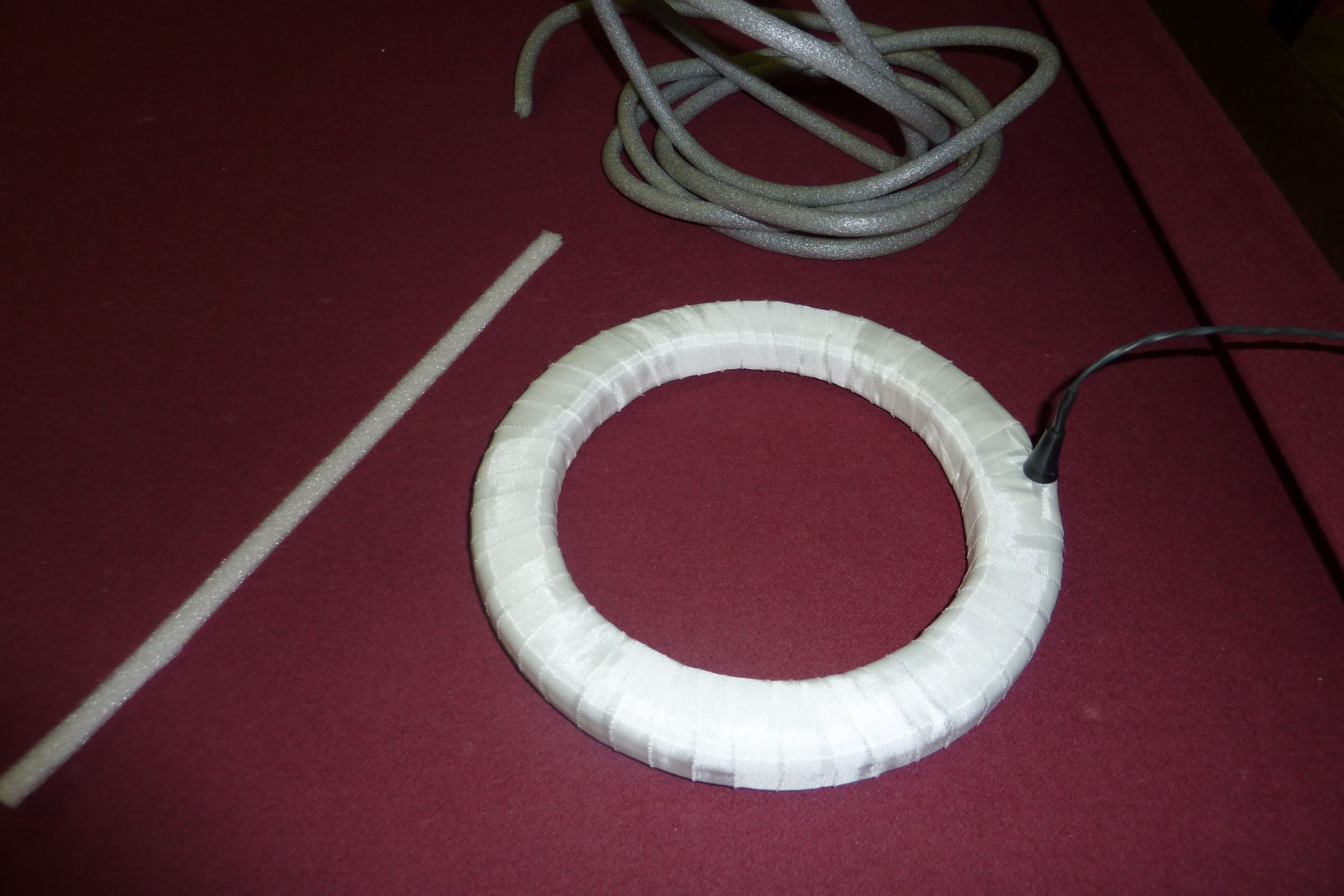

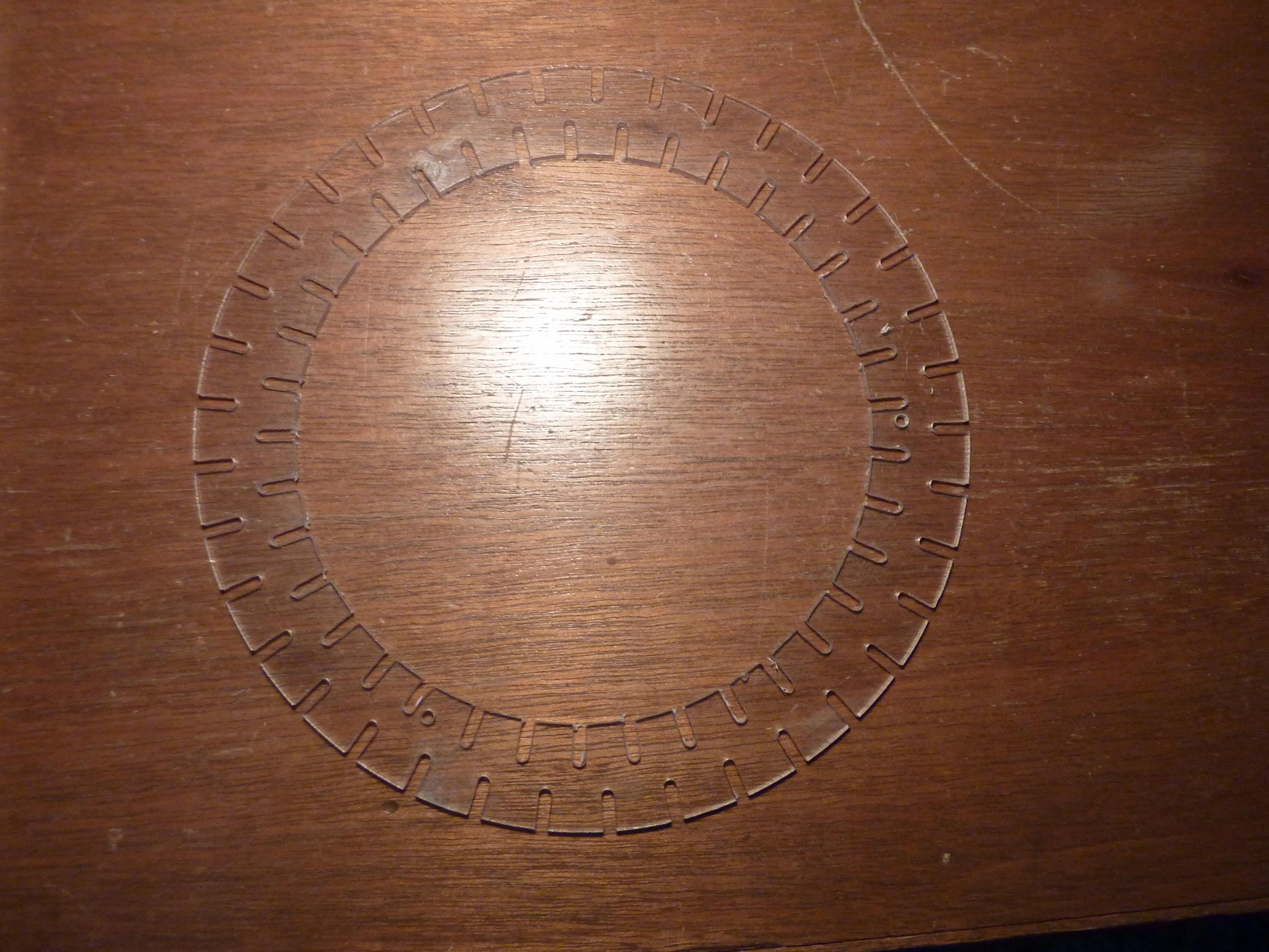

              A wider and modified version of this coil is what I am using on my Chance detector. I used 32 turns of 26 AWG silver plated, stranded 600 volt teflon insulated wire on a 1.050 wide, .093" thick 8" OD. Lexan form with the slots machined .400" deep from each inner and outer edge. The feed line is a continuation of the coil wire 33" long and twisted at a rate of 3 twists per inch. This results in a 335 uh coil.

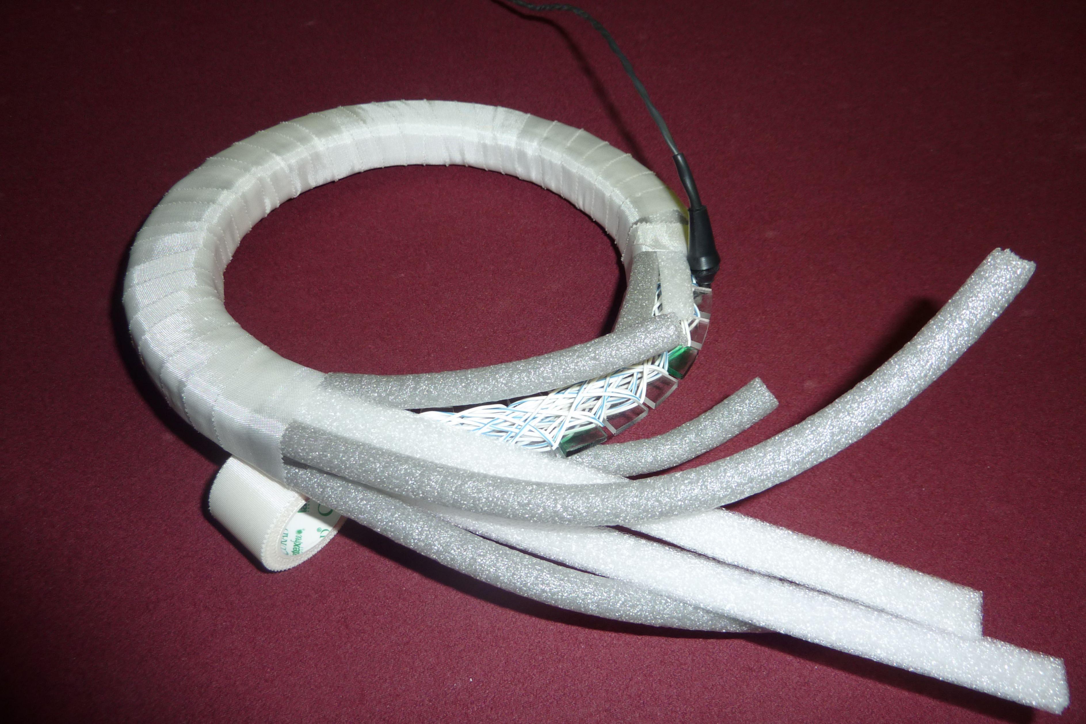

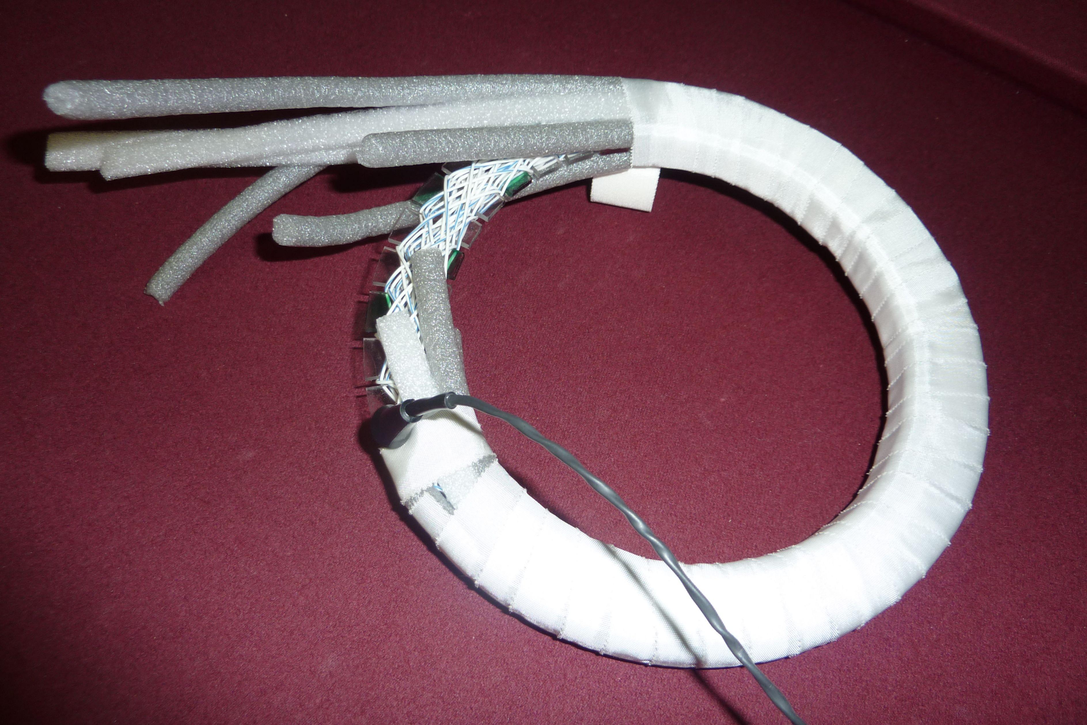

              The system ground is connected to the wire end of outer winding and this results in what I believe is a degree of self shielding due to the geometry of this coil construction. I used 4 each lengths of 3/8" urethane foam 'Backer Rod' and 1/4" thick x 1/2" wide strips of urethane packing foam to fill out the cross sectional profile of the coil. The Backer Rod and foam strips were over wrapped with Curity self adhesive cloth hospital tape, using a 50% tape overlap on the inner part of the form. Consistent tape wrap pressure was used to avoid crushing the profile. Then at least 2 layers of fiberglass mat and resin were applied and a Lexan cross support with Lexan mounting ears were glassed in across the lower third of the assembly.
              Initial critical damping of this coil performed with the coil suspended on the boom in the air required 1040 ohms in order to get the unit to operate down to a Guard Interval setting of '10'. While detecting a 1/2" SQUARE aluminum target on the ground I noticed that a damping resistance of 980 ohms gave the best signal strength. However the unit would not operate in open air at a '10' GI setting with that resistance value, it was just on the threashold of operation. I re-ran the damping adjustment in air last night and ended up with 1110 ohms and good overall sensitivity while achieving good idle state quietness of the detector i.e. just a few occasional beeps. Will test with the foil target on soil this evening to see what the impact to signal strength has been.
              All of this leads up to my perception that bringing the earth/capacitance into the picture appears to lower the self resonant frequency of the coil and results in reducing the optimum value of the damping resistance. Has anyone addressed this issue in a different process for determining critical damping resistance? Otherwise I believe that setting resistance in open air does result in some over-damping of the coil when it is in use close to the earth. I do recognize that 'Earth' effect on a coil is highly variable so maybe damping in open air is the best we can do.
                              Dan

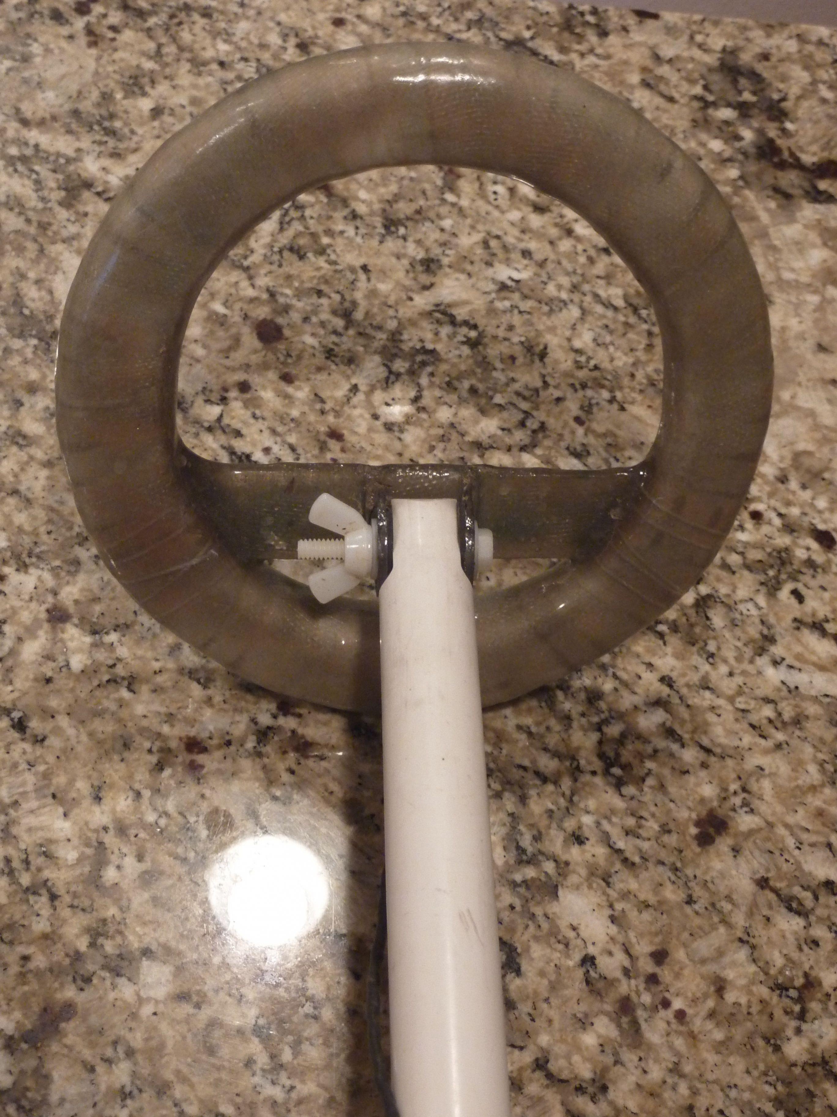

                              Pictures attached here with the description above should give a pretty good idea of this coil construction sequence. Unfortunately I do not have pix of the fiberglassing of the coil and the glassing in of the support member but the finished coil pix should give the general idea. The cross member is constructed of the same polycarbonate as the coil form in the first picture. I misspoke about the foam type in the description aboveā€¦it is polyethylene foam and backer rod. The polycarbonate mounting ears were heat formed on a wooden profile. The polycarbonate was heated to 375 F and bent around the wooden form and allowed to cool in the shape of the ears.

                              More photos of this CHANCE PI build will be posted this weekend in the TECH FORUM under the title of CHANCE PI BUILD.
