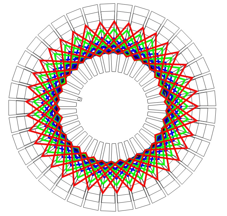

    • I was thinking on building one of these coils, but i still dont quite understand the winding procedure, do i pick any hole to start, preferably by the exit on coil shell, and then how many spaces in between top and bottom or inside row,so lets say, start on inside,then go 3 spaces to outside,then 3 to inside, ect, or alternate to get a good even pattern.
      • Hiya Matt. I hope this little 3DSS Tutorial I've done is of use to you and hope you can follow it easily enough. I'll make a short video how to wind one when I can find some time away from the many chores I have at the moment. Good luck building! Let me know how you go. Regards, Marty.

                    I have wound several of what Baum called 3DSS coils, none have come out with the inductance looked for [300uH +]. I have been getting 190 to, my best so far, 240uH, this for 210 to 225mm mid point dia coils. At first I thought it might be the gap between the apex of the slots in the outer and inner dia being too distant, affecting flux ddensity, or something. The differing circumference does cause a thinning of the wind on the outer compared to the more bunched windings on the inner. I made a couple more formers in 2mm acrylic [a nightmare to machine, superglue is handy] but still only reached 240uH for 5 and a half layers [ran out of wire].

                    I counted the strands on the wire I was using, 6 strands. On your helpful diagram above yours was 16 strands.
                    Could this be the solution to achieving a good inductance value, my lousy 6 strands needs to be 16? Is my teflon stranded little better than solid wire?

                    • Hiya SkyeHi. When I first started out making 3DSS Coils I tried different wires from 7 stranded down to single strand ordinary copper enamelled wire. I always achieved 300uh or slightly higher:- if the inductance was lower or higher I would either remove some wraps or add some. One hing I think I've noticed is the 3DSS Tutorial I uploaded. I just quickly looked at it again and there's a slight mistake I've made in writing it. I meant to write that each layer consists of 5 revolutions of wrapping to complete one layer and there should be 6 layers in total to achieve 300uh or very near. Sorry about that! If your slightly under 300uh, and 300uh is what you want, then add a little more wire. By the time you've wrapped 2 layers of medical tape it should be around 300uh. Hope this helps. 6-7starnd wire will work ok but 600v 16 strand will ive a lot better results,,,,or even 400v wire. Regards, Marty.
