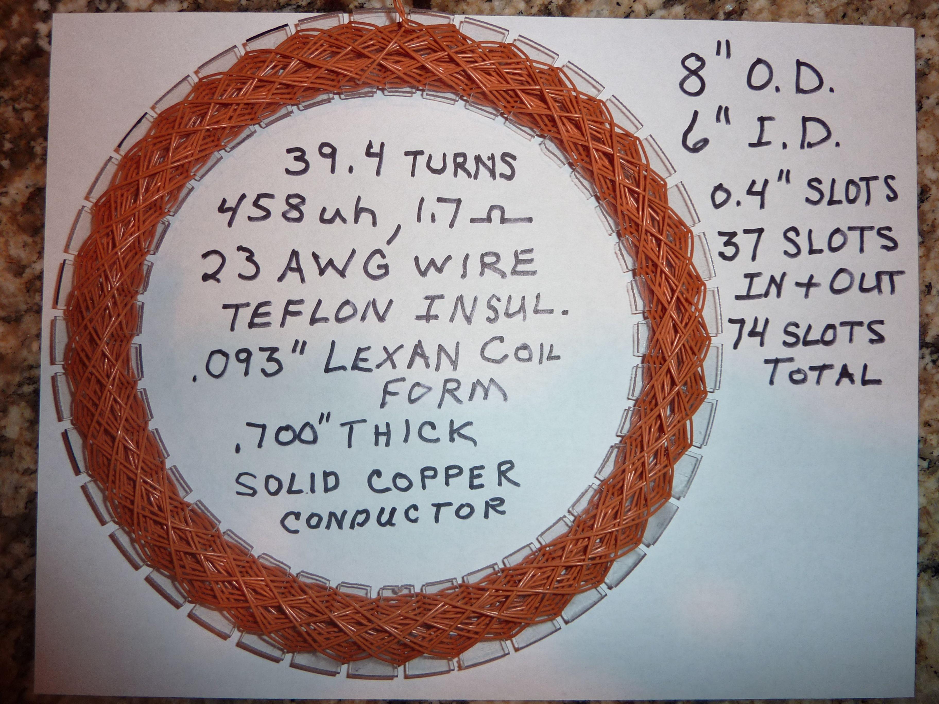

    More pictures, this time of an experimental Teflon insulated 23 AWG solid wire wound spider coil form, and a different graphite shielded coil wound with 26AWG solid enameled wire. The teflon insulated 23AWG solid wire came from a plenum rated Cat6 cable. The graphite shielding was a mixture of varnish and powdered graphite and was applied at a rate of 1300 to 1500 ohms/inch. All coils are 8" diameter. The shielded coil was fiberglassed with two layers of woven fiberglass mat and a lexan cross support and mounting ears were 'glassed in' just like the coil in the prior posting.
    Theses polycarbonate coil forms were machined on a milling machine using a rotary index table and a 1/8" cutter. Using a cutter with a larger diameter than the thickness of the material causes less bending stress on the wire/insulation because the wire is bent less than 45 degrees as it is passed through the radial slots and also minimizes parallelism of alternate wires within a slot resulting in less capacitance. This process is preferable to just slotting the form material with a hacksaw. That said,hacksaw slots can be hand filed to depth using a 1/8" fine round file to achieve similar results.

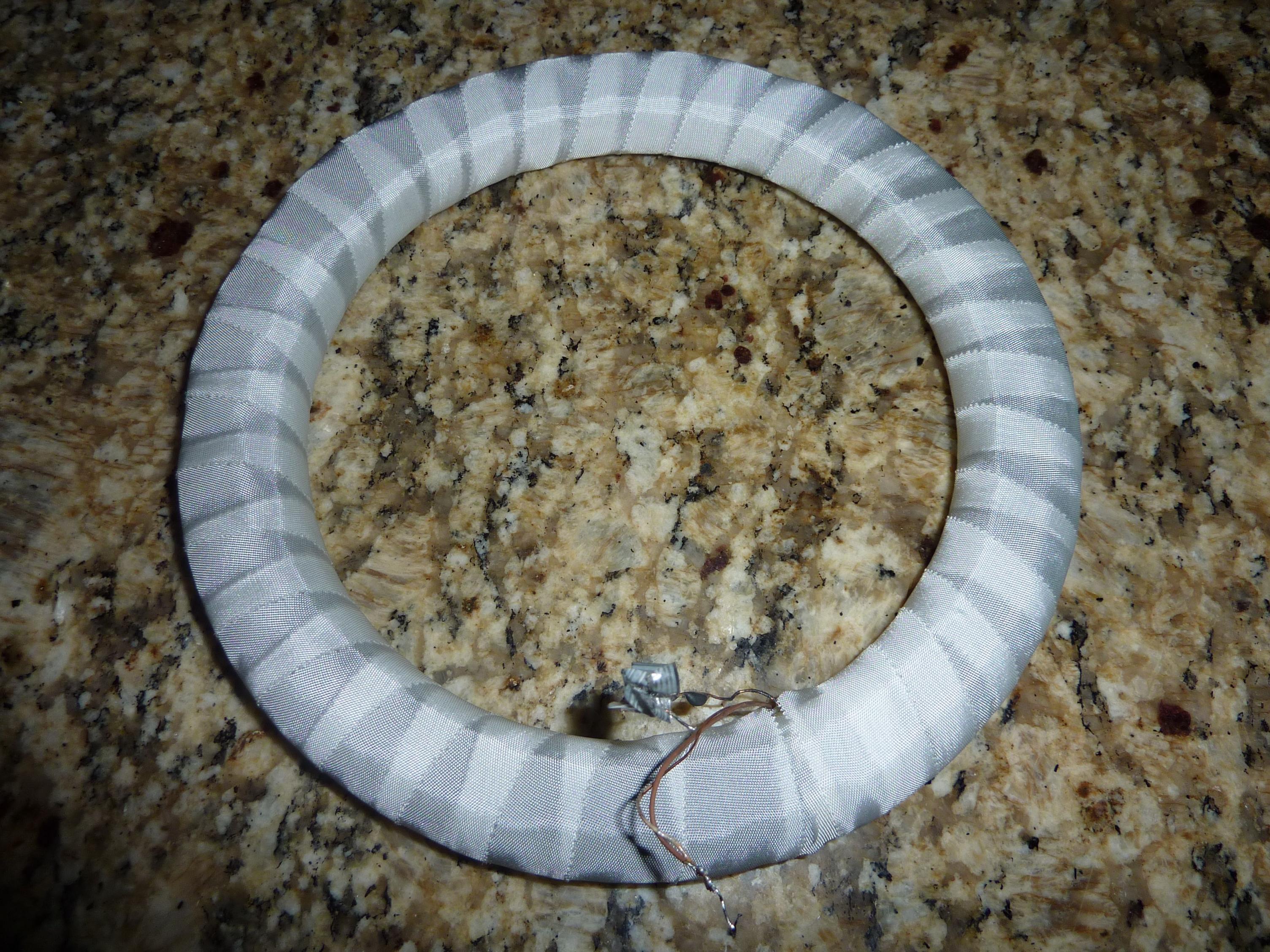

            Yes you have the gist of what I have done! However there are a few more nuances to the coil.
            1. Eliminate the coax by using a continuation of the coil wire to make a twisted pair feed line. This eliminates a lot of capacitance and there is no lead or tin from solder in the field of the coil.
            2. Use the smallest stranded gauge wire with at least 600 volt (thick) PTFE AKA Teflon insulation to minimize capacitance. This coil was wound with 26AWG silver plated 600 volt teflon insulated wire. I am looking for some 28 AWG 600 volt teflon wire now. The earlier coil wound with 23 AWG solid conductor with thinner Teflon wire had much more capacitance. I know that the silver plating is a no-no due to eddy currents but as the wire gauge gets smaller it gets diminished.
            3. Do not flood the coil with any insulating resin. I used rod and sheet polyethylene foam to fill out the profile as in the pictures posted. Then 2 layers minimum of fiberglass woven mat and resin for armor to protect the coil.
            4. I did not do a shield on this coil, just tied the wire lead from outermost windings to ground. Done this way I believe the geometry of this coil does provide a degree of self shielding but it may not be enough in some situations. No problem! The additional shield, if needed, can be applied directly to the fiberglass shell in the form of a painted on mixture of graphite and varnish with a protective layer of fiberglass over that and a connection back to the ground end of the feed should do the trick. I would make the shield coating measure in the range of 2k at one inch separation of the probes. By the way, I have seen comments on testing a shield by putting your hand on the coil and monitoring to see if the detector reacts to your hand (no rings or jewelry). This detector with the self-shielded coil does not react to this hand test which indicates an adequate amount of shielding if I understand the test.
            5. For the CHANCE PI detector you do not have to use the prescribed 400uh coil and in fact, if you seek small gold, a fast/low capacitance coil in the range of 300uh to 350uh with an optimized damping resistor is the way to go. The coil in the photos posted is 334uh and about 2.0 ohms with an 1150ohm damping resistor. Feed line is 33 inches long…shorter is better.
            6. Coil slots in the coil form must be wider than the form material is thick. This will insure that the wires cross in the slots at about the optimum 90 degrees to each other minimizing capacitance. Slots made as narrow saw slits will put the wires parallel to each other as they pass through increasing capacitance.
            This mono-coil recipe should work for just about any PI detector designed for finding small gold…not just CHANCE PI. The coil I use was derived by making a 40 turn/486uh coil and making measurements, removing 1 turn at a time, while testing sensitivity to small gold targets using the CHANCE PI detector. In this case 32 turns was best.

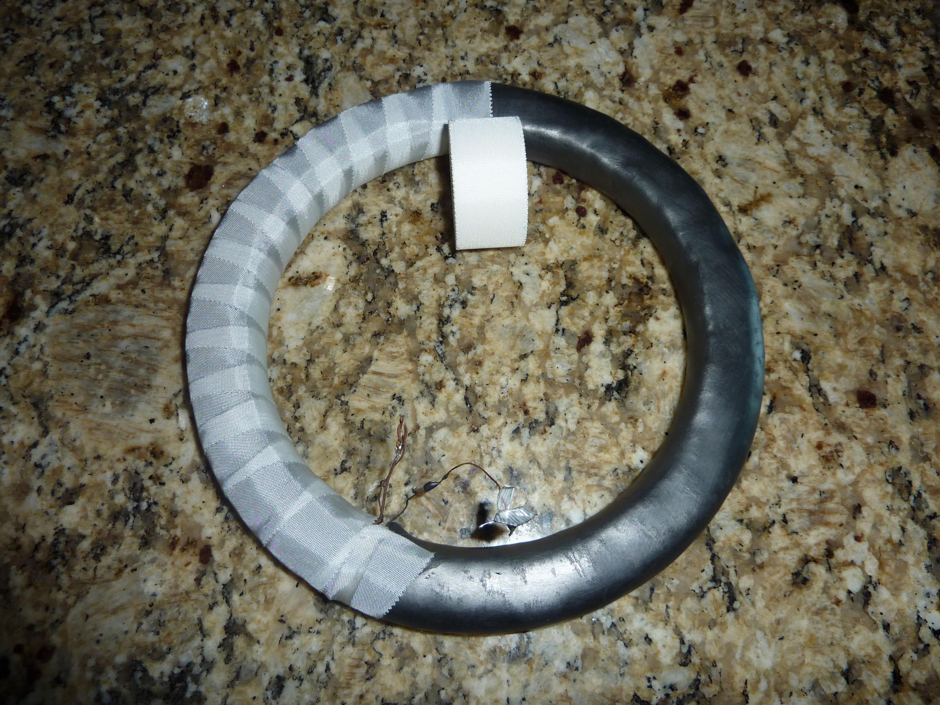

              The fast coil detailed in previous posts/pictures passes the 'Hand Test' with the detector set to a wide open minimum Guard Interval of 10 and Barrier 1, no MASK. There is no other shielding than the outermost coil winding connected to ground. I am tempted to do a graphite shield test on this coil to see if it will degrade small gold performance or improve quietness over mineralized ground.
              I have some of the Scotch 24 shield tape but my detector 'sees' a 1" square piece of it when placed in close proximity to the coil shell. This stuff has been often proposed as a shield material but it is very expensive and I know it will not improve performance on my coil. That leaves graphite as the best choice for additional shielding of this coil.
              I am also going to rerun the coil damping to try out slightly under-damping to see if further improvement can be had.

                i have had good results with graphite paint, applied to the inside of the coil shell, the best two coils (pi mono loops) that i made for my barracudas were simply paper tape applied to the inside of the coil shell(all over) then painted with graphite paint.
                a thin uncoated copper wire is embedded into this paint where the coil wire enters the shell.
                one of the two also has a round sheet of paper on the bottom of the coil painted with the paint also with a small wire.
                but the two coils work more or less the same both are affectively sheilded so i'm not convinced that it needed the paper shield on the bottom.

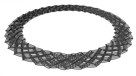

                          • #43
                            I was messing around with this coil design in a program called Maya. This python code might be useful for some of you.

                            • #44
                              By changing the inner and outer radius you can get a more perpendicular crossing alignment of the wires that could help with the capacitance of the coil.

                                I agree! The original designer of this coil was constrained by the coil housing he was trying to fit this coil into and as a result was not able to really optimize the final product for low capacitance. The ideal is probably 90 degree crossings of all wires but getting closer to 90 is good enough.
                                I wonder if your software can modify this coil shape to a 6" X 8" ellipse with 37 slots equally spaced around the inside and the outside edges? I would make the slots ..400" deep and the form 1.00" wide to start. I like to get a visual on how the windings come out.
