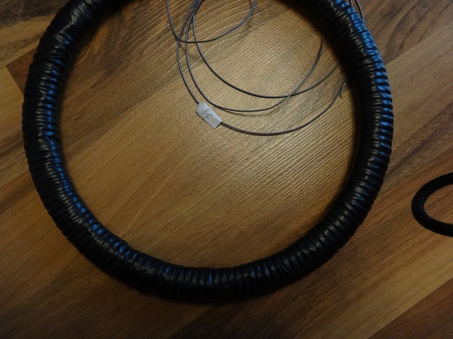

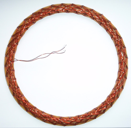

          • I know this will sound a little off the hook, but I consider myself a fairly intelligent guy, can do most anything or figure out how to do it even if it takes a bit...
            Problem here, I cannot for the life of me figure out how you guys are wrapping this dogon spider/basket coil.. I have now wrapped, unwrapped and rewrapped this thing on its form a half dozen times and it comes out looking NOTHING like baum7154's pictures or others I have seen.
            Dont get me wrong, for whatever reason it works as is, 88.9mm inner radi, 0.42672mm wire with 25 turns, approx 327mH and it gets 7 inches on a quarter with my cuda in air as it sits but I want to wrap it like it is in the images (baum7154's) in this thread, does anyone have a video of how they are weaving this? I'm starting to feel like an idiot.....
            I know its better to use the teflon coated silver stranded wire (got some coming in the mail) this is just a test coil first to see how it does before I get to involved with it.. But now it seems it has become a dogon mission and its really startin to tick me off...
            Anyone have a "Hooked on Phonics" tutorial for this poor Un-enlightened dummy, or atleast an explanation on How To wrap this dam thing.....

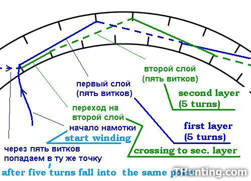

            • Hey 6666,
              I have all of those images but I had not seen the one with the english translation, thank you..

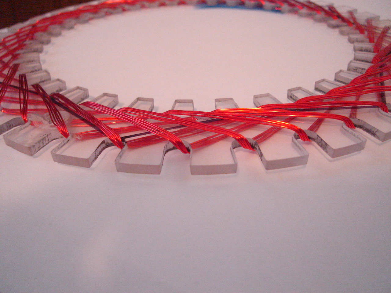

              Now I see where my mistake is, its on doing the second layer of 5 turns at the crossover (blue to green in pic), I had just kept going on the same side...
              Ok, will be unwinding and doin it again, hope it comes out right this time...;lo

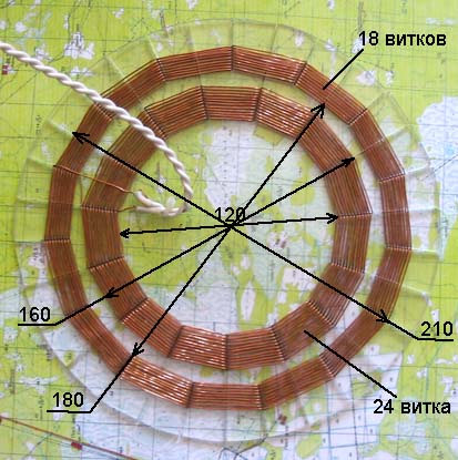

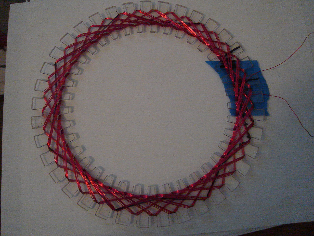

                    Having a look at these pictures should put you on the right track.
                    all right, but big mistake there the winding is drowned by epoxy. right way at first to use some tape 1-2mm gauge, then to cover by scotch, then
                    to drow by epoxy. ie winding will be free in air. that decreases interturn capacitance.

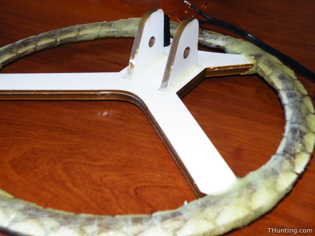

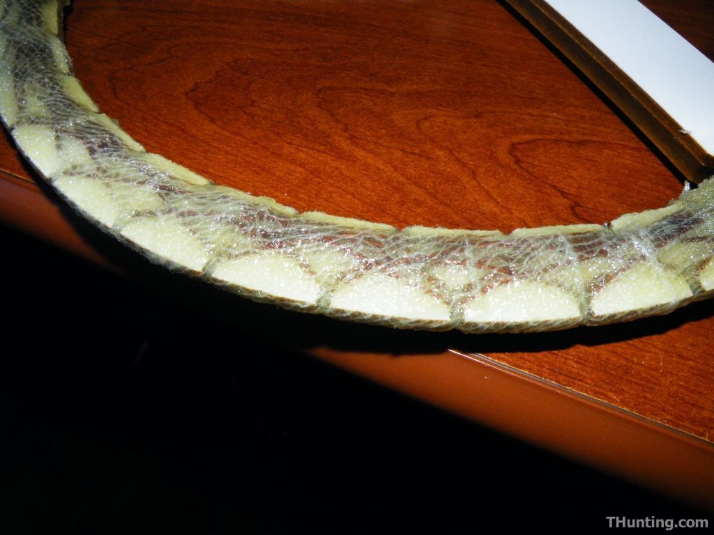

                      • Yes, this is the coil with some self shielding. My 334uh 8" coil in the pictures posted earlier does not see my hand fully encircling the coil with the detector set at 8us sample delay and 'wide open' in all other settings. I would try your coil first without additional shielding as it can easily be added later. Make sure to put the outermost winding wire end at system ground. Don't flood the coil with anything or it will slow down. I use cloth adhesive medical tape as the overwrap of the windings and the form and polyethylene foam per the previous pictures I posted. Then 2 layers of fiberglass are applied as armor.
                        Good luck,
                        Dan

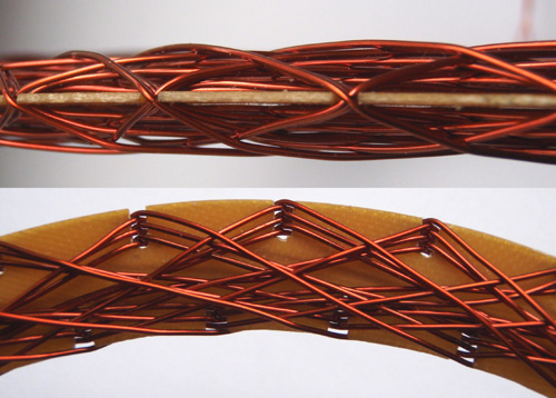

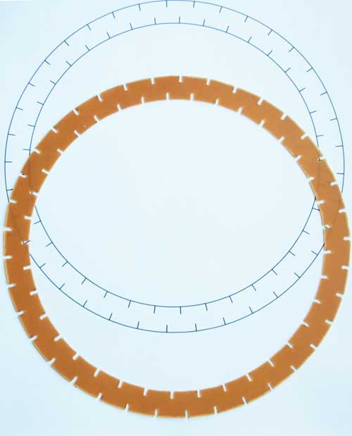

                              Very nice work on the form…it looks like someone has access to machine tools!
                              A suggestion on the form slot width, if you are using about 1/8" thick material the slots should be about 1/8" wide as well. This causes the wires to cross in the slots perpendicular to each other and to stack up in the slot. The object is to avoid close parallelism of the wires and thereby capacitance. If the slots are too wide they do not cross perpendicular to each other in successive layers. Each layer of windings must cross through the slots reasonably perpendicular to the previous layers winding.
                              Hope this helps
