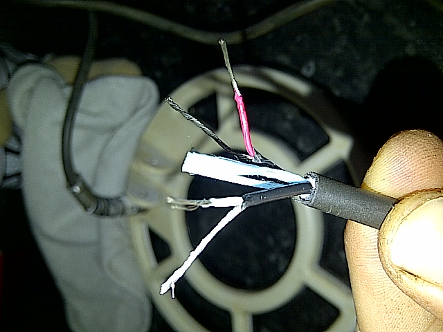

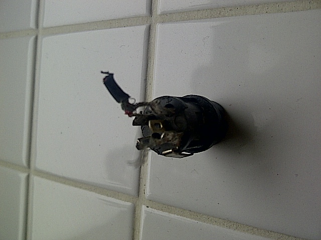

    Strip all wiring.
    4 wires in all.
    White wire with outer earth.
    Red wire with outer earth.
    White goes to no1
    Earth goes to no3
    Red goes to no2
    Earth goes to no4
    All numbers are on the bottom of the connector plug.
    Good works, thanks!
