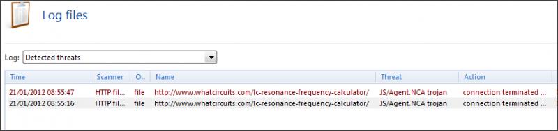

    I run AVG and nothing showing here! Post a schreen shot of the Warning!
      Here it is the NOD 32 report
        Don't know what protection your using but I suspect it's flagging on the Java Script program used in it.
        I can't find anything related to that Trojan on my computer.
        AVG did flag on one site that sugested down loading there solution to the Trojan! LOL
        I trust this site and will continue to use it.
