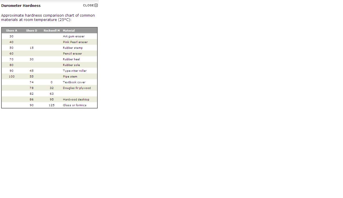

The epoxy from Mouser has a hardness of 82! Plus, this is a very slow cure, which avoids excessive heat and shrinkage.
Just my 2 cents..Attached Files
