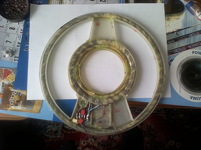

        Hi everybody I bought synthetic graphite too and decided to make a shield for my Idx Pro concetric coil, here are my tryes:
        1. First I used pattex water glue to wood with some waterbased acrylic paint and water, I had nice surface with 1.5k Ohm resistance per cm.
        But in the field, at weet snow it was total disaster.. To get detector stable I can take the treshold only at "1,5" (0-10 scale) and sensitivity at "6" soe it was no sense.
        2. Second tray, i use the same mixture like Satdaveuk-varnish with graphite (2 layers) - painted bottom of coil, and get 1.5k per cm too. Results are much better, now in the wood on weet snow i can take treshold at "5" and sensitivity at "8", with this setup on my 10'' CC coil I can shoot 15mm diameter coin at 29cm in the air, witch I think it`s ok.
        Satdaveuk: How do You think can i say that my shield is ok? Or I have to wait for snows went of and tray it on the weet grass. Now in the field i can`t take treshold much than"5-6" unless i do not touch detector at all because he is getting unstable.
        Hi
        You need to shield the whole coil not just the bottom because otherwise your open to EMI interference which is a big problem for metal detectors making sure you leave the magic 5-10mm gap of course.
        The 1-2k per inch ( depending on size coil) seems to be the typical value with most builds in most locations around the world but for optimum performance you need to experiment as whats good in one location is not so good in the next.
        Also whats important is keep the graphite constant throughout the coil, its better to apply to much and then lightly sand to a smooth finish with required resistance than like yours where you have graphite not fully covering (note left hand side of picture), Also I cant see any gap it appears you have a completed circuit which is no good, correct me if I am wrong'
        To read the graphites true reading at 1" intervals you need to lightly sand anyway otherwise your reading through the glaze which will give you false readings.
        Lightly sand between each coat of mixture otherwise your into all sorts of problems both electrical and mechanical which will cause falseing.
        Its both easy and effective if you follow the procedure put on here but, if you start to stray from it IE using water based glues/paints etc then your in trouble because its no good for this application.
        The varnish types used with great success have been Hardglaze outside varnish and Yacht varnish.

          Thanks for replay Dave
          I will start from the begining for better understand. First I wind the coils check them if they can null, after that I tape them with paper tape, glued copper scraps with cable to make connect with shield, then I paited them mixture water based glues/paints with graphite (now i know that is wrong) with 5-8mm gaps, and finally i taped them once again with paper tape. Then i glued them in coil shell, picture bellow shows it.
          It appers disaster soe, i didn`t want to throw out this coil to trash, just want to rescue this coil soe i shield only bottom cover (i know better will by all) but coils already was glued to shell..
          I was done shield like You wrote- 1st layer 2 days off, then light sandind check resistance, 2nd layer, 2 days off and second light sanding. Graphite is constant from all cover with 8mm gap, visible at north of the previous picture.
          I just want to ask is it normal that i can take treshold only at "5" and sensitivity at "8" on the weet snow and grass, or I have to make another coil ?
          • #65

            If your detector is working with reasonable stability and finds the goods at a reasonable depth then yes you have a good build you have more to play with settings on a quieter site.
            Worth bearing in mind that if you were to go detecting with minimal minerals within the soil content and no overhead power lines, Tv, Radio,Phone, etc transmitters around you would be wacking the sense maybe full up and be able to establish a nice crisp smooth threshold.
            And also bare in mind in those very same ideal situations you could make a second coil with higher resistance property's with the Faraday shielding to give you a bit more edge far as depth.
            Its a bit of catch 22 situation with coils because its a very fine line between producing Faraday shielding that blocks unwanted signals allowing wanted to pass, or over shielding which reduces the signal response to wanted signals.
            When doing your testing your better off going somewhere open in the middle of no where, leave your mobile phone in the car or at home, check your shoes or boots for metal content if so change them, keep keys etc in your top pockets well away from front end of detector and you will notice a very big difference in your results.
            Dig some holes and bury different coins etc and let us know your results.
            Far as snow don't worry about it, some of my detectors actually respond better in snow and frosted ground.
            Your going the right way about it with real ground tests, avoid comparing with anyones air tests because it doesn't prove anything or any help to how well a metal detector will work the way its designed for.
            You done a neat job of that coil like the way you have mounted TX/RX capacitors within the search head which means you can easily make interchangeable coils.
            All the best
