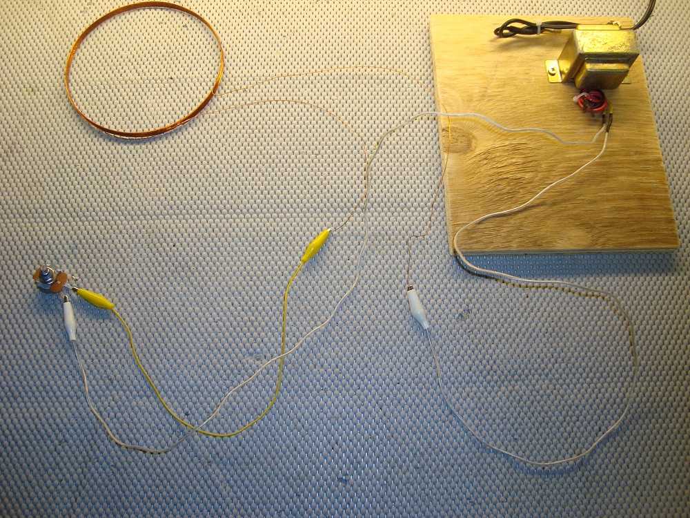

    I made a rig to measure inductance as per shown on this page. http://www.coilgun.info/theoryinduct...inductance.htm
    Now, I'm sure this would be a suitable test for a 60Hz device, but I don't know if the frequency is suitable for detectors.
    I thought I would try it anyways.
    I used the calculator here to get the specs say a stock Baracuda coil at 453uH
    Now the final coils will be wound with regular insulated wire but I just wanted to verify a testing procedure so I made the practice coil with enamel coated wire.
    Inner Radius - 77.5 mm
    Wire thickness - .46mm
    Number of turns - 33
    Results
    Mean Radius 78.82 mm
    Coil thickness 2.64 mm
    Inductance - 0.462mH
    So I spin a coil and test it, around 2-3 layers thick.
    I could not use me resistor decade box as the test shows as it only goes down to 10ohms. I used a 25ohm rheostat instead.
    I turned the rheostat until I got equal voltage across the rheostat and the coil, 2.6v.
    I then got the measured the impedance on the rheostat which was 1.8ohms.(Lx)
    Using the formula based on my 60Hz transformer,
    L = Lx / (2 pi f)
    L = Lx / 377
    L = 1.8 /377
    =0.004774
    No matter how I move the decimal place I can't get it to line up with the "477", so I assume this number is just a coincidence for now. (The "477" would have been pretty close to the 462uH that the calculator predicted)
    So I don't know if it's because of the frequency I'm using, my math or the testing rig itself. It seemed like a reasonable approach to measuring inductance with a higher voltage. (6v).
    Any suggestions?
    Thanks for your time.

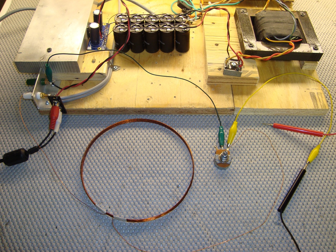

        OK, I put a 10kHz signal into a LM3875 audio amplifier. I used samples from these two sites. I set the volume half way and measured 4.6v or 5v depending on which source tone I was using.
        http://www.freesound.org/people/klan.../sounds/28637/
        http://www.youtube.com/watch?v=wVoF_aDPxWw
        Anyhow the coil and the rheostat balance out now at 25.4 ohms.(Lx)
        So f = 10 000
        L = Lx / (2 pi f)
        L = 25.4 / 62 800
        L = 4.044585987261146e-4 (I'm assuming Henry?)
        So I'm not sure what to do from here with this number, here is what I did:
        -If I punch in 25.4 / 62 800 = 4.044585987261146e-4 x 1 000 000 in that exact order into my calculator, I get 404, which seems like it may be a result, 404uH?
          Based on the numbers given,
          Inner Radius - 77.5 mm = 6.1" Dia
          Wire thickness - .46mm = 25AWG??
          I would think your coil will be about 330uH.
          Or Less, if it is Not Tightly bundled together.
            Yes, 404uH is your result. This method is not terribly accurate because of series R and shunt C parasitics. Based on your parameters, you probably have a wire R of about 1.7 ohms, which puts the actual L closer to 377uH. And, as Gary notes, this could still be off.

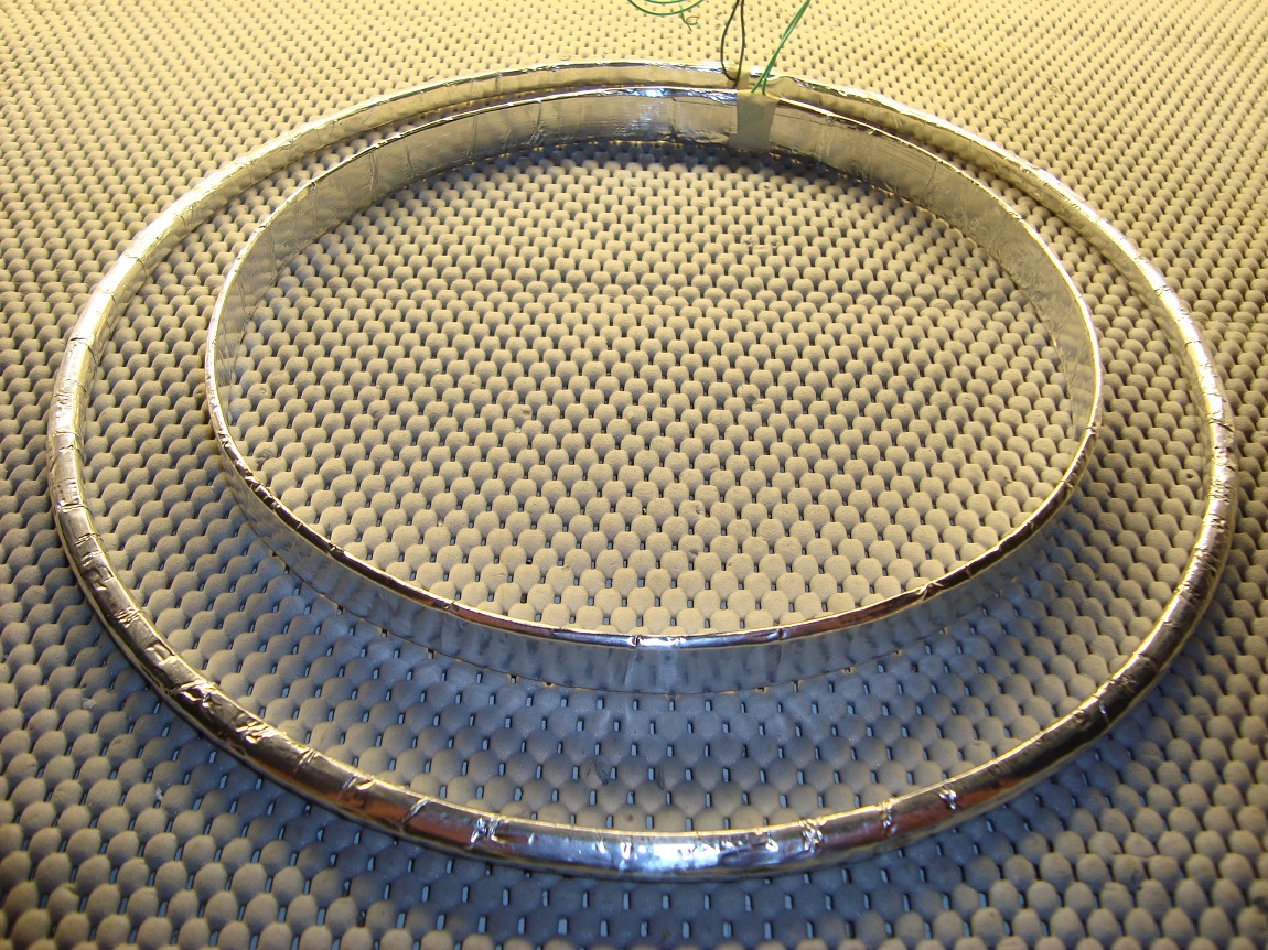

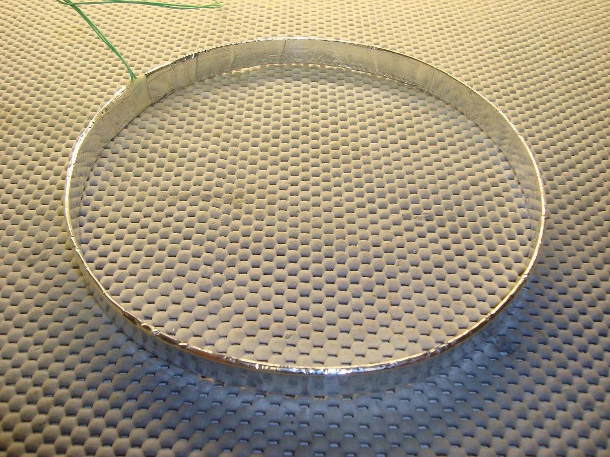

                I can't help but wonder if the profile of the coil has much of an effect. The coil you see pictured above is relatively flat, like the coil you see pictured below. It is 26 turns of 22AWG in two flat rows of 13. 7 1/2" diameter(19cm)
                I have not measured it yet.
                I assume the calculator posted here is generating a round profile?
                The next coils I wind I will try to make more of a square profile, closer to a round shape.

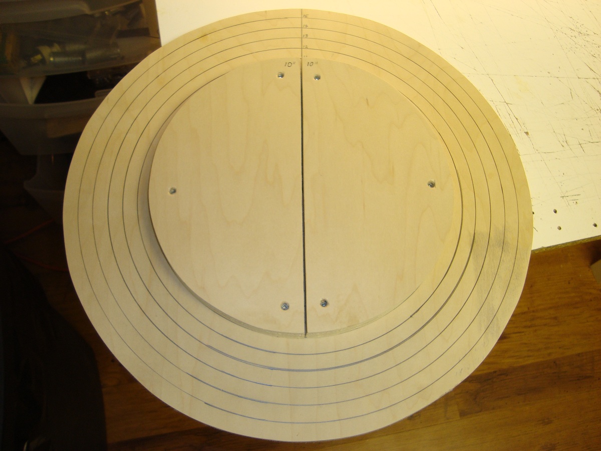

                I made this turn table this morning to spin my templates. (Picture below)

                I can however keep the coil stable with the masking tape and aluminum shield like you see below.
