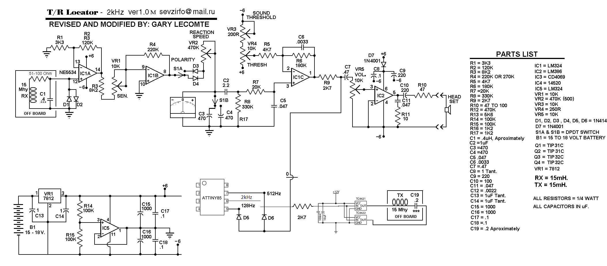

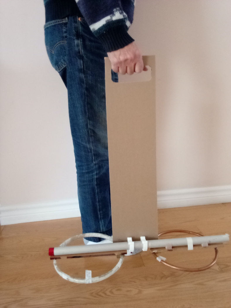

Very interesting.
You should make the audio vco so that it changes the pitch in relation to the signal strength.
And of course it must have GEB function. Otherwise the range is excellent!
