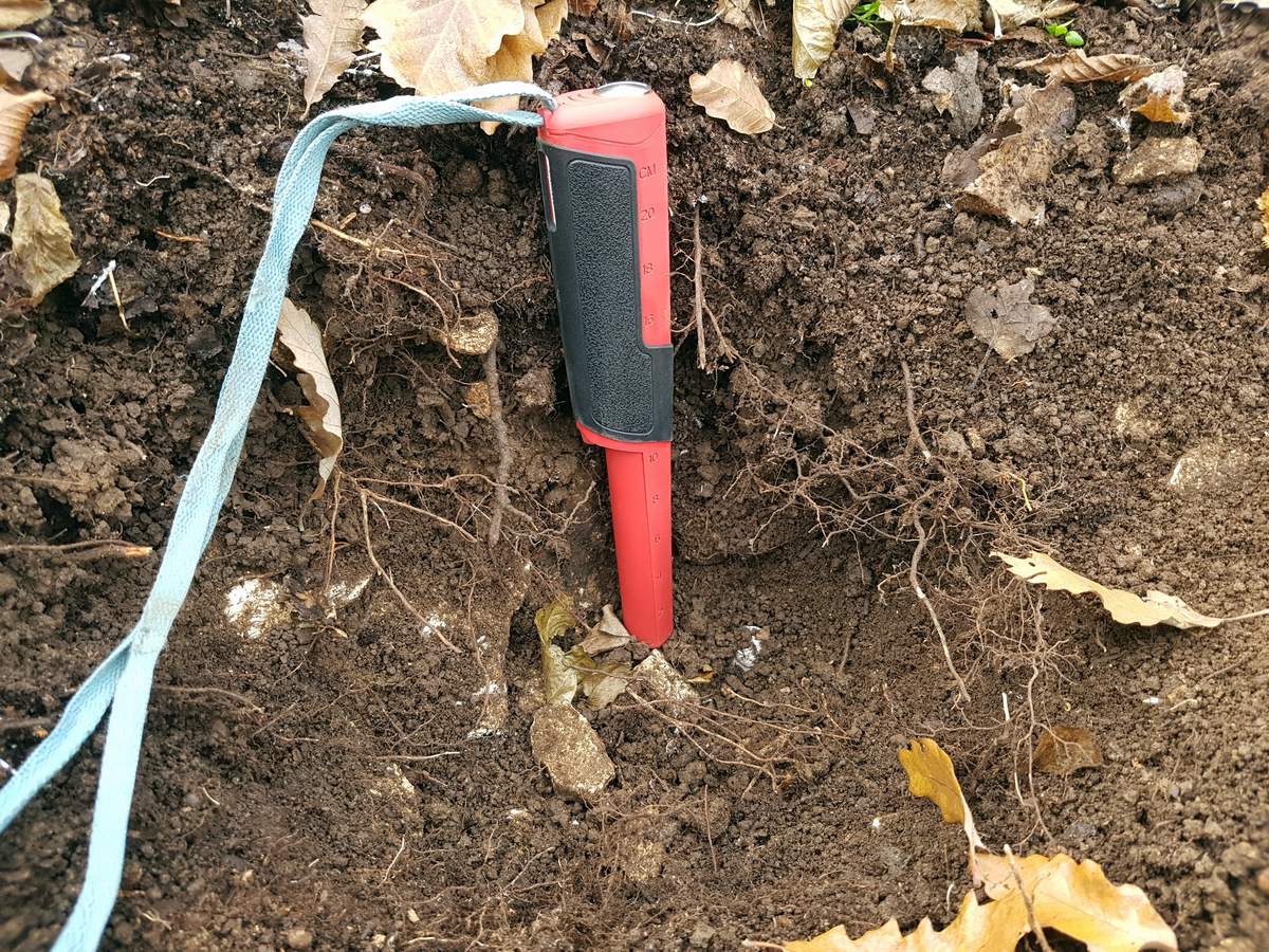

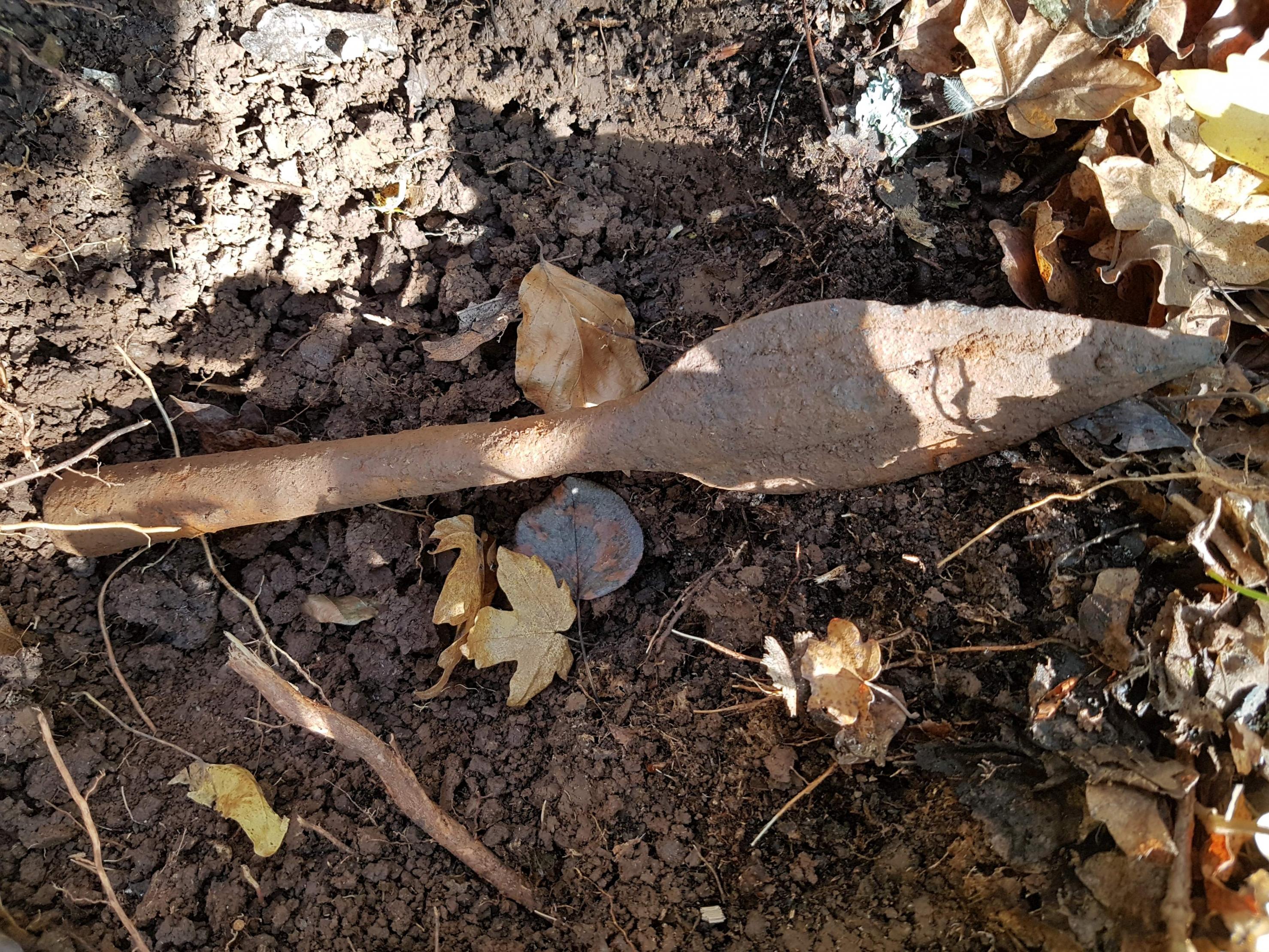

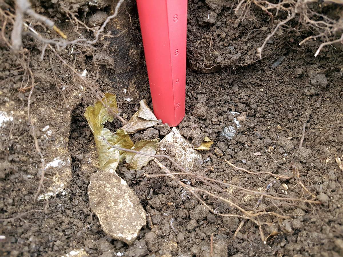

      XP Deus & F-Pulse , winning combination lately for me...

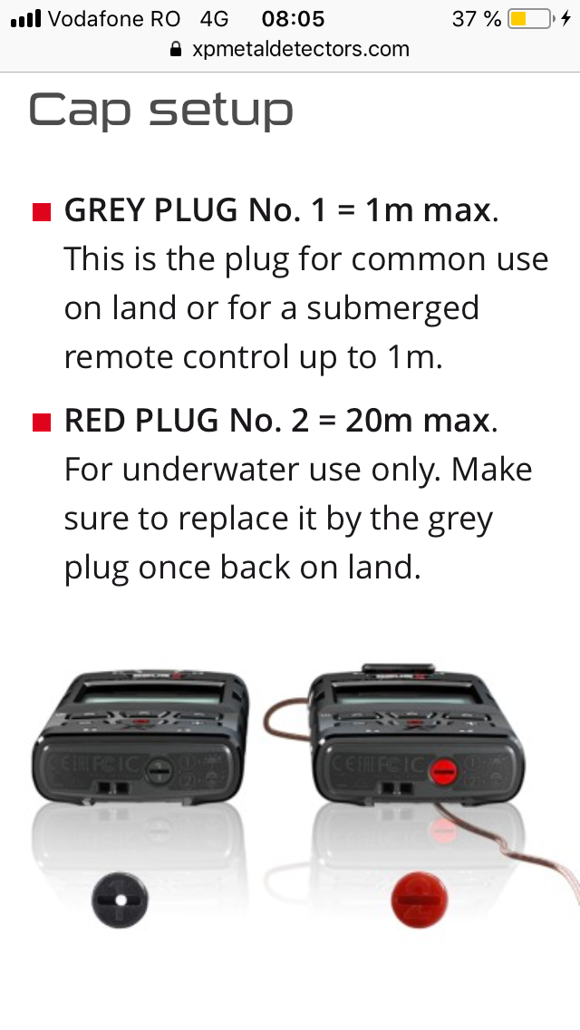

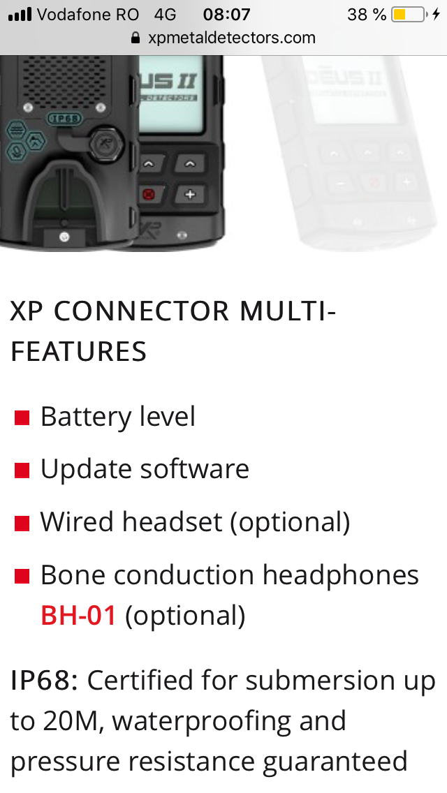

            There is a classic coil cable connector on the back. It's for a diving purpose, I guess. Not everything is completely clear to me there.
            I don't see a
            coil with cable on offer. Then why that connector?

                When use it underwater you just need to run a cable from coil to remote control. It does not need to be connected. It will be a link between the two, like an extension of wireless antenna. I use it before, but not original kit, just a thin coaxial cable. (I think any wire will do)
                As for the picture with connector from the back is clear. The red plug i think will be included in the water kit only to make you buy it when diving. The grey plug will come as standard - the purpose can be that the remote can breathe ??
                  [ATTACH]56258[/ATTACH]
                  [ATTACH]56259[/ATTACH]
                  Everyone who is self-conscious, who keeps to himself, wears a mask today! So is Deus 2 too!
                  In any case; thanks for the explanation! Now at least I understand why that connector and those "plugs" on the bottom.

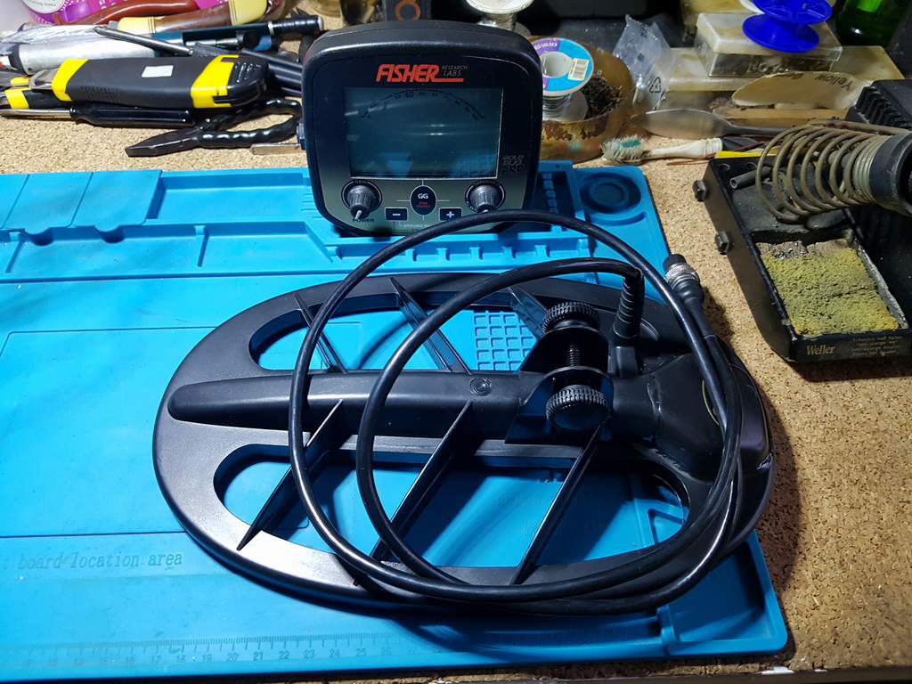

                  • As for the heredity of the coils...
                    FT is probably the clearest example of this.
                    Right now at home I have a Quest X5 that has a small original coil.
                    And from before, I had a Ukrainian coil for Teknetics T2.
                    I accidentally discovered that this coil has the same specifications as the Quest coil.
                    It's just that the pin layout on the connector is different.
                    It's hard to describe the pleasure when I rearranged the connector and connected that larger coil to the X5.
                    But that is only part of the story.

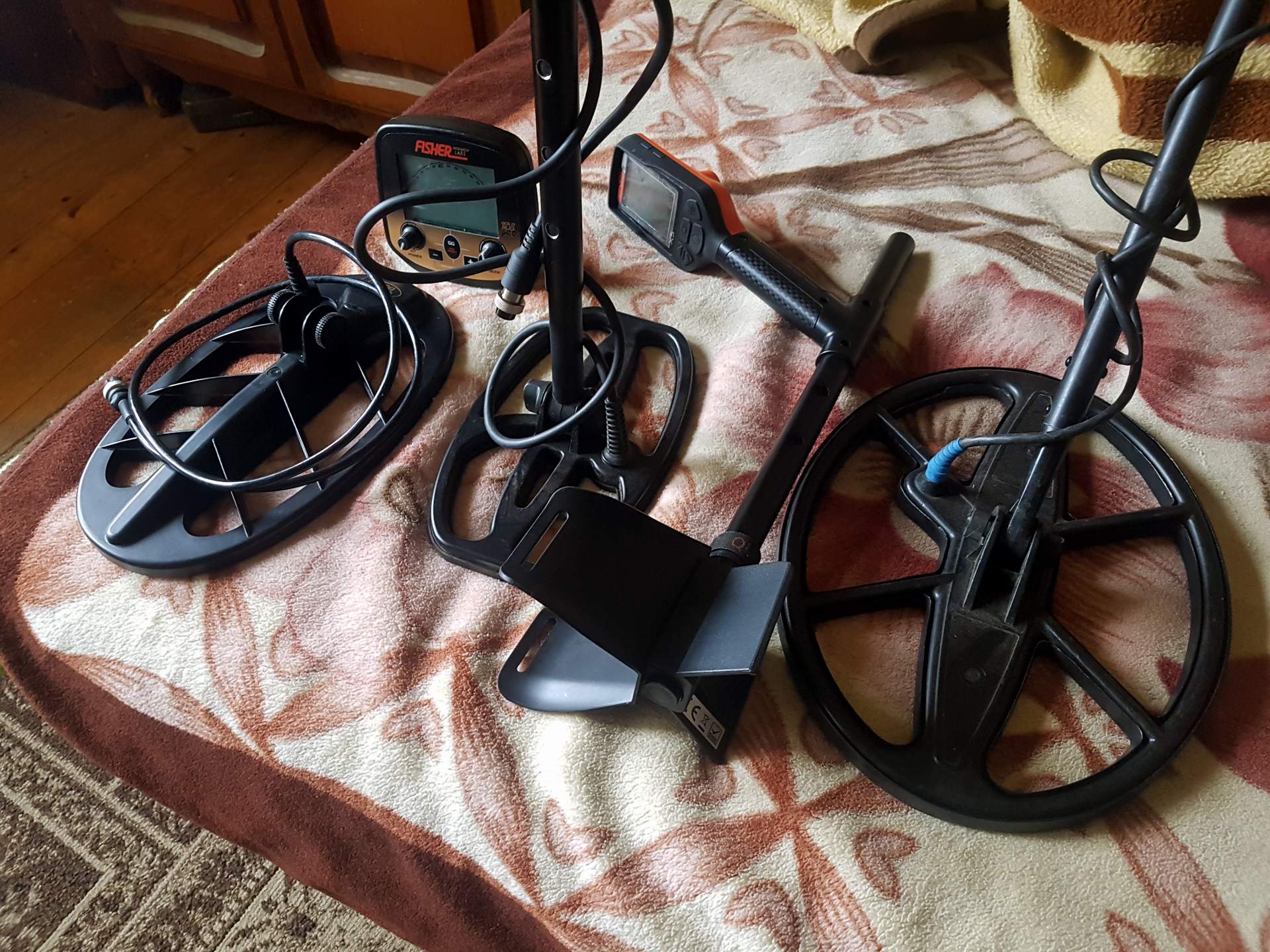

                    A friend sent me a Fisher Gold Bug Pro, just a machine, the detector box, no coil and rod.
                    So I ordered the coil via Aliexpress.
                    So the coil arrived the other day. Tried it with a detector and it works great.
                    Out of sheer habit, I used an instrument to measure the resistance and inductance at its connector.
                    I was not a little surprised, and above all thrilled, to discover exactly the same specifications as on the two previously mentioned coils;
                    small stock one from X5 and Ukrainian one for T2 !!!
                    So now I have two different detectors and 3 identical specs coils.
                    With the change of pin layout on the GBPro coil as well as in the GB Pro detector box itself (easier because it has cables from the connector to the pcb);
                    I get the possibility of interchangeability of coils as needed from detector to detector, easily, quickly and without problems.
                    Later through correspondence with a friend from this forum; I find out that the coils are also fully compatible with several other different models of Teknetics and Fisher.
                    Which ultimately increases the list to a choice of over 20 coils with the same specification but different sizes and shapes.
                    Well, that's something that makes the user happy!

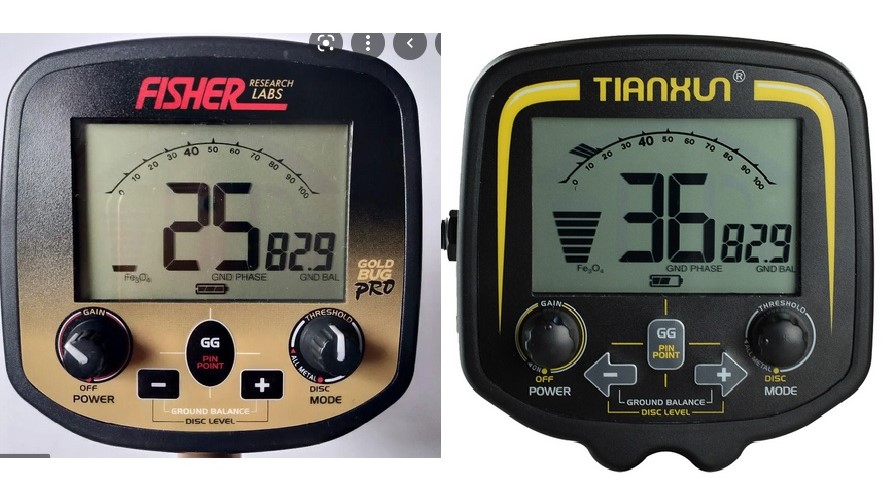

                          • Ivconic it used the TX-850 Tianxun metal detector???
                            https://a.aliexpress.com/_mNsK8Zc
                              • Thank you Ivconic.
                                they really are the same.Click image for larger version
Name:	Fisher gold bug Pro = Tianxun TX 850.jpg
