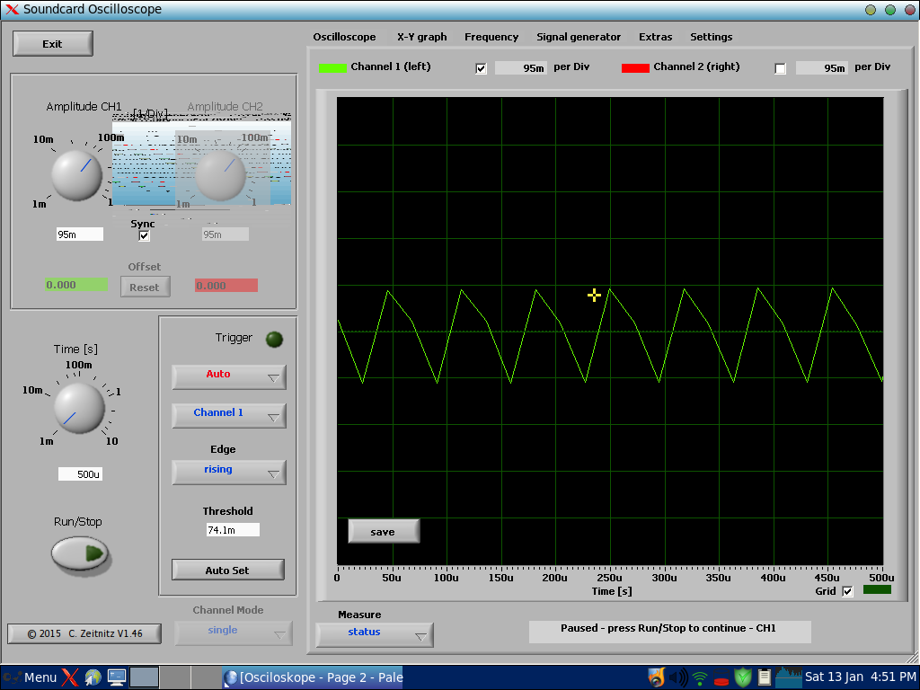

    I dont think it gives accurate voltage using this scope, only displays waveform. Soundcard is AC coupled. Look at pic in post#26, this shows the freq, measured by software. Click on freq, tab on software to display spectrum analyzer window where freq. of wave is displayed. There are three jacks that are associated with soundcard, I used the microphone(pink), not green(headphone out) or blue(line in). I built a buffer circuit between soundcard and circuit under test. The titles all say Tx.
      Also i forgot to mention that buffer circuit has attenuation resistor, thats why it looks small(amplitude)
        Ok, i can not get such a nice wave like you. I have played with the settings.
        But its ok, thanks for your help. I will use the multimeter for the new coil and hope for 35 cm +.

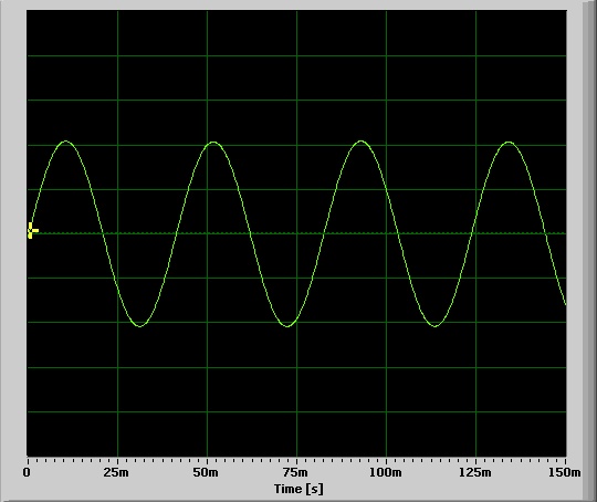

          Here is better waveform of my TX, the timebase is strange, but its a nice sine wave as you can see, and it measures around 14.5khz. Maybe someone can help me understand why the timebase is off, yet the same software shows freq. of signal at 14.5khz
            Here is actual TX with correct timebase. Now it makes sense. There is something else oscillating at around 24hertz on this line? That smooth sine wave was too good to be true.
              Looks like aliasing. 14418/1000 samples/sec would give a 418Hz signal. Sample rate needs to be greater than 2 times measured frequency. 10 or 20 times is a lot better
                I see, well this illustrates the need to get a real oscilloscope, if only a cheap 20mhz analogue. Ebay, here I come.
