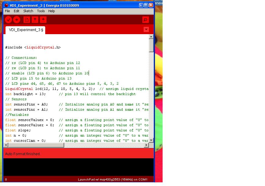

    I just put Dons VDI code into my Launchpad - I cant verify as no display Plus the A/D are 10bit in Launchpad so will need some tailoring - bit beyond me.

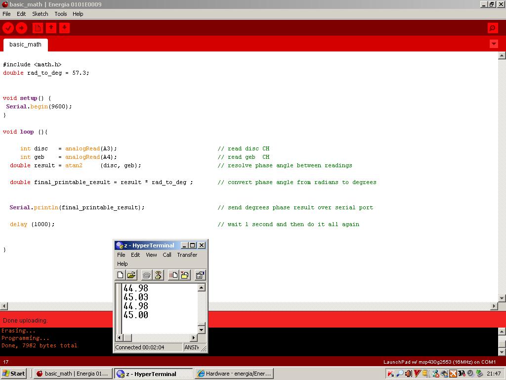

    Had chance to look at Ti Launchpad.
    Got some basic phase angles from two A/D reads - result sent out to serial port.
    This was two equal voltages in disc and geb inputs

      That's encouraging, that you at least got it to run. Maybe you could just implement an LED bar graph with it? That would be easy and usable I would think..

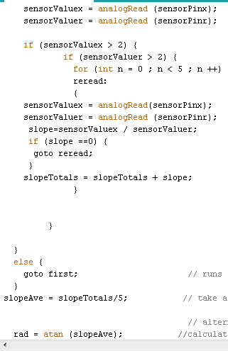

      Also, I made a few improvements to the code I have been using. By playing with when the analog sensors are triggered and the number of samples taken more consistent readings can be realized, especially when the distance between the coil and targets vary widely:

          I was thinking along these lines last night for when to read, and how to use qualifying samples in a block average etc. Many ways to skin all of those cats!
          Toying with 3rd CH measuring the Comp Threshold volts,
          So,
          While X AND Y are above Thresh
          take readings ( each of which are checked for level) to a maximum of say 10 times.
          So it only displays from a valid 'hit'. My starting point was going to be use the Copmparator output to (a bit like a button push) to start analog reads.

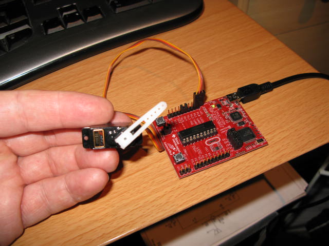

                  I had a small model servo in the scrap box - makes a quick VDI. Shown is 45deg.
                  S

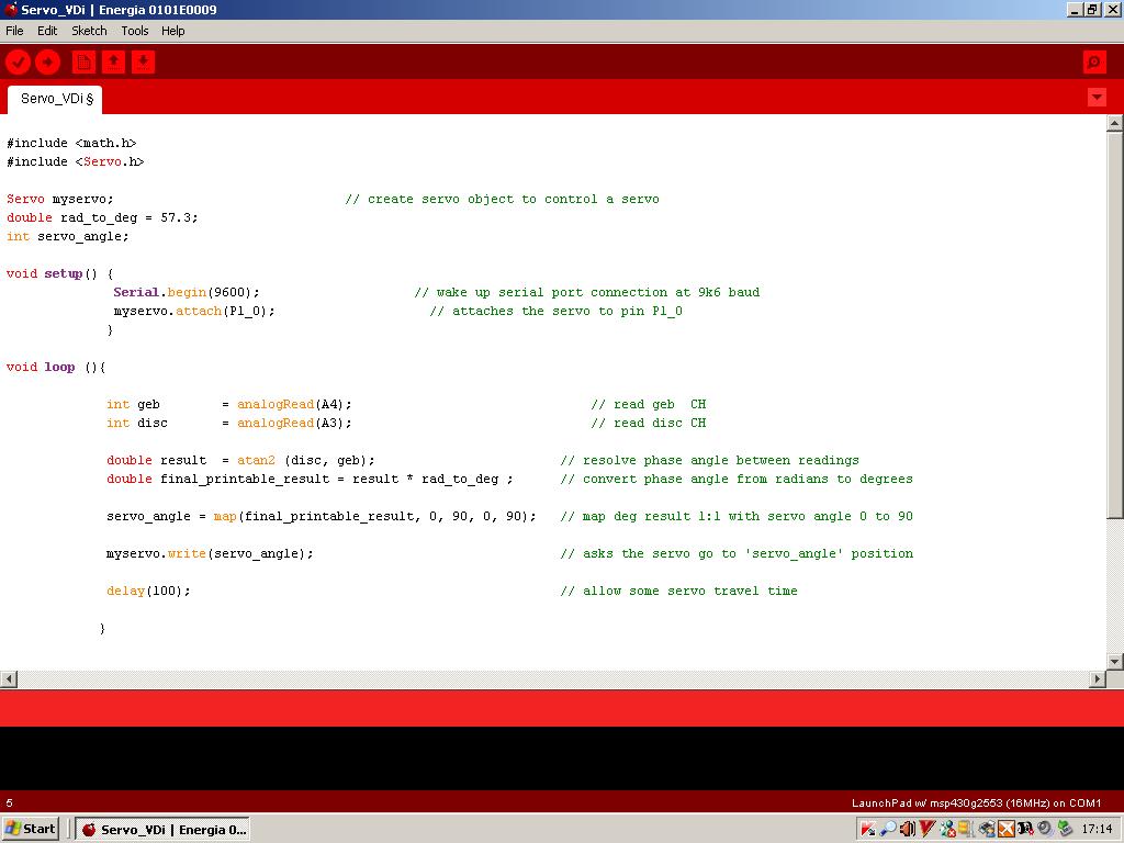

                    That's pretty neat.. I have boxes full of servos as well. How did you write your code?
                      I did it this way Don. There is an example sketch with srvo stuff in, I copied some of that and made it fit. There is a scaling function which maps a number range to a degrees on the servo range. In the worked example it had (0 - 1023 , 0 - 180) i.e. an 8 bit a/d read to 180 max sweep. I alttered it to my degrees result of 0-90, to a servo sweep of 0-90, so 1:1 scaling. I havent tested it much, only two equal A/D inputs for 45deg. If I get 2 pots, 6 wireses and some test assy time I can verify more..
