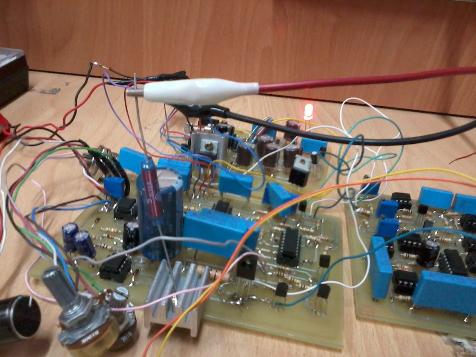

      • #48

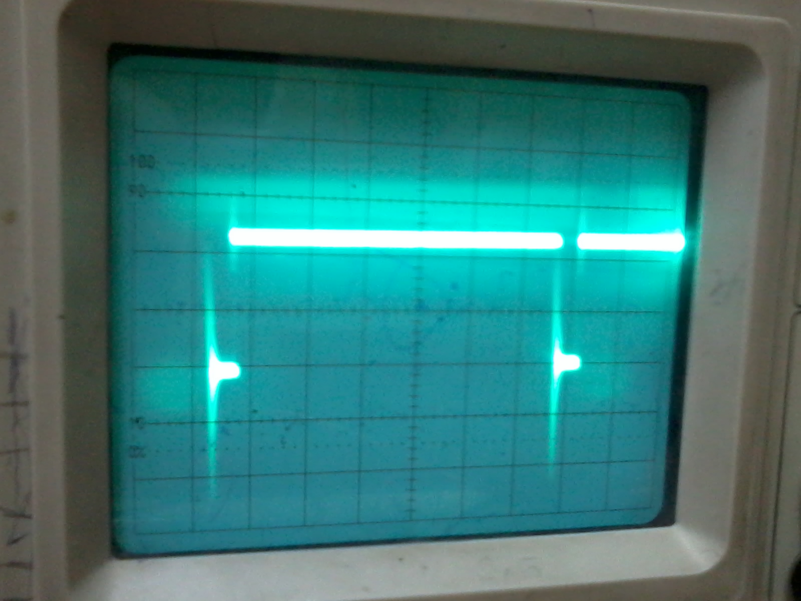

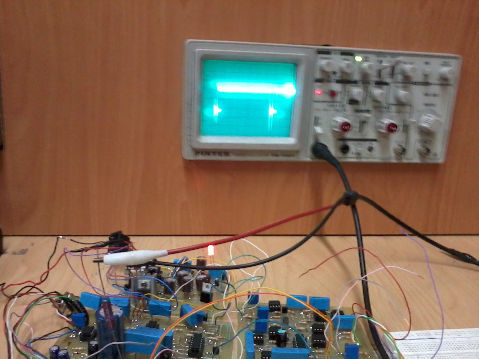

        Originally posted by mohandes View Post
        Hi georgi and all
        ok finally i think give true resuts, but i can not understand why i dont see 600 or 700 volts on ifr740,look at the pictures,please
        if ther are ok say to me, my oscope is 100MH
        You need a coil at about 300uH to see any flyback voltage. Otherwise it is only switching up to Vcc.
        When you do have a coil, try not to have so many wires going everywhere because 600V can be very painful, and it can also destroy the rest of electronics. For coil connection use only good insulation on wires to prevent arcing. (I must clear my mailbox)

          • #50
            you can use this wire in parallel

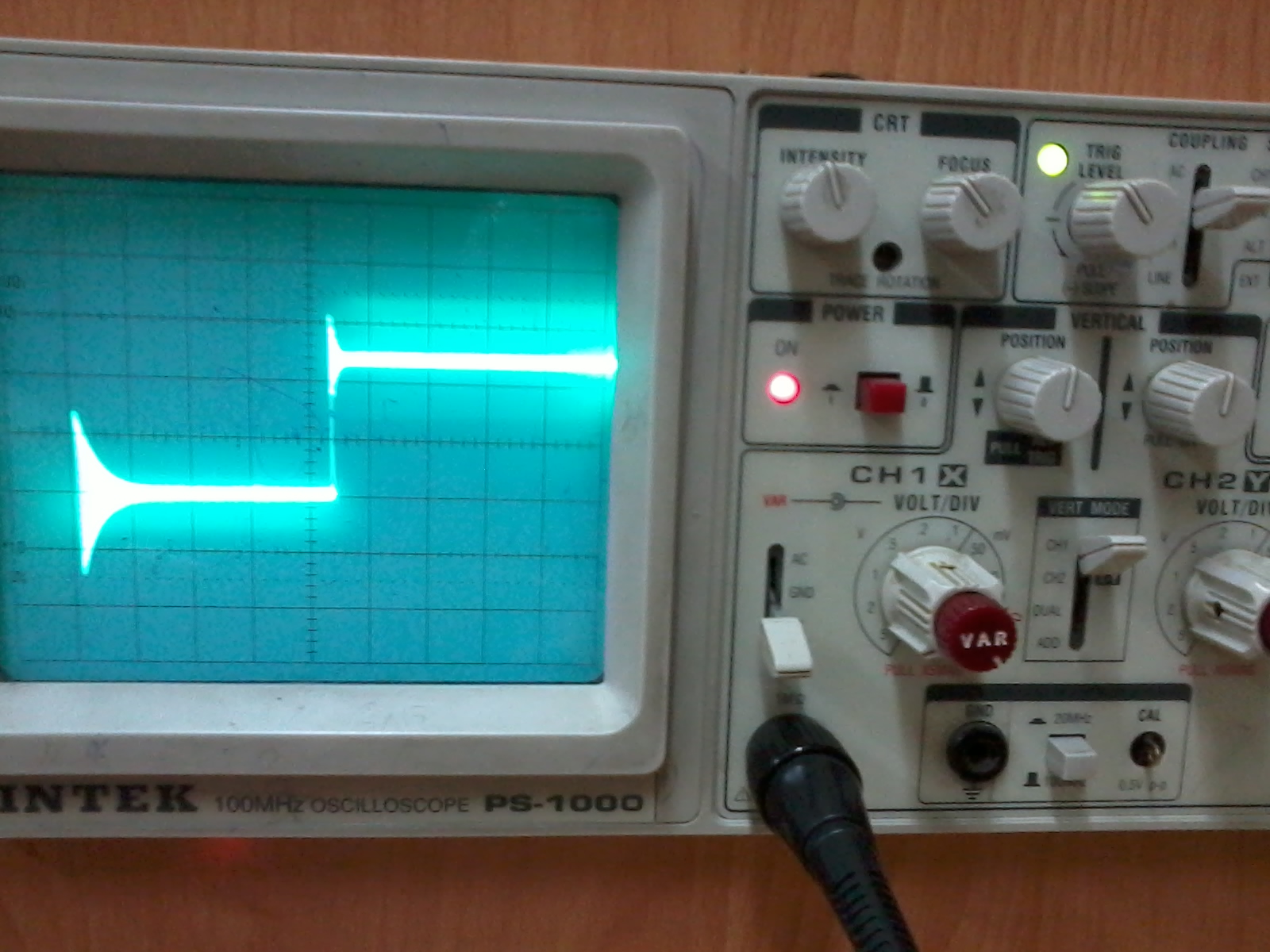

            • #51

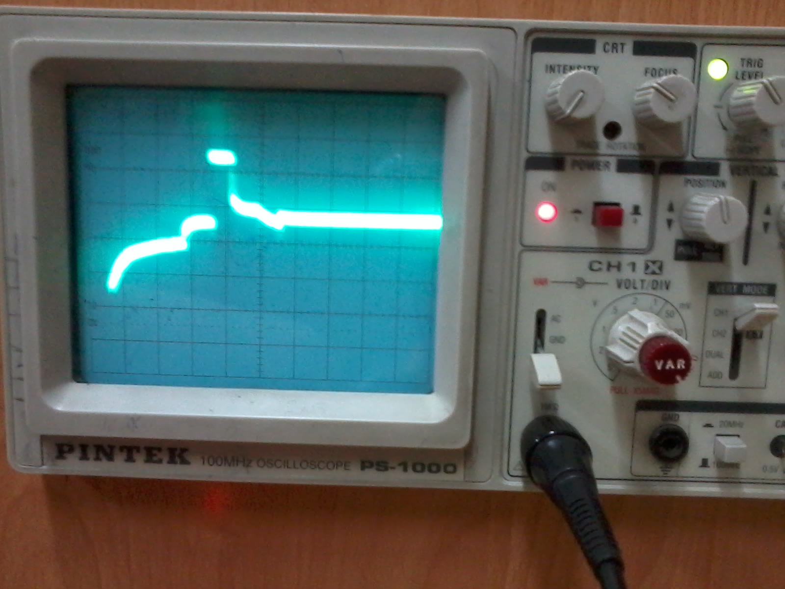

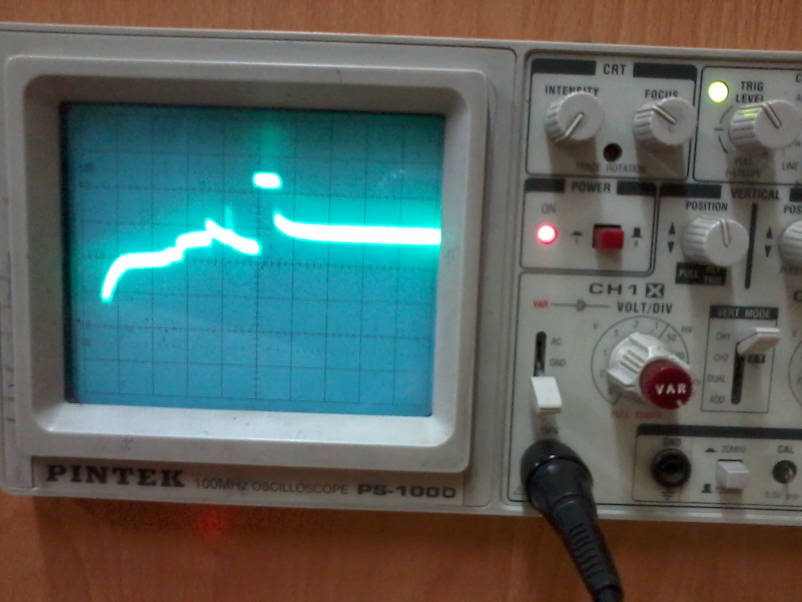

              Hi dear davor
              when you say i go to collage and again measure , i put a inductor (ferriet) 350UH in the head of probe and then measure irf740.the pictures

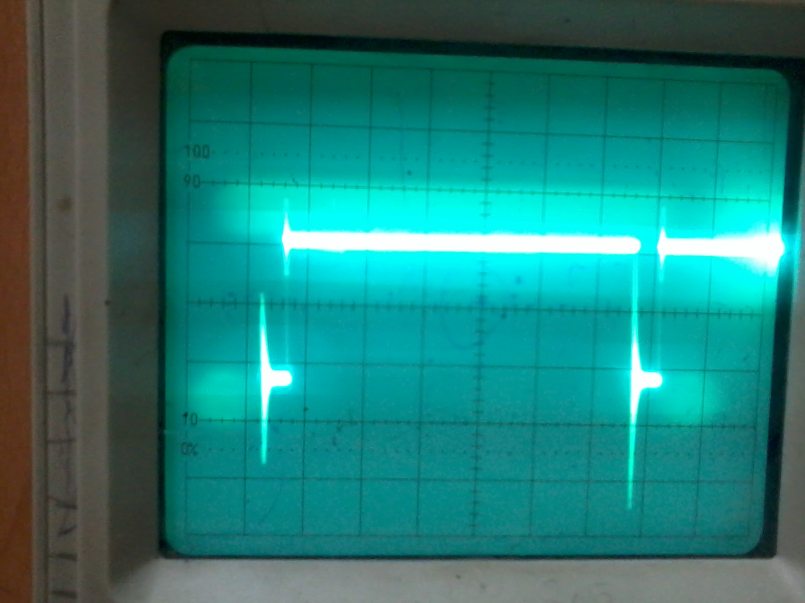

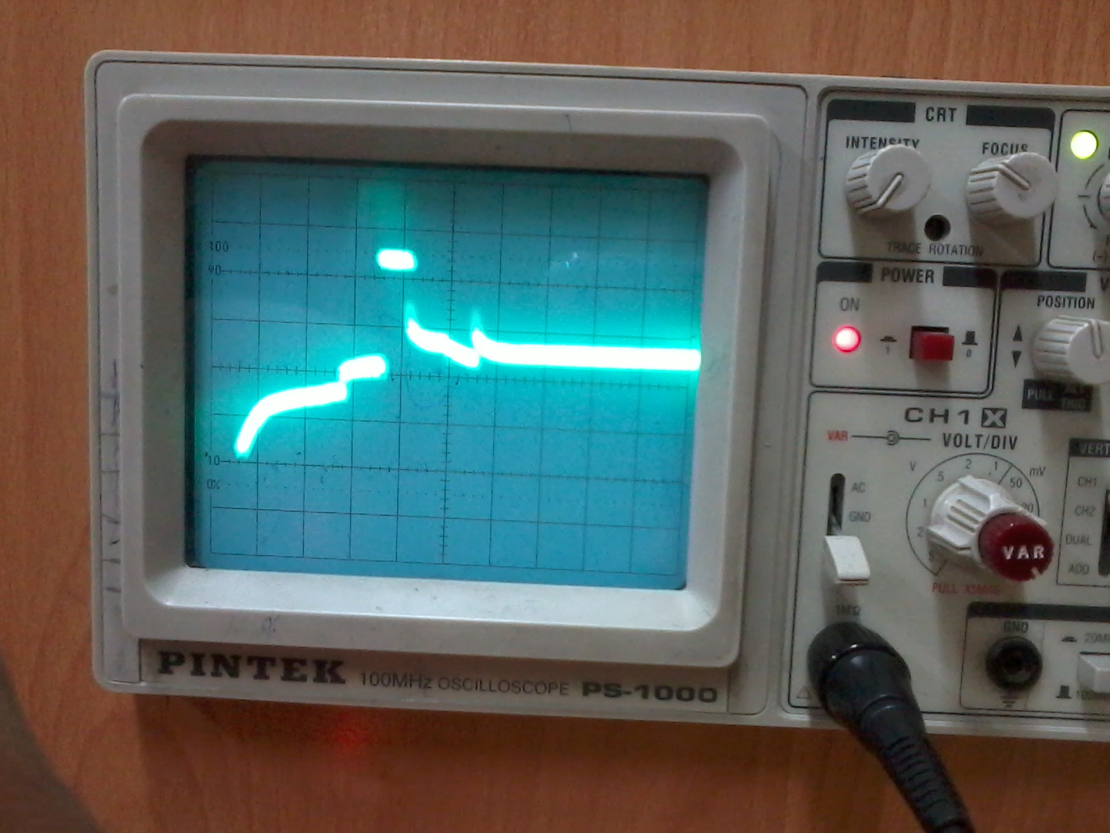

              • #52
                Hi georgi and all
                in this pictures of the outputs in second pcb , X Y Z.
                why the figures is marvelous?can you expalin

                • #53
                  Eh, that's not what he meant. Do you have a search coil hooked up to the circuit?

                    • #55
                      I think you may be beyond your capabilities.
                      • #56
                        Apparently he has a ferrite choke of some 350uH which most probably is saturated all the time.
                        Mohandes, my friend, first my condolences for the catastrophe that happened in your country. It must have been horrible.
                        Second, for a proper operation you must have a coil without core, a simple solenoid. Coil with core is tricky. It can saturate. Using a ferrite core in any circuit means that you understand how hard you can load it. Only a coil without core can run well in all conditions.
                        • #57
                          It looked to me like he had the choke in series with his oscope probe.

                            • #59
                              Just make some 300uH air coil. You can use telephone wire to make a coil.
                              Funny responses that you measured are most probably oscillations because your choke is somehow resonant. It rings.
