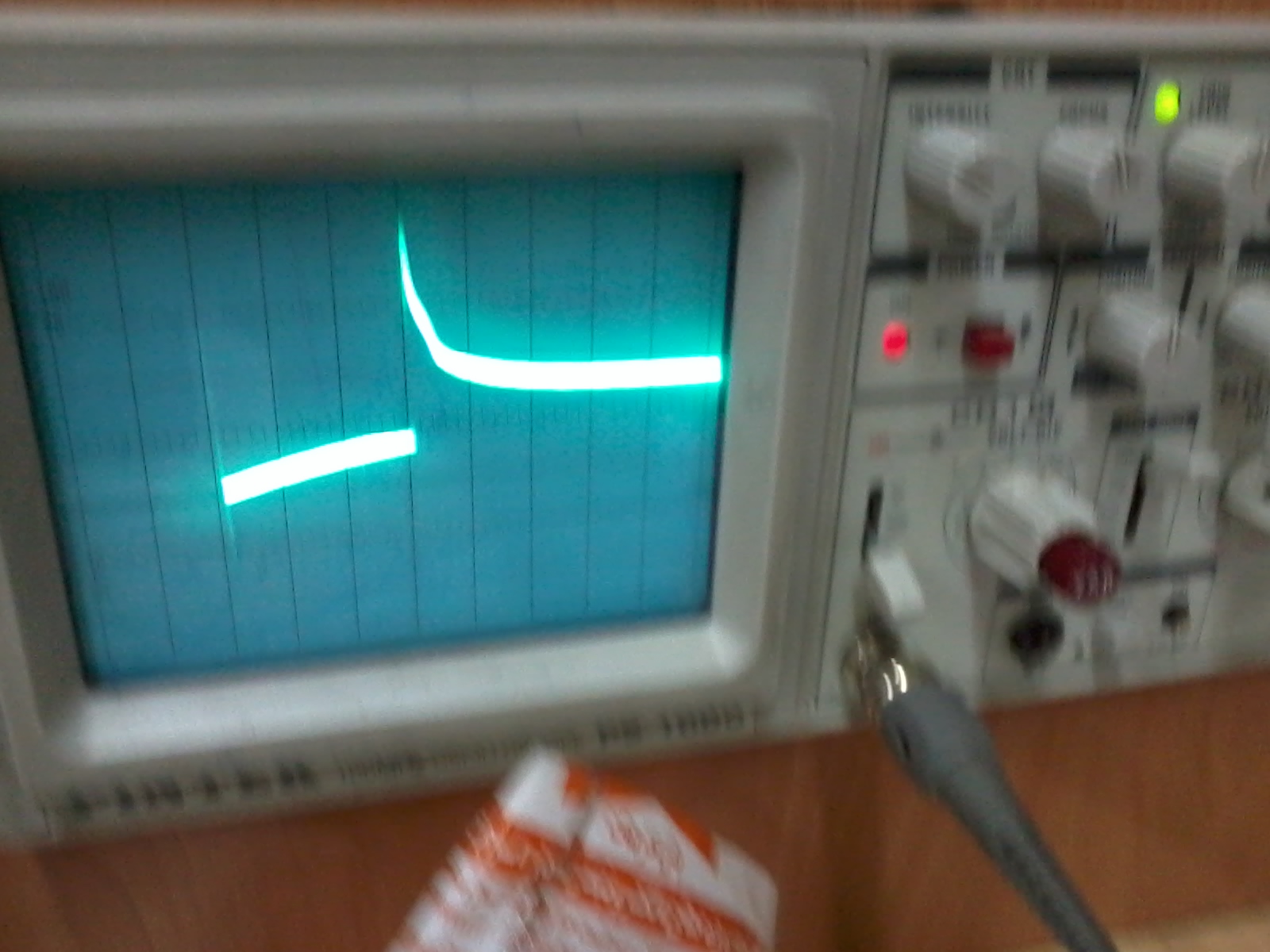

  • #91

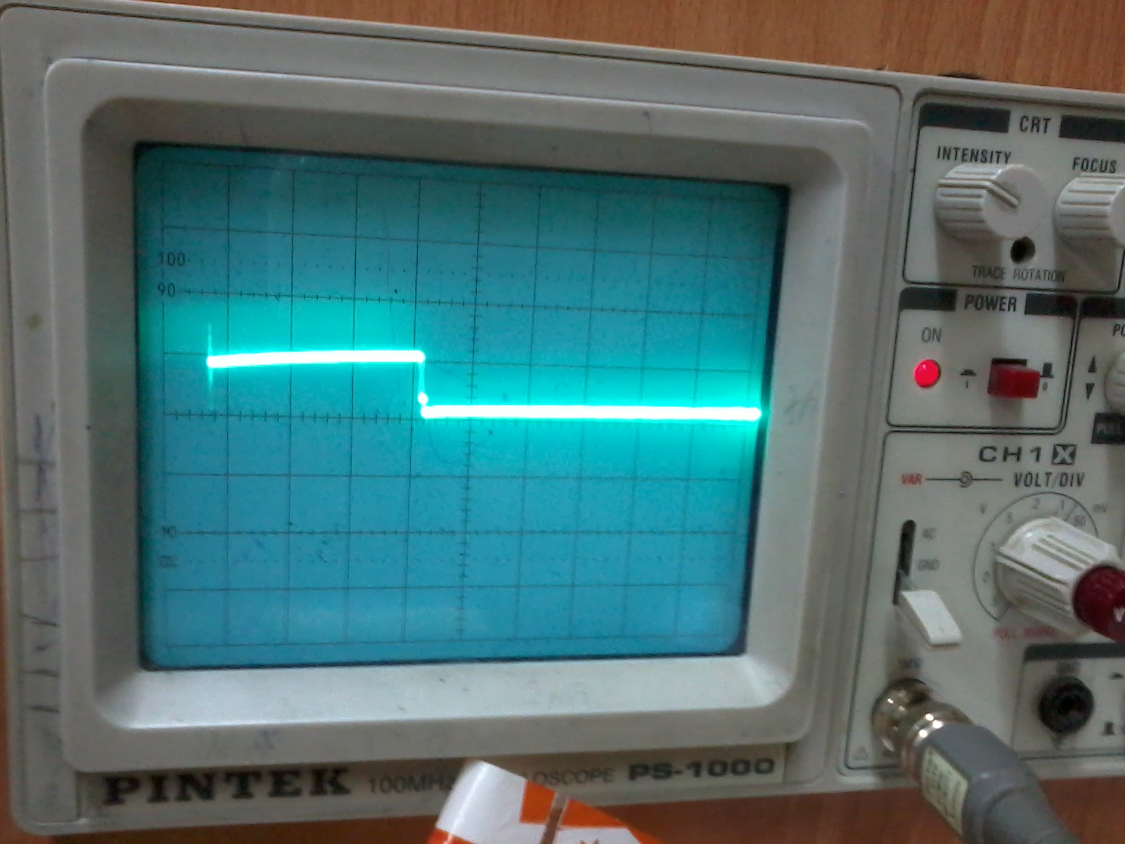

    1-base of Q2(bc337)
    2-collecor fo Q2
    3-emiter of Q2
    are thay ok?
Name:	2013-04-21 17.34.12.jpg
ID:	335931Click image for larger version
Name:	2013-04-21 17.38.30.jpg
ID:	335932Click image for larger version
Name:	2013-04-21 17.41.27.jpg

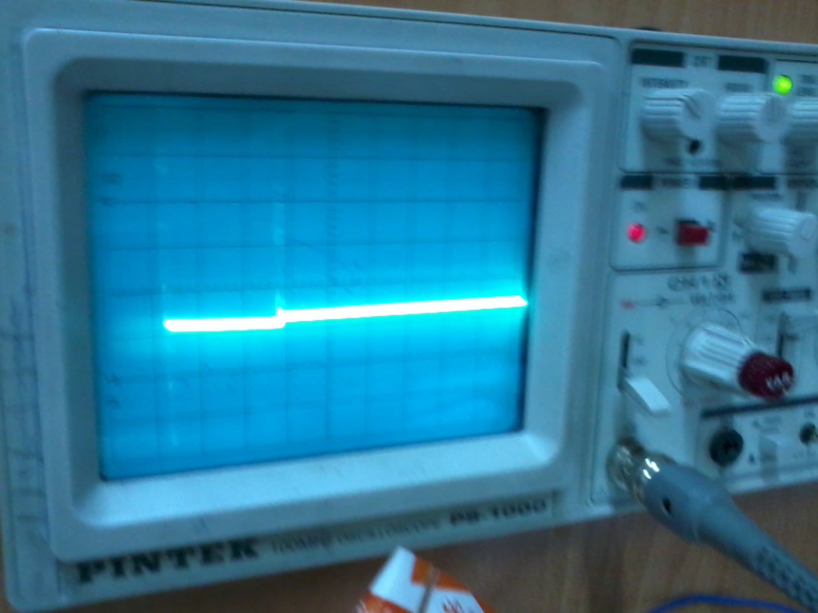

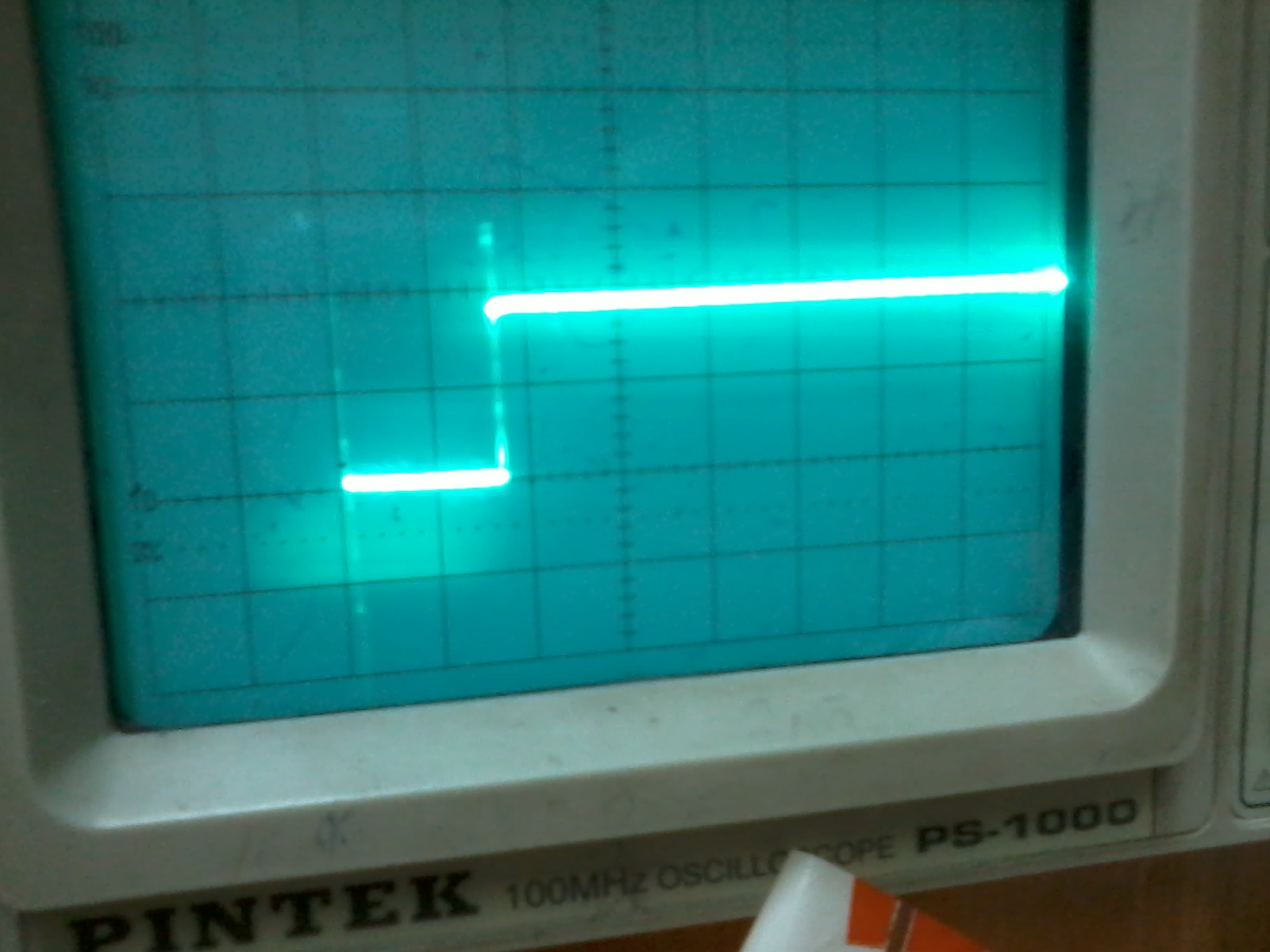

    • #92
      for BD140
      1-base
      2-colector
Name:	2013-04-21 18.00.05.jpg
ID:	335934Click image for larger version
Name:	2013-04-21 17.55.46.jpg

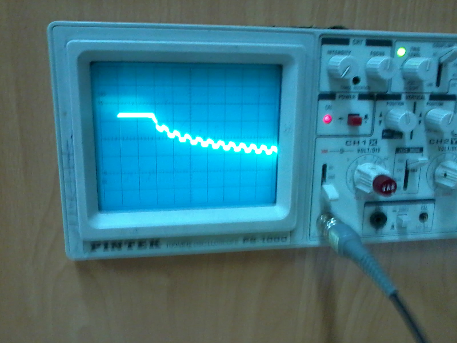

        • #94
          ok i said incredible,when i put just ne555 have this wave on pin3 ne5534 or D3,D4, why?
          i put this linke for pin2 and pin3 ne5534:
          http://megaup.ir/images/pt_video-201...1-17-25-27.zip
Name:	2013-04-21 18.29.08.jpg

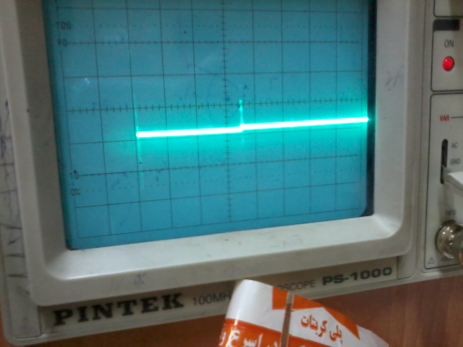

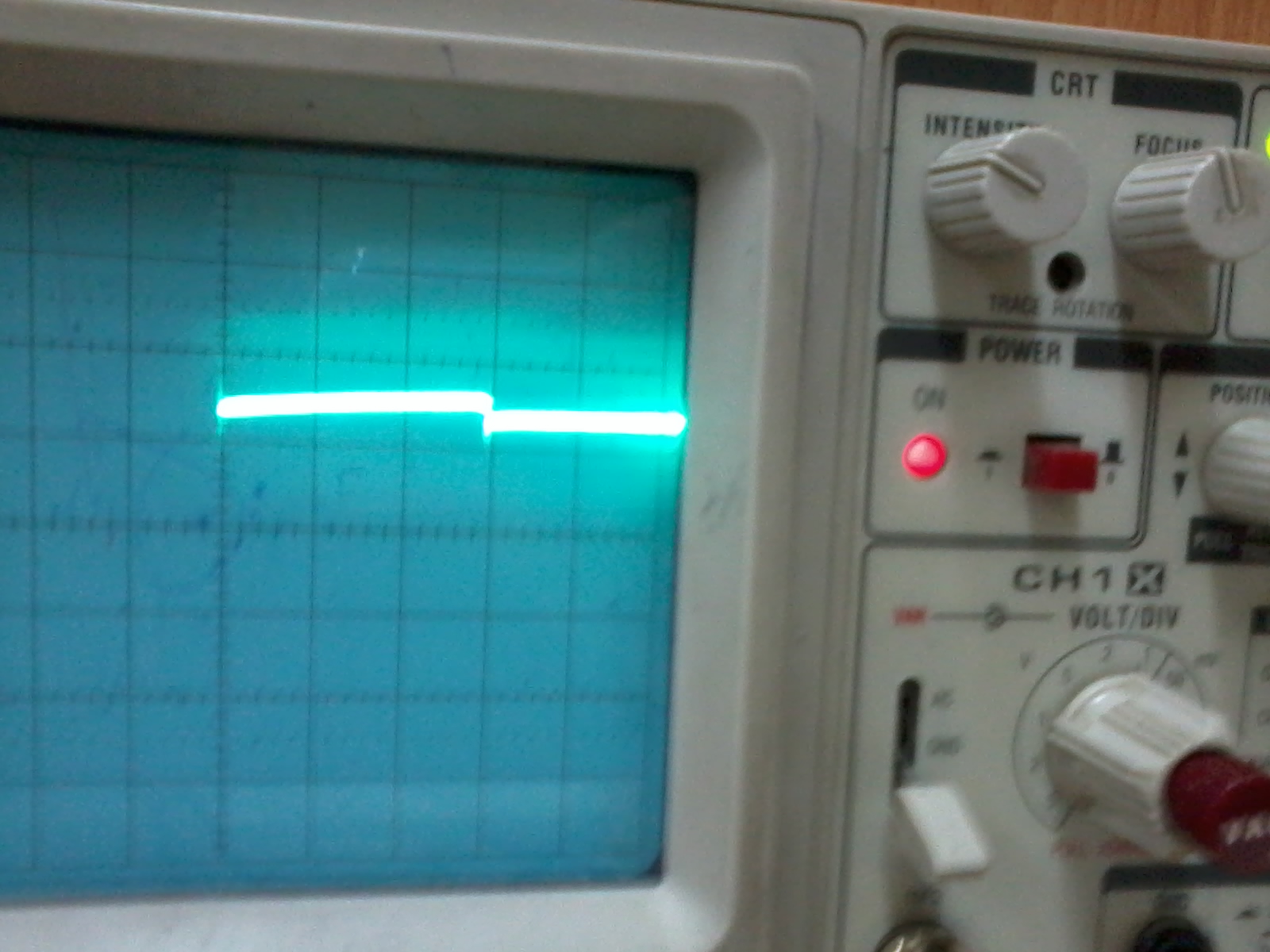

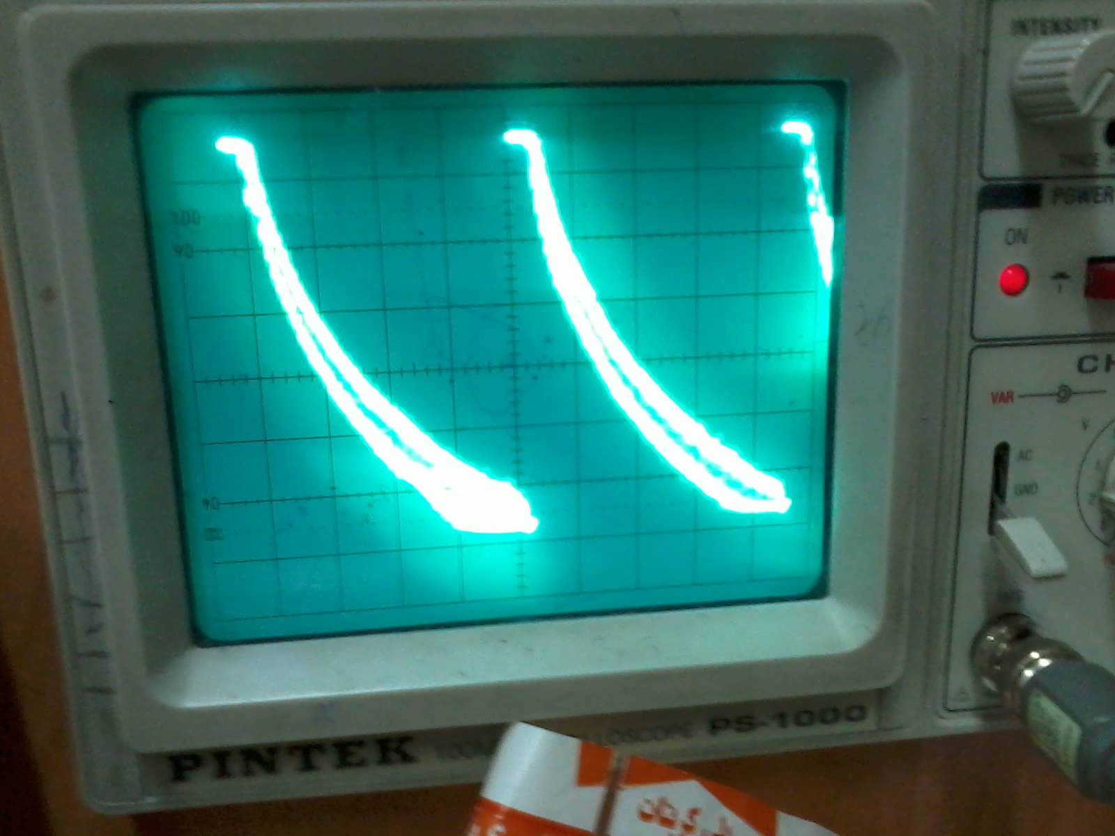

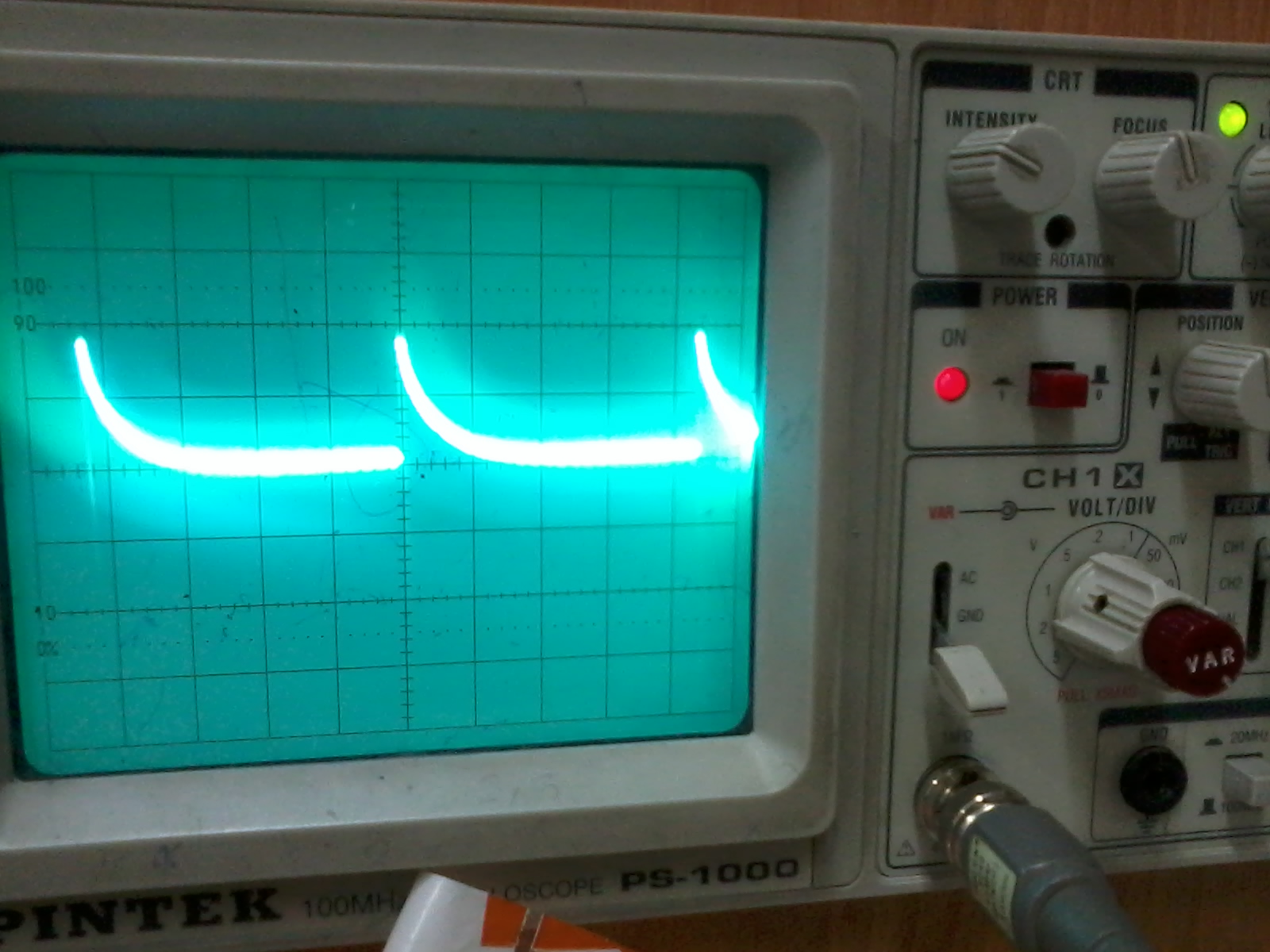

          • #95
            ok this picture for pin6 ne 5534(just you should know all of time the search coil was connect)
            you can see the ripple,why?
            and I think my problem in input of ne5534(pin3) how can i repair that?
Name:	2013-04-21 16.58.11.jpg
ID:	335938Click image for larger version
Name:	2013-04-21 16.43.02.jpg
ID:	335939Click image for larger version
Name:	2013-04-21 16.44.05.jpg

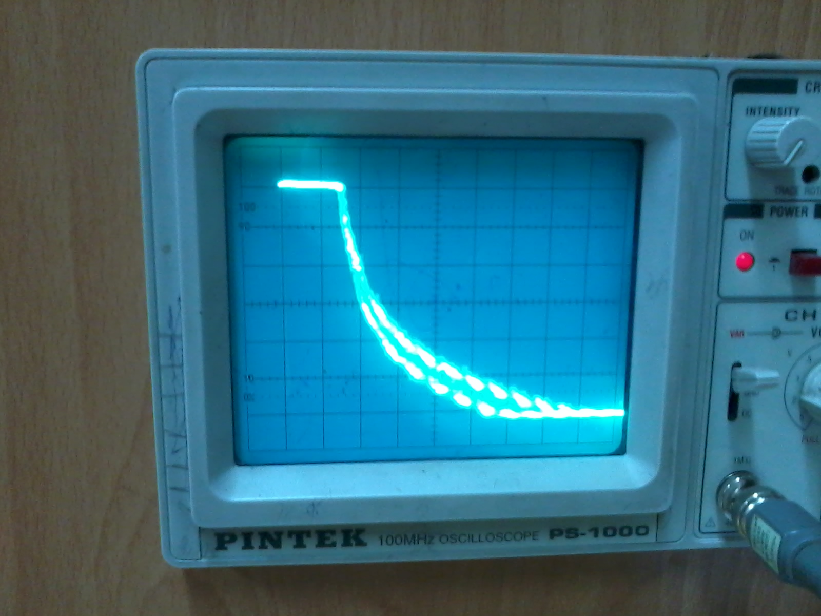

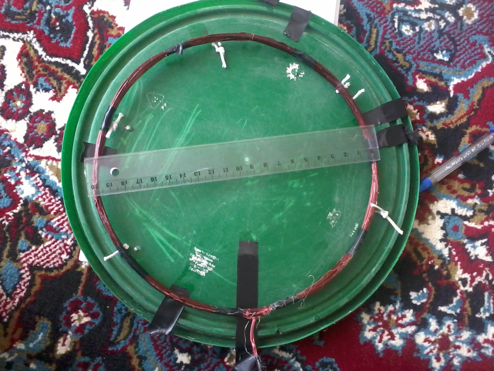

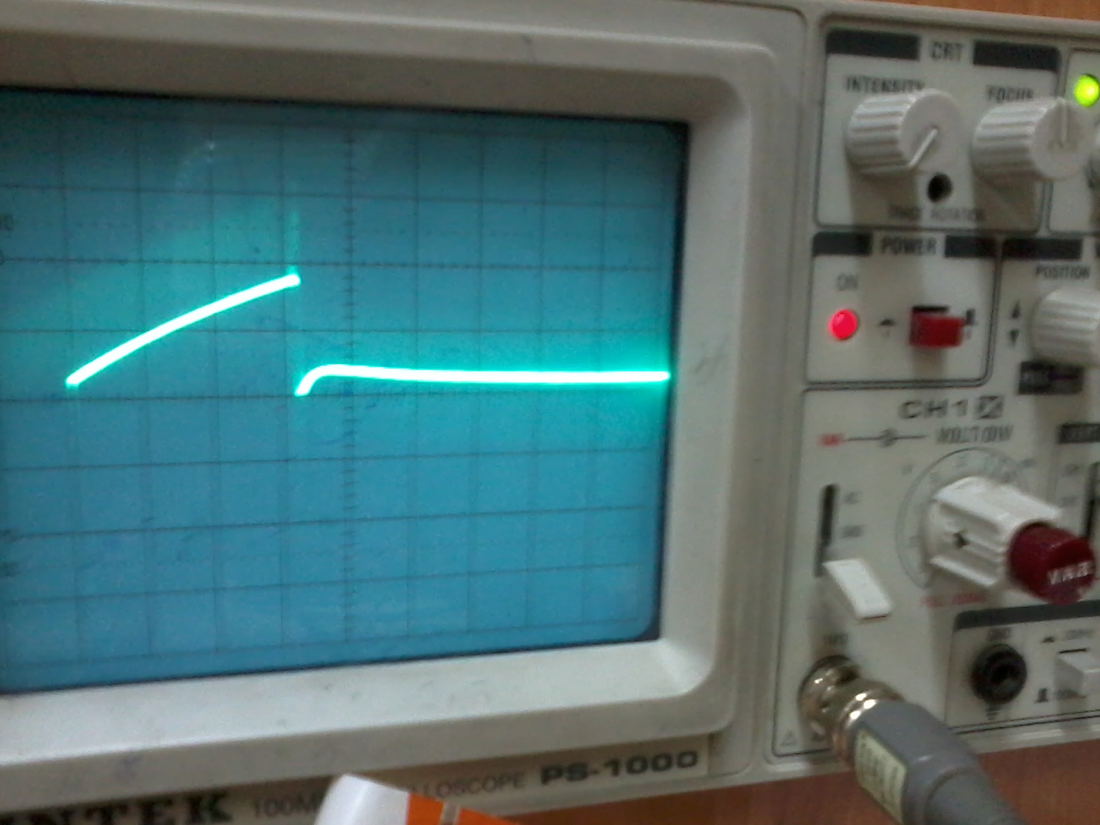

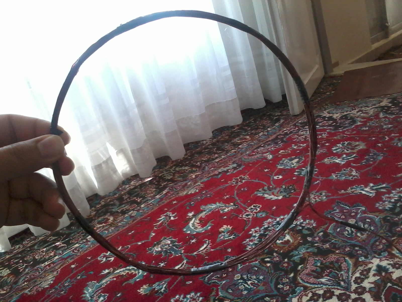

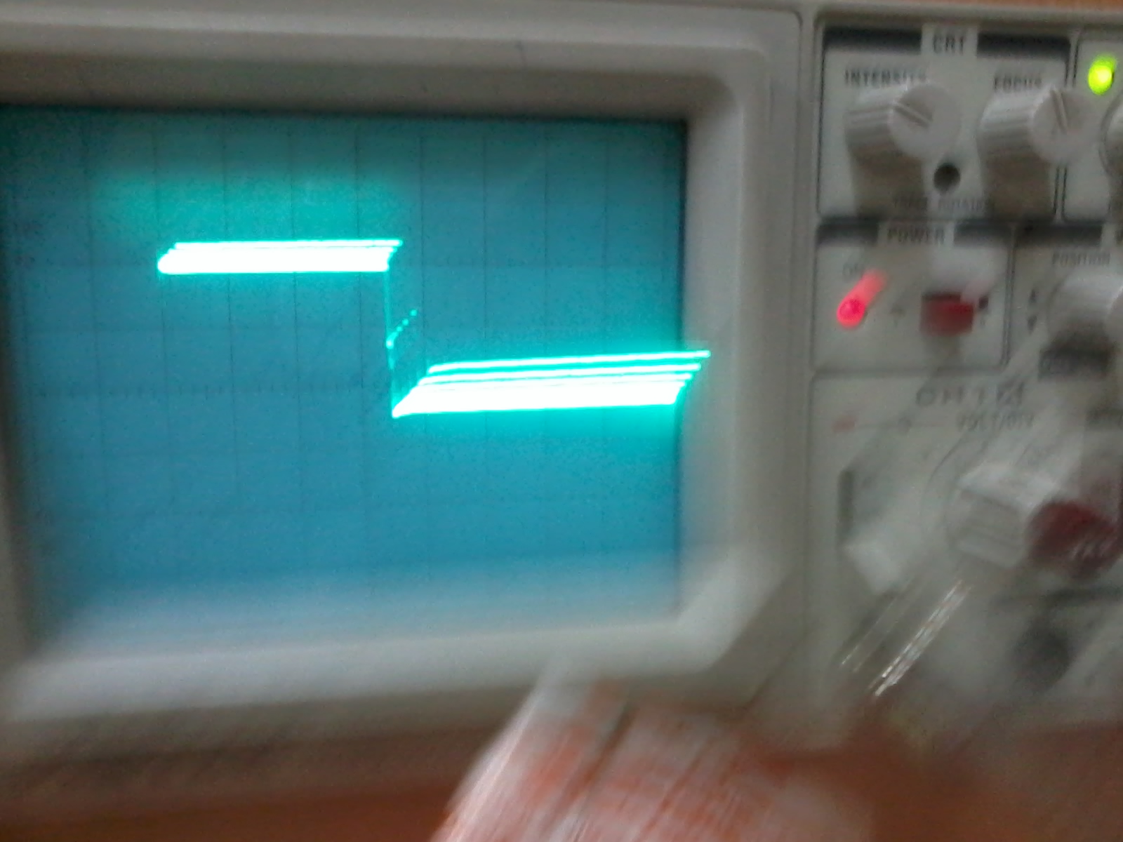

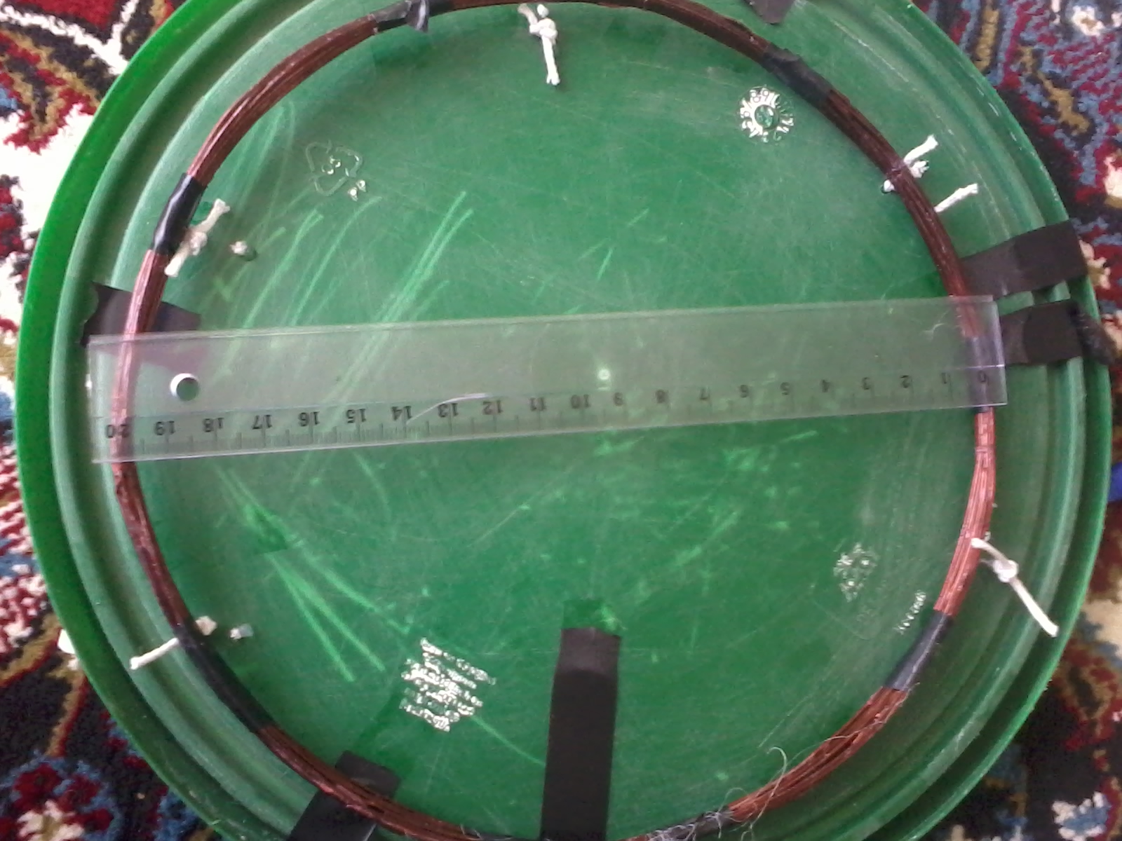

            • #96
              and for 4053:
              5. U2 4538.......Q5 colector..... Sa ...10v/ 50 mks... OK! YES IT IS OK AND HAVE 10 volt 50-60mks
              6. Q6 colector ........ Sc .......10v/50mks.....OK! IT IS NOT exactly correct have 8v and the waveforms (should have two 50mks)but the first wave is not good but second correct
              7. Q7 colector ............................Sb ........10v/50mks ....OK! IT IS VERY BAD ,this wave like ground wave(i put this picture)
              this picture for wave ground and pin11 4053.and other picture for my coil.
Name:	2013-04-21 17.18.49.jpg
ID:	335942Click image for larger version
Name:	2013-04-21 18.44.47.jpg
ID:	335943Click image for larger version
Name:	2013-04-22 11.07.36.jpg
ID:	335944Click image for larger version
Name:	2013-04-22 11.07.44.jpg
ID:	335945Click image for larger version
Name:	2013-04-22 11.08.04.jpg

                            Not possible, I don’t know what simple English is, just trying to write something understandable, English is not my native language either (as anyone can notice).
                            Problem that may confuse you in this design (typical for all delta pulse variations) is ground reference point. Ground reference, point to connect oscilloscope probe Gnd, or multimeter, GND as marked on schematic, is actually battery + voltage, regulated by LM2940 to 12V so everything is referenced to that point.
                            Check all voltages first, using multimeter, to see if you have -12V, -10V, -10.6V, -7V, +8V from that point, then check if all voltages are distributed properly on PCB.
                            Then connect scope probe GND to this point (detector battery powered, or PSU floated from scope GND) and re-check all points, pin3\555, C of BC337, C of BD140, waveform have to be regular square wave of 10V or so.
                            Next, pin 6 of 5534 is most important point. In post #95 it looks good, only scope GND may be wrong. At this point, you will see some small change if some metal is placed near the coil, DC voltage about 0V, scope set to DC. Same way, pins 11, 10, 6, of U4 (4053) must have square wave pulses present, this time +8\-7V. Seems to be OK from previous posts Next is to check TP 1, 2 5, for slowly varying voltage of around 0V in presence of metal (set RV7,8,9, to minimum, GND)
                            Rest of circuit is questionable, this is bit too complex for first project, not sure it is all correct. Even original delta is bit complicated, some experience using simple design like Surf or Barracuda can help. Too many things to go wrong with this.
                            Forget maps and all, this is more about schematics, can be even more complicated. No need to post too many waveforms, just describe problem.

                              Same way,pins 11, 10, 6, of U4 (4053) must have square wave pulses present, this time +8\-7V.
                              Ok #96 read it, i check last night my pcb and Q6,Q7 were ok but when i measure by multi pin6 near 8v,pin10 near -0.55an pin11 near-0.6, BUT wave of pin10,pin6 approximately ok Except pin11 that like GND wave.
                              and i should sure to Removal error or 4053 next i consideration other pcbs
                              are you download my pb design and check it??
                              thanks and regards
                              • I don't have Proteus, not checked PCB. Check if pulses are present on U3 pin6, if not, some error may be in 4538 timing part. If this is OK, and you have no pulse on 4053 pin 11, check transistor, PCB, two 10K resistor values, eventually 4053 (remove it and check pin 11)
