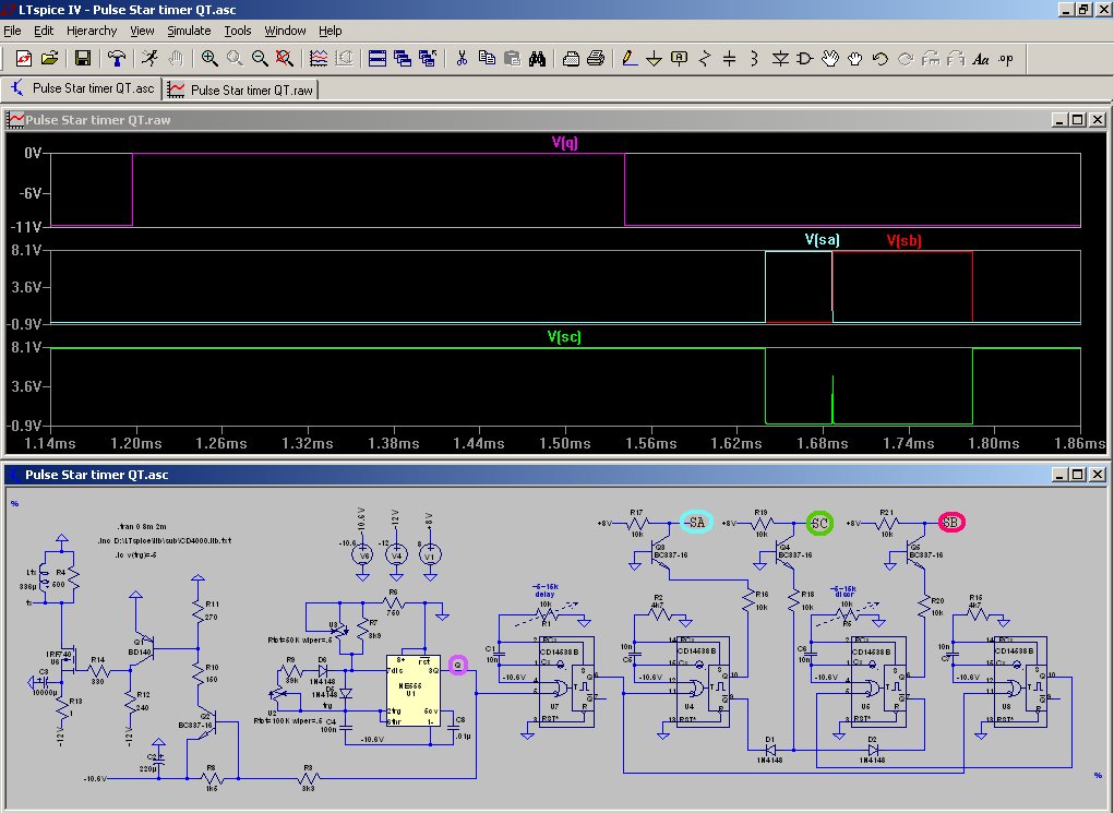

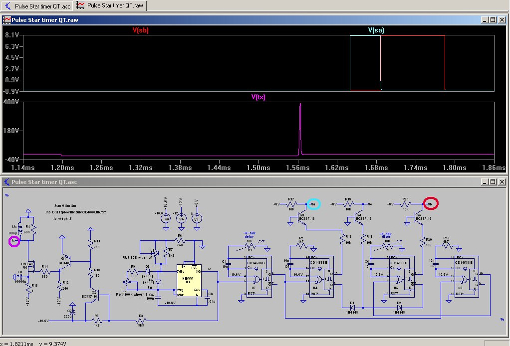

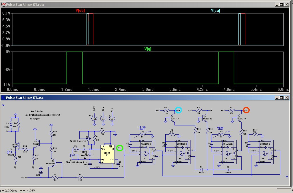

    Here is a screen shot from a simulation of the timer and tx subcircuits. (You should disregard my reference designators i.e. U1, R1, C1, etc. because they do not correspond to your drawing.)
    Pulse positions correspond to having your potentiometers set at ~50%.
    If you need something else probed in this circuit let me know and I'll try to accomodate.
    What the pin-14 discriminate pot does is change the pulsewidth of your secondary sample pulse, sb. With the components shown on Alex's schematic the secondary pulse would range about 47us~147us, depending on discrimination pot setting. In the simulation the R value corresponds to ~50% pot setting, and although it might be hard to see, the sb pulse is about 100us wide.

    • Mohandes, do your SA and SB pulses look right in relation to the 555 pin-3 signal? If so, then your 555 and the two 4538s are probably operating correctly.

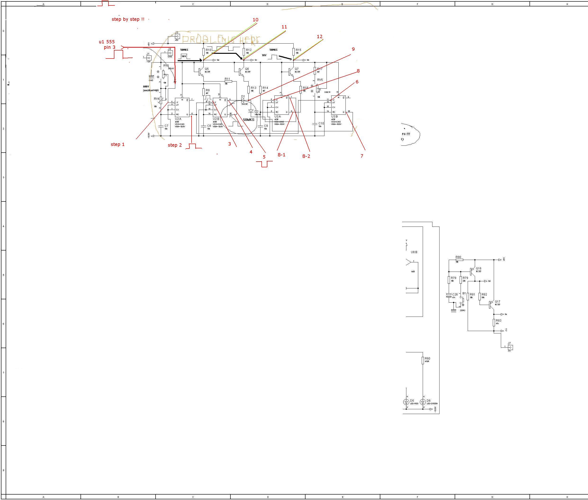

            mohandes , You understand ? STEP BY STEP!Click image for larger version
Name:	СХЕМА П.С   4538  step by step!.JPG

                    I do not think I said for you to put your pots at 50%, but that is what my simulation did, and it probably is a good idea for starters. The pulse timing formula for CD4538 is simply t=RC so there is not really any need to simulate at more than one pot position. To do the math is simple.
                    Signal sc is the (inverted) sum of sa and sb.
                    The 4538 Q and /Q signals are complementary outputs (pins 6,7 and 10,9). As one goes high, the other one goes low, with a duration according to the timing formula.
                    If you probe sc and determine that its duration does not equal the sum of sa and sb, then you should make sure the two diodes are oriented correctly.

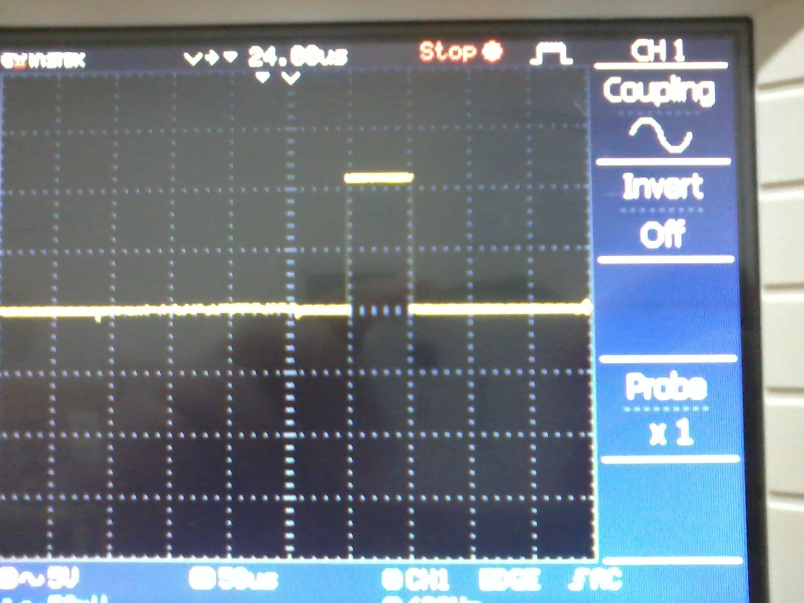

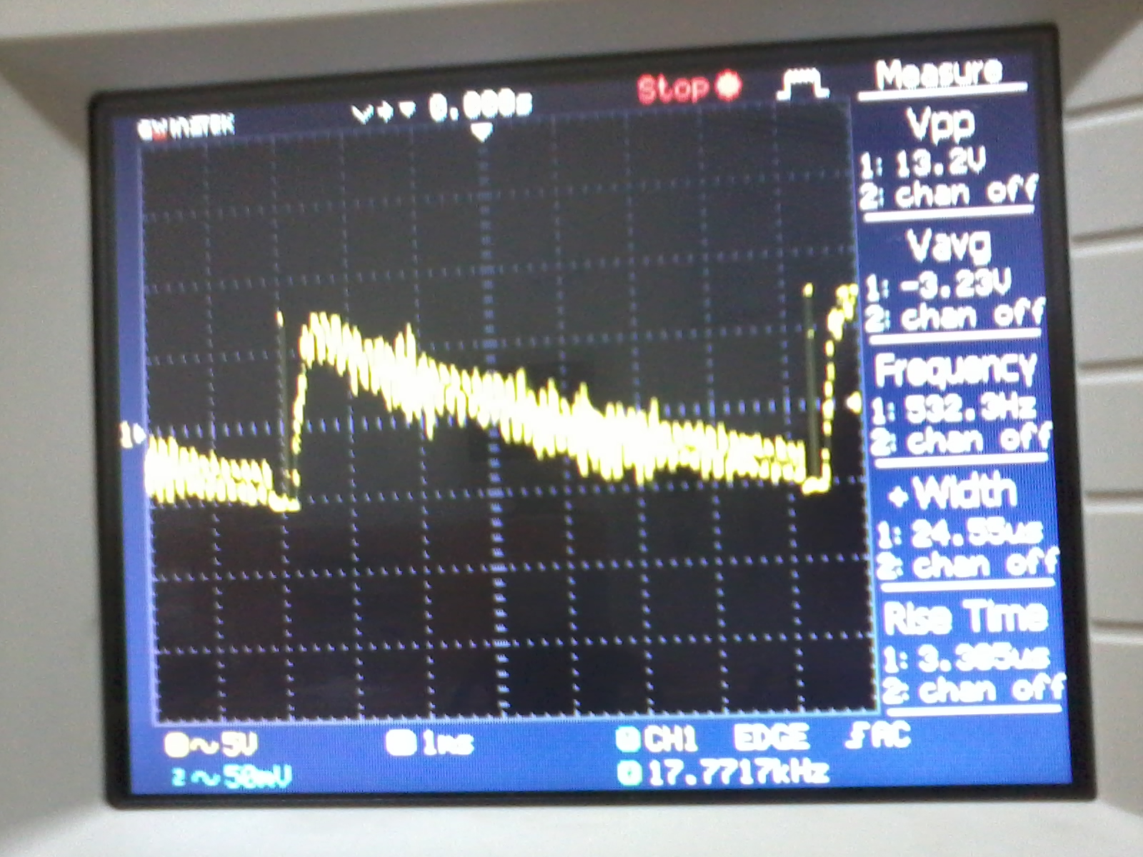

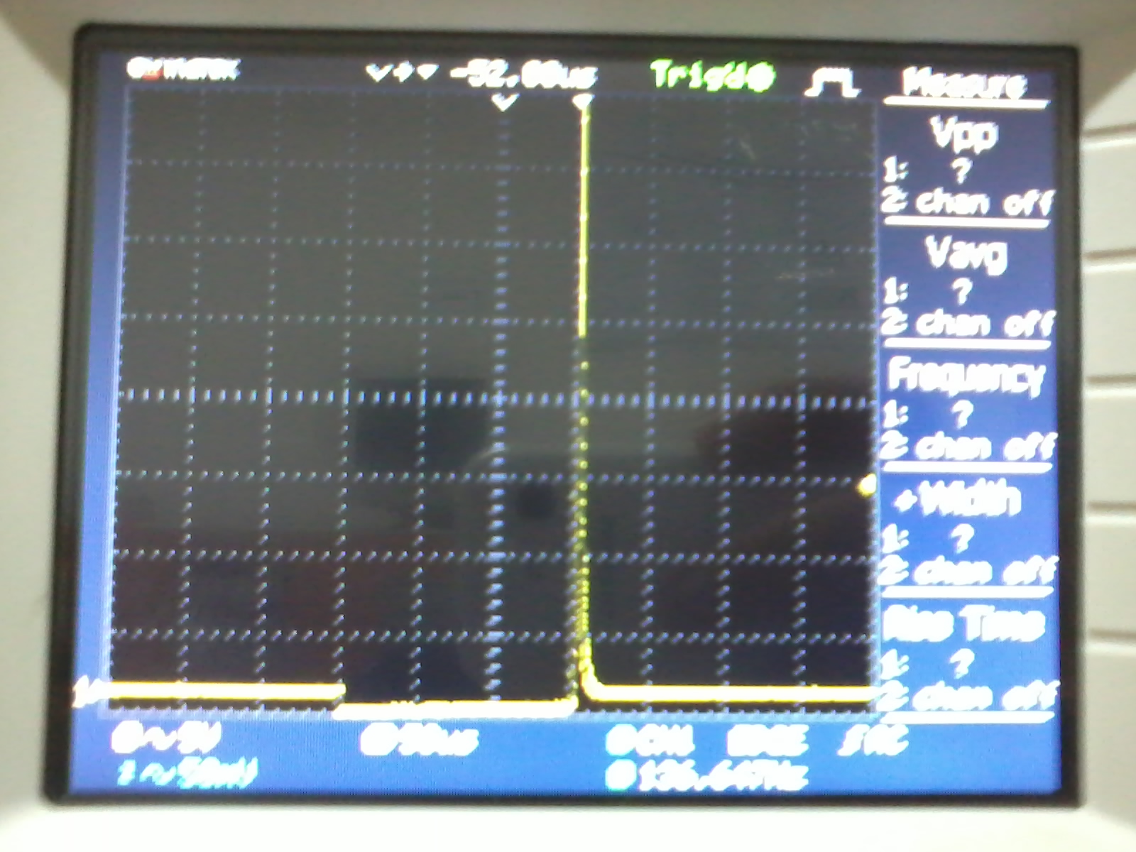

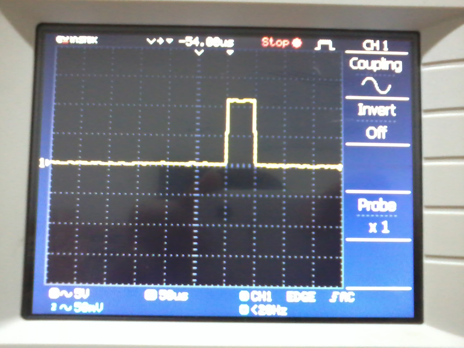

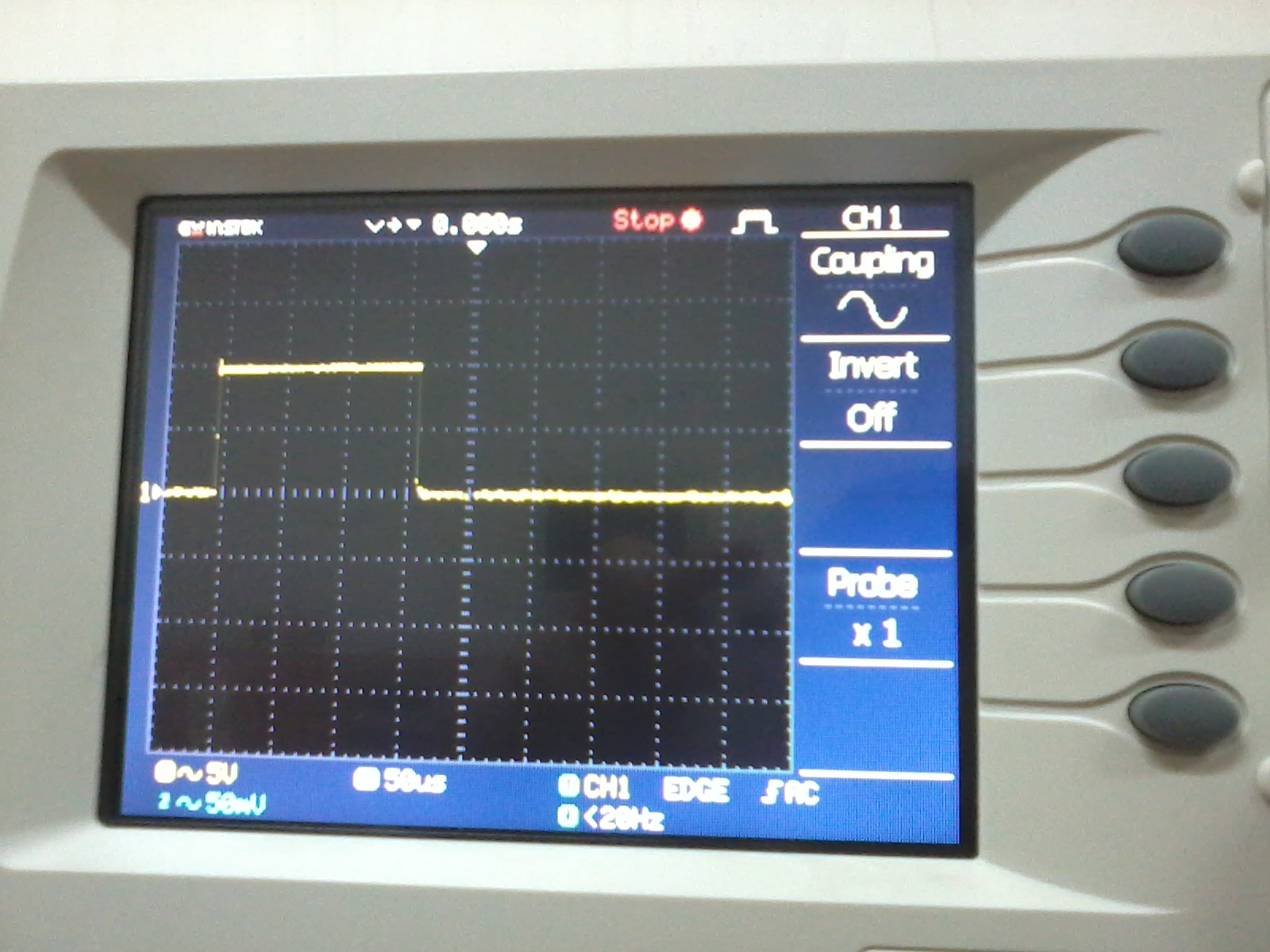

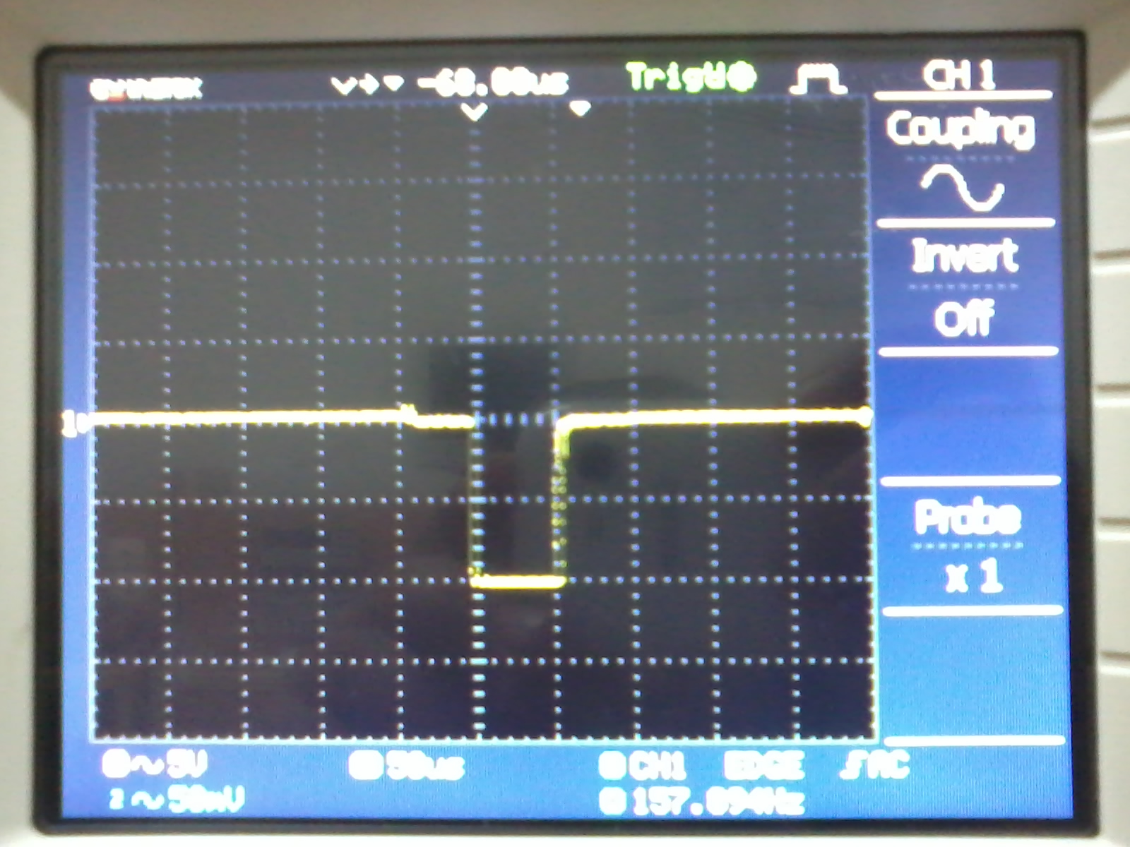

                    • hi guru
                      look and give your opinion
                      look ,i work like said in your picture,again step by step
                      this is step by step,just secon picture for pin6,11,10 frist 4538
                      step1,step2,3,4,5,6
Name:	pin3 ne 555.jpg
Name:	pin6,11,10 first 4538.jpg
Name:	pin9 first 4538.jpg
Name:	2013-04-29 16.59.27.jpg

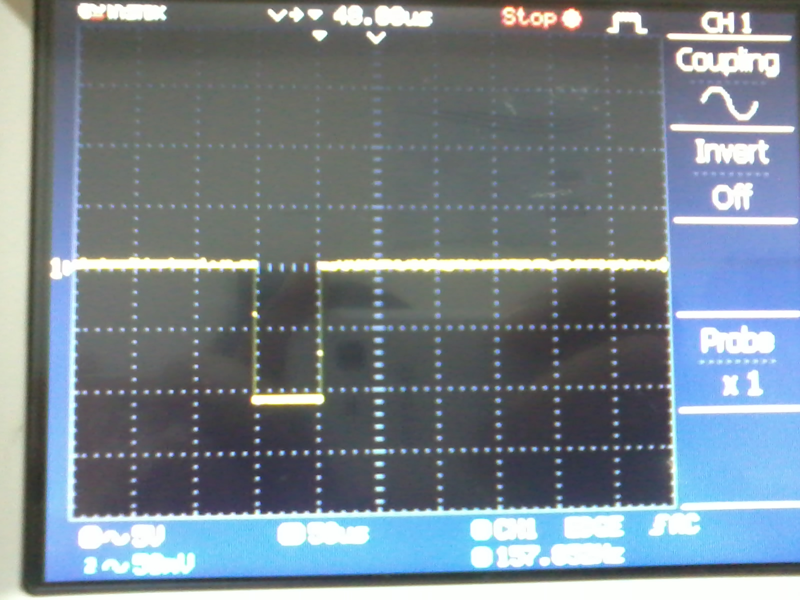

                      • and Continuation
                        step7,step8,step8-1,8-2
Name:	pin10 se 4538.jpg
ID:	336047Click image for larger version
Name:	pin5 se 4538.jpg
ID:	336048Click image for larger version
Name:	pin6 se 4538.jpg
ID:	336049Click image for larger version
Name:	pin7 se4538.jpg

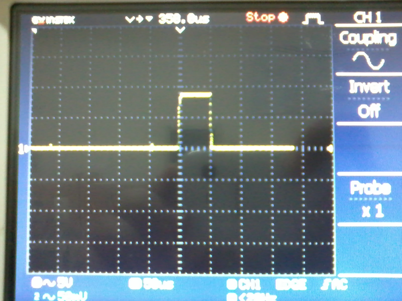

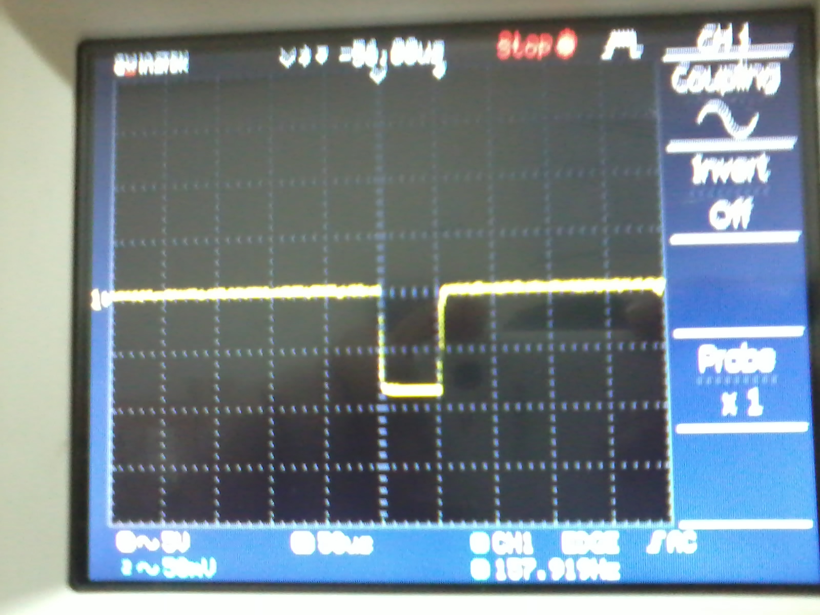

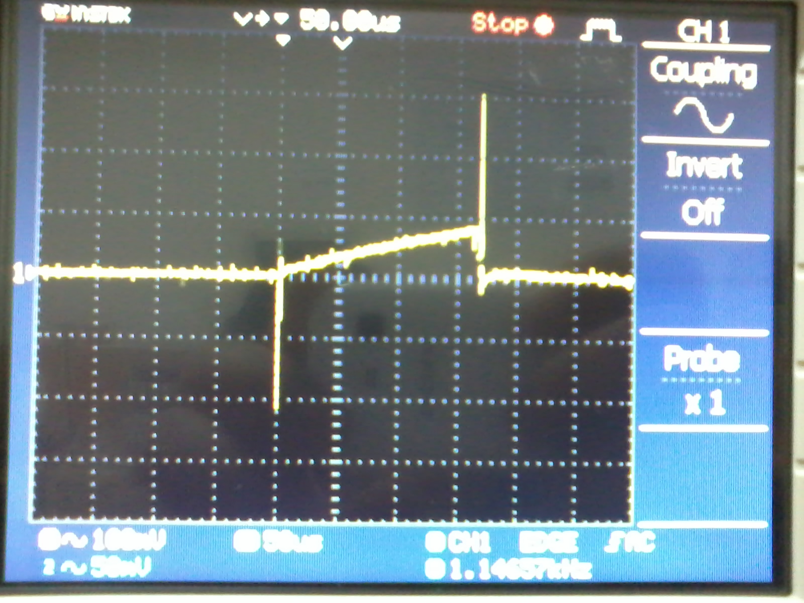

                        • ok the finally
                          step9,step10,step11,(i forgot take picture of step12 but it is yet bad )
                          and another picture after step11 are for drain of irf740
Name:	between 2 diod 4148.jpg
ID:	336054Click image for larger version
ID:	336051Click image for larger version
ID:	336052Click image for larger version
ID:	336050Click image for larger version
Name:	2013-04-29 18.44.15.jpg

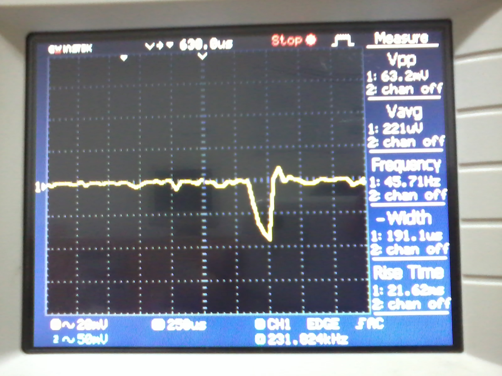

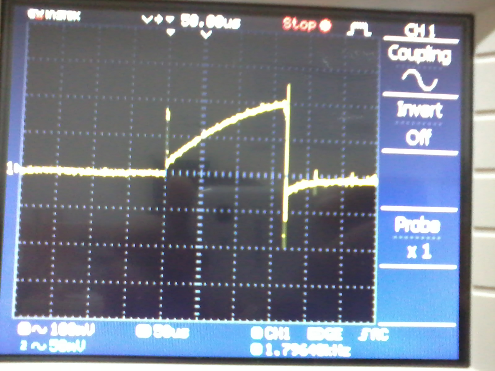

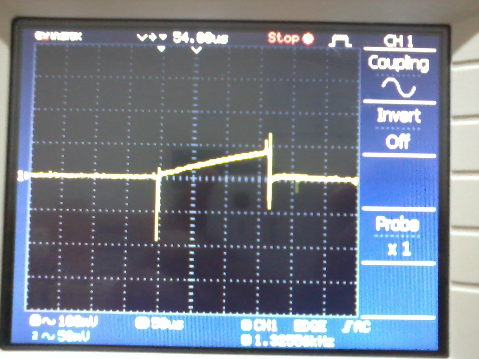

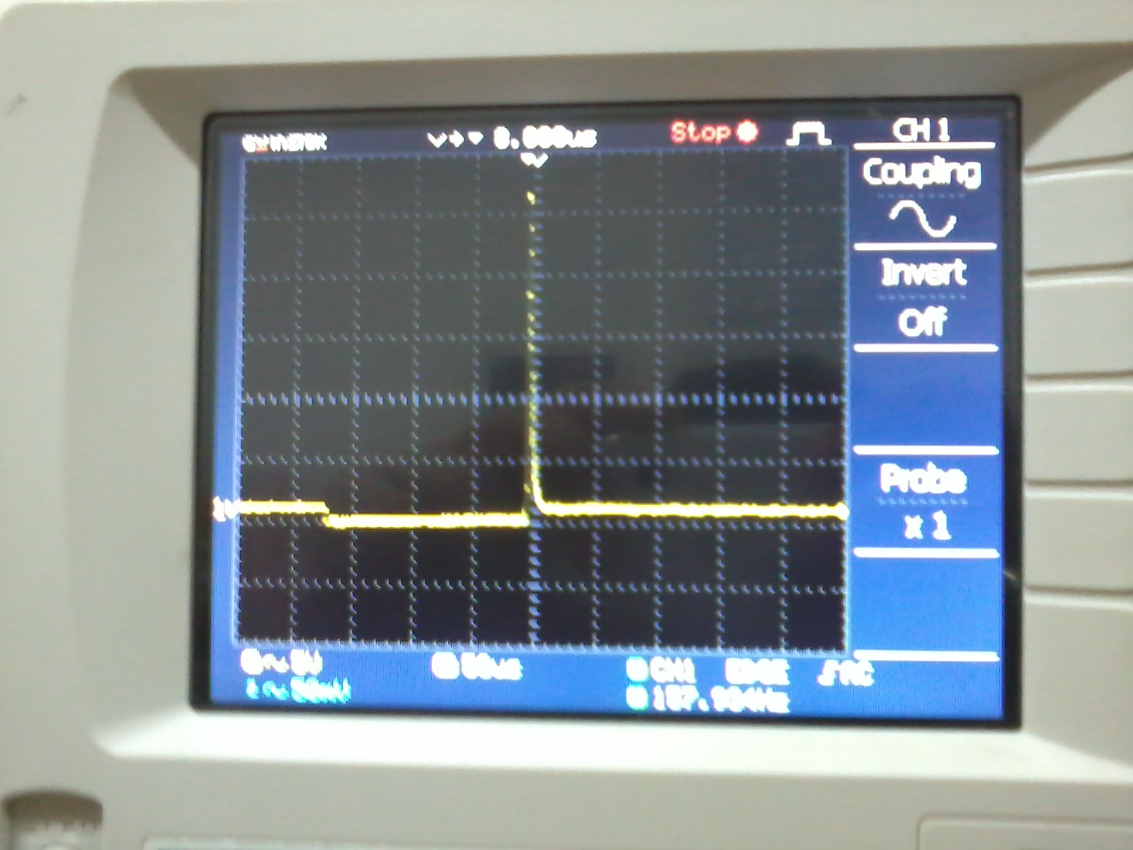

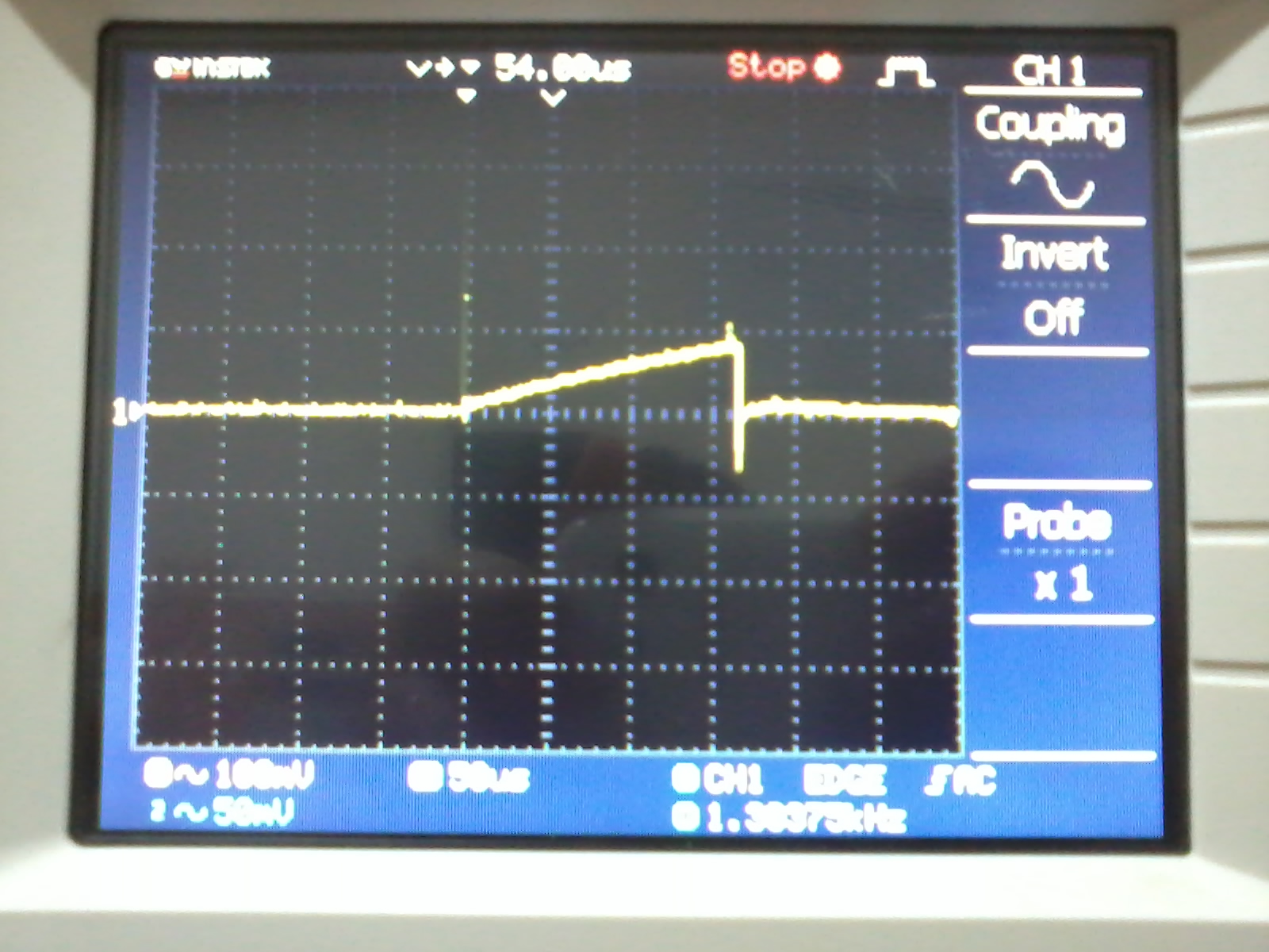

                          • Hi
                            this figure for wave of GND and pin6 ne5534.
                            mr porkluvr
                            i
                            return multitern(discrimination)and sb dont change ,also sa and sb dont change when the output of 555 is changing.BECAUSE i am sure my problem in U3(second 453
                            you say maybe one 4148 destroyed but when in pin 9 second 4538 not output how is it work?
                            i put my picture step by step and waiting.
                            thanks
ID:	336056Click image for larger version

                              It is really hard to analyse what you have. Too much, umh, information.
                              Please, it would be helpful in the future if you turned the oscilloscope intensity down a little bit so that the scope trace is not so bright and blurry. I know your camera has some blurriness, but turn down the scope intensity.
                              Listen up, this is important:
                              You MUST take advantage of the oscilloscope having two channels. Use two probes, one for each channel. It would be informative if the scope be set to trigger off the signal on ch1. The ch1 signal trace position should remain stationary. Then, whatever is probed on ch2 can move left or right (as you turn the pots) and be viewed in temporal (time) relationship to ch1. Otherwise, you cannot see temporal relationships because you have no temporal reference.
                              Otherwise if you use only a single channel, while you can see if a pulse gets wide or narrow, you will not be able to see if one pulse is moving in relationship to another.
                              When you use two channels then you will be able to watch relative movement between the two signals being probed. So... if you only have access to one single probe, then you really do need to beg borrow or steal, to obtain another one!
                              Time out, and I'll look at what what you posted to see if I can see anything telling.
                              • I have reconsidered my last post. I suppose you have your hands full, trying to follow the signal flow on the PS-G.
                                Just do what you can with a single probe. But, understand that you are losing a huge portion of your test instrument's functionality by doing so.
