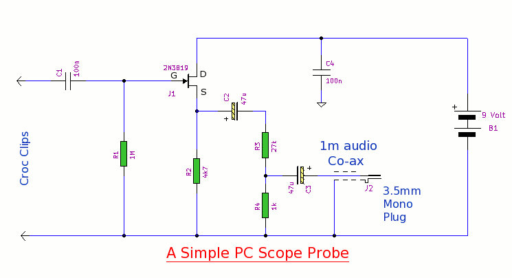

    Hi 6666
    A problem you may experience using Mic input of a pc is its low impedance so try this out, Its a simple FET follower which will attenuate automatically by a factor of 30, it has high input impedance and low output impedance which will match your PC sound cards, should do the job nicely .
    • #47
      Hi Dave
      Thanks for the cct, I have only been using Line In
      as it will tolerate a higher input level.
      Cheers
