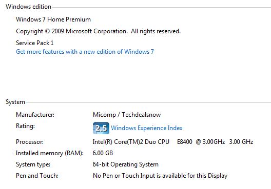

        • #64
          Here is a pic of my pc showing whats installed
