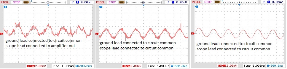

      I've been seeing oscillation around 500kHz at amplifier out. Shows better with input shorted(no coil pickup noise). Tried to find why yesterday. Still had oscillation with scope probe and ground lead connected to scope common. Oscillation is 100MHz with low time base. Aliases to about 500kHz when time base is long enough.
            This is common mode noise probably being picked up in the probe ground lead. It could be coming from a local radio station or other HF appliance in or near the house.
            Assuming you are using a scope probe connected directly to your DUT, try using a shorter ground lead. Also try the 20MHz limit on the scope.
              Not sure what causes the 100MHz. Did a scope calibration and think the 100MHz amplitude reduced in half(should have stored before and after but didn't). Just tried looking at it again. Still have the 100MHz. Scope still aliases down to about 500kHz. Don't need more than 20MHz, so turning 20MHz limit on is probably a good idea. Wondering why I see 100MHz when the scope is rated 50MHz.
              See the 100MHz with shorted probe touching scope common also, doesn't need to touch detector circuit. 20MHz limit reduces signal but doesn't eliminate it.
                  It is likely a local FM around 104 Mhz station. Even though the scope has bandwidth of 50 MHz the roll of is not brick wall. Since this same model is offered in high bandwidths they likely just limit it to 50 MHz with a single cap so it will only be down about 9dB at 100 MHz. Slowing the sweep speed does NOT reduce the bandwidth. Because it reduces only the sample rate it just introduces false aliases into the signal caused by UNDER sampling the signal fewer than 2 times per cycle. See post 82 for more detail.
                  Shorting the probe tip to the ground lead still has a short unshielded wire which acts as an antenna. Try removing the probe tip and see if you can short between the tip itself and the ground point on the probe. Better yet if you have a BNC shorting cap put that on the input of the scope or otherwise short from the BNC center to the outer ring with an exacto knife or similar.
                  If you still see the 100 MHz if could be.
                  1. Poor common mode rejection of the input amp.
                  2. Poorly shielded probe cable.
                  3. Conducted emissions entering via the power cable.
                  4. Internal oscillations or noise pickup within the scope.
                  For a Pi you should always leave the bandwidth limiter on.

                      Don't see the oscillation when I short the probe with the ground lead. Need to touch the shorted probe to scope ground to see about 2mV p-p oscillation at about 100MHz. There is a 100.5MHz FM station in the area, not sure where the antenna is located. 100.5MHz aliasing at 500kHz would match what I see.
                      The problem started when I saw 500kHz at amplifier out. 500kHz at amplifier out is possible. 100MHz when scope is switched to shorter time base at amplifier out not likely. Wondering why.

                        What ground, the PI ground? That is not really ground, that is an antenna!
                        To be fair even earth ground is not really a good ground. Earth ground is there for safety purposes, not EMI reduction.
                        While ferrite beads on the leads properly applied may reduce this interference the best solution would be differential amp with high CMRR at high frequencies. Such a solution, while available, is very expensive.
                        One solution you could try, which will probably not work, is to use pseudo differential.
                        Ideally you use 2 x1 probes or possibly 2 pieces of coax with BNC's on one end and bare leads on the other. Solder the cable shields together at the DUT end and apply the signal between probe ch1 and probe channel 2. GROUND IS NOT USED at the probe end. Bandwidth limit BOTH scope channels. Put the scope in add and invert mode so the trace display is CH1-Ch2. you may find, if your signal is repetitive, that signal averaging will help.
                        One last alternative is to repeat the above with Z0 probes. to do this you must have the scope inputs terminated into 50ohms. The easiest way to do this if the scope does not have 50 ohm selection is to use BNC terminators.

                          Don't need to connect shorted probe to PI circuit. Connecting shorted probe to scope ground is all that's needed(scope calibration common terminal, scope input common at scope as examples). Now that I know it's there I can live with it but would like to know why and if the 100.5MHz FM station is the source. Before I found the 100MHz I was spending a lot of time trying to figure out where the 500kHz was coming from.

                                Green sorry the response is the same. The scope chassis is not super quiet.
                                Try this. Connect a 36" piece of wire to the probe center conductor and place it well away from any device , including the scope, does the noise increase? Also try the other solutions. The Z0 probe may well work because it has a low input impedance. It does require that your device be able to drive a 450 ohm load though.
