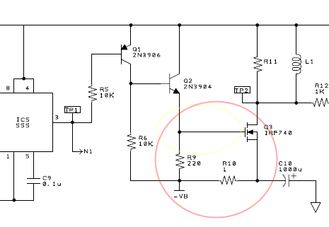

    The current design of the MOSFET coil drive looks like this:
    The IRF740 has an input capacitance of 1400pf. The discharge time through R9 (229 ohm) is about 500ns.
    The design is charging the MOSFET's capacitance through a low impedance (emitter of Q2) and discharging it through a higher impedance (R9). So we have a fast turn-on and a slower turn off of the MOSFET. But the opposite should actually happen.
    The turn-on time is not critical because the current in the coil increases slowly anyway (at a rate V/L), so a fast turn-on has no advantages. The lower impedance should instead be used to drive the gate of the MOSFET low for a fast turn-off and a better target signal. This can be accomplished with the simpler circuit below:
    The on-resistance of the BS170 is 5 ohm maximum, so this allows for a much faster discharge of the IRF740 gate capacitance that the original 220 ohm resistor.
    P.S. I overlooked the fact that the 555 and the IRF740 have different ground references, so some level-shifting must precede the BS170 stage. But you get the idea anyway.

      I haven't seen that on the project page. Anyway I thought it might help others with tuning their old designs.
      By the way, do you know what schematic this drawing comes from? I'm intrigued by Q2 and accompanying resistor and diode.
        Thats one of my circuits, Q2 and a few other components around it act as a flyback blocking circuit (this is used in place of the typical 1k resistor and two diodes method). Another
        user here called Moodz designed the circuit.
        I haven't used this circuit for ages due to limitations. My detector now uses a micro to control Q1 and Q2, plus samples.
