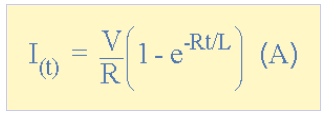

    The transmit current in current PI design have either a triangular or a trapezoidal shape due to the slow rise time of the inductance (V/L * t).
    For a given coil, as the TX pulse gets shorter (T1 ... T5), the maximum achievable value of the TX current decreases like this:
    Now I've designed a circuit capable of generating current pulses of a rectangular shape down to microsecond scale, like this:
    Are there any advantages in a short, rectangular current pulse? for example: ground rejection, small object detection (large object rejection), or anything else?
    Would it be worth the effort to go for such a design or is it just a waste of components and time?

      That applies to the turn-off. The tun-on is more linear and is ramp-shaped because it occurs at a constant voltage: V/L * t; if you neglect the coil's resistance. The damping resistor in parallel has no effect on turn-on.
      I can go around this and do a sharp turn-on. This allows shorter pulses witout decreasing the peak current, but I don't know if it's a desirable feature or not.

      I apperciate the suggestion, but Hammerhead and all PI's I know use a trapezoidal/triangular current waveform (turn-on is a ramp) with the problem of limiting the peak current available for very short pulses.
      My approach allows the peak current to be the same regardless of pulse width. My question: is a short, square pulse at peakcurrent a desirable feature or not? would it improve PI performance for certain applications?

          The targets are roughly equivalent to LR circuits. Diferent targets hace different time constants. As the magnetic field turns-on eddy currents are induced in the target. If the field is switched off before the turn-on eddy has had time to decay, both eddy's cancel each other and you dn't get a target response. So the TX time can be used as target filter, shorter TX leaving larger targtes non-responsive. My aim is to detect small gold nuggets, which have shorter decays while avoiding magnetic ground that has longer decay. So I thought making the TX time as short as possible can help... but the turn-on ramp was in the way and I have fixed the problem.
            Also, peak current will be limited by wire resistance anyway. Or are you suggesting multi period sensing?
            I want the peak current to stay the same for both long and very short TX times. This is not possible with current designs due to the turn-on current ramp. Currently you can only get lower than peak for short pulses.
            I've found a way to eliminate the turn-on ramp, then shorter pulses are possible because the peak current is achieved almost instantly, you don't need to wait for a ramp to complete before turning off.
            I believe this way ground response can be reduced and larger objects too (usually iron junk if you're lloking for gold nuggets).

                This is equal to a constant current drive, and in effect the same as a current Whites patent signed also by Eric Foster himself, and that was a mild surprise to me. He did not strike me as a patenting kind of guy.
                Now, to achieve a constant current from a get-go, you'd have to initiate it by an equivalent of a flyback pulse. There are generally two ways to do it, either by a high voltage source, or by another coil discharge. After initiation a coil is short circuited to maintain a constant current, and avoid power consumption, or much more wastefully by maintaining a constant current by voltage source and a current limiter. In any case, the process is finished by cutting the current altogether to produce a normal flyback, of opposite polarity than a charging pulse, followed by detection.
                Now, your question is whether shorter charging pulse has any benefits. In short: no.
                Because charging pulse and flyback pulses are of opposite polarity, if close to each other, some of target activation is lost, especially of longer tau. If charge and flyback pulses are further apart than a target tau, you will not be able to notice any difference. Somewhat more dramatic difference will happen with GB response that has a knee at a time after flyback equivalent to the charging period, and you'd wish it gone if you are after a perfect GB solution.
                Duration of flyback is often debated, but with targets in mind, you can say that flyback duration is of negligible importance as long as it is shorter than the shortest tau, and it is as energetic as the integral of its shape. Taming a flyback makes sense as avalanche effects tend to be noisy, but that's another story.
