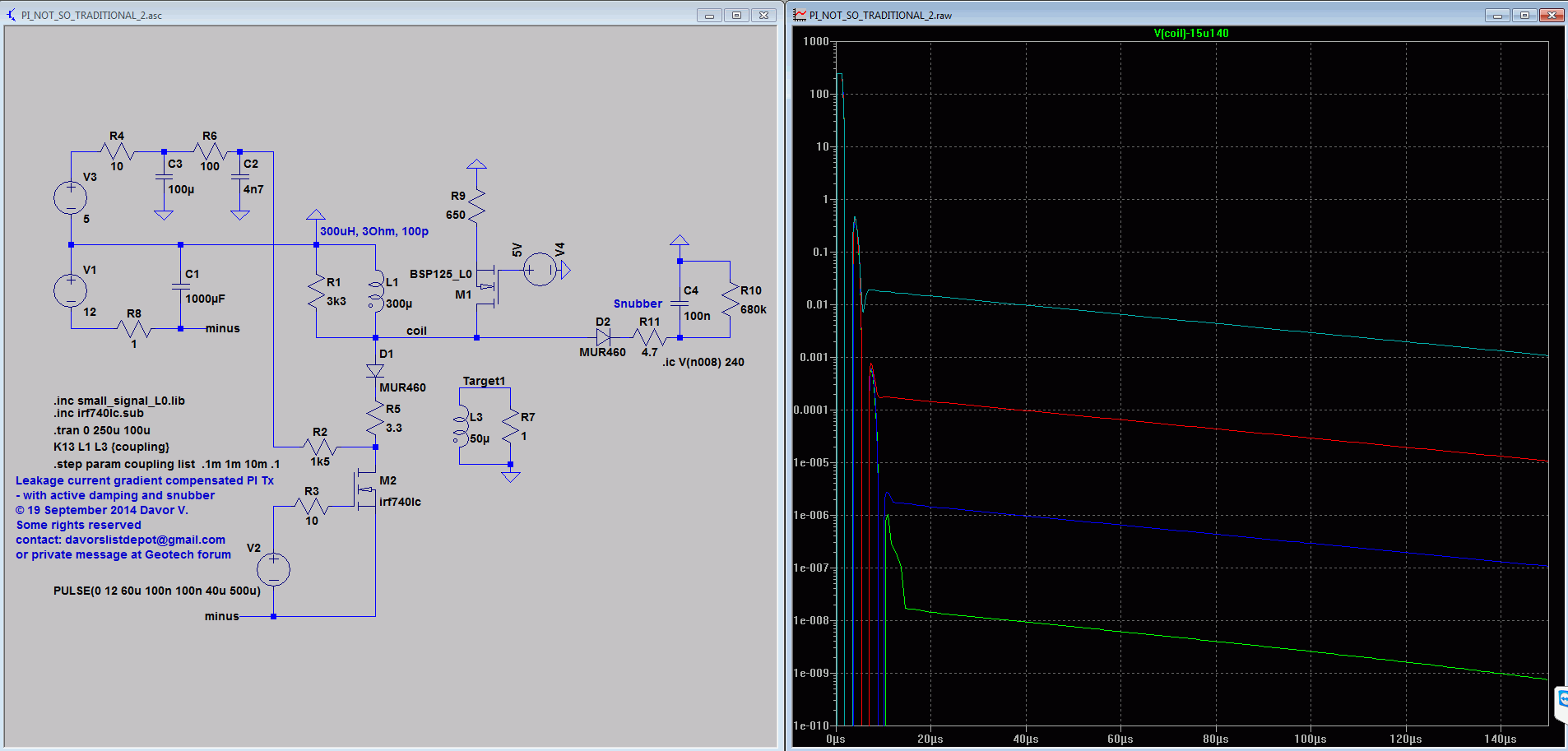

      I appreciate very much your detailed comments. I'll go a bit into them.
      You're right, R9 is misplaced. Actually with BS170 you don't need it because it's RDSon is about 12 ohms.
      Regarding the CC MOSFET, the D-S recirculation diode would conduct a high current when the driver MOSFET is on. You can block it by adding a diode in series but that causes ringing at the end of the flyback transient when the diode is high impedance.
      Another option is what I did - referencing the CC MOSFET to ground - but this requires a level shifter to maintain the voltage at the coil a little below V3 when the CC MOSFET is at lowest resistance (end of flyback). I used a zener for ease of simulation but it can be anything with a constant voltage drop between terminals (but is must react fast).
      A third option is connecting the source of the CC MOSFET via a diode to a voltage source a little under V3. This way the two requirements are fulfilled: the diode is never closed and the D-S diode cannot conduct.
      As to placing R6 as a source degeneration resistor, a current source of 0.5A would require a gate voltage over 50V.
      My target is 100 ohm resistor at near-zero coil current (milliamperes) and the CC MOSFET sinking about half the top coil current. This way ringing is avoided and the coil does not end up shorted so you can measure the voltage signal.

        Actually you want a constant current thing start clipping at about 1V, and if a damping resistor is at 1k, your goal current is 1mA.
        Try not to involve any level shifters as they do not work well with analogue circuitry. A slight change in offset will obliterate all weak signals.

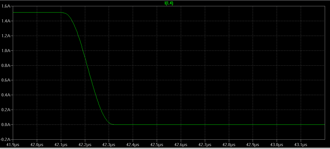

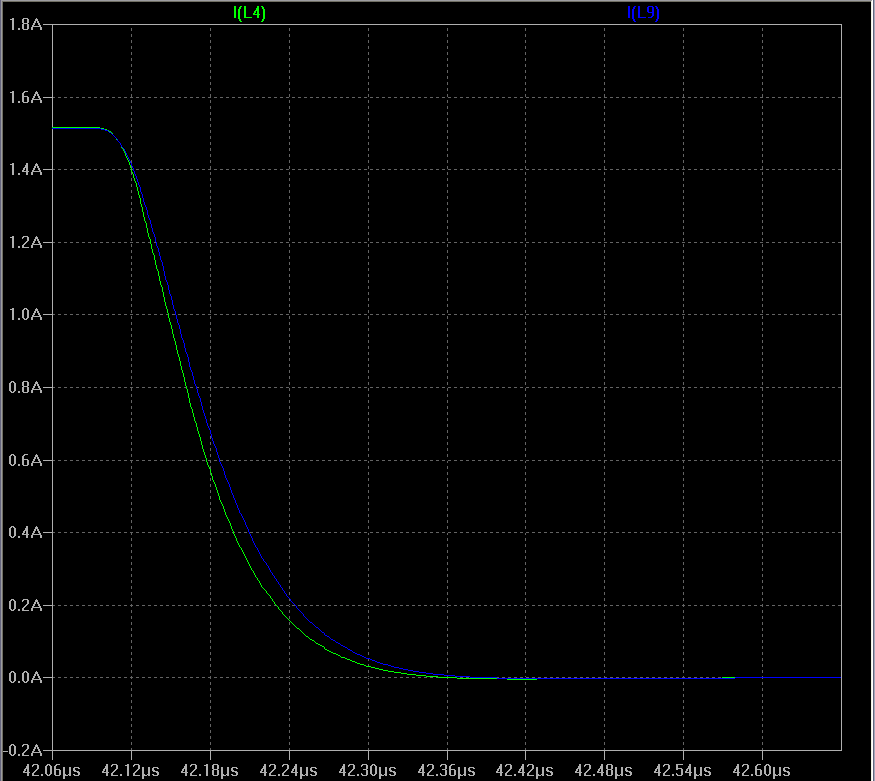

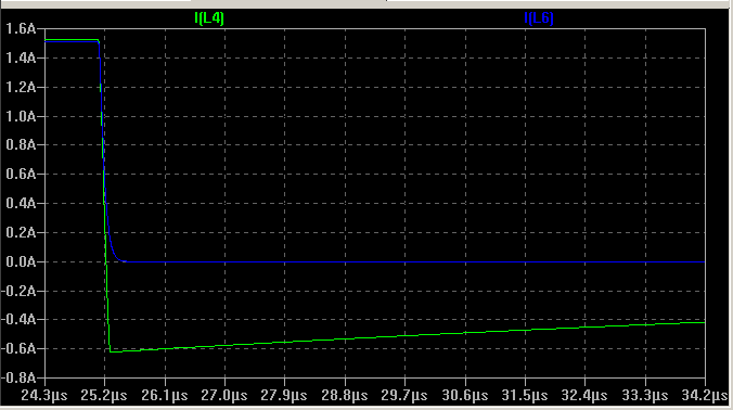

          Let's say instead of damping we short the coil at zero crossing. The current swing almost doubles (from 1.5A to 2.1A) in the shortest possible time and in a linear discharge, followed by a slow decay to zero at V/L*t. The signal induced in the target at goes from 45mV to 72mV. It's a lot of gain, but the only way to measure it is an Rx coil because the Tx coil is shorted. Depending on coupling coefficient the Rx coil could spoil the whole scheme.
          These are the coil currents, L4 is shorted at zero-crossing, L6 is just critically damped.

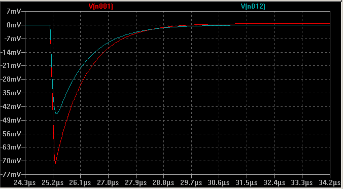

          These are the target signals:
          Voltage across L4 is zero, no way to measure the target's response in L4. Only way out is an Rx coil.
            With voltage input Rx a short circuit is meaningless in case of a monocoil. IB configuration is a completely different animal, and it makes a lot of sense.

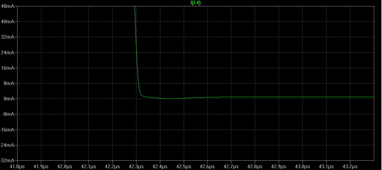

            Input referenced voltage noise is your measure how deep your detector will go, and it is referred to a source resistance, and not Rx input impedance. It is beneficial when a low impedance source is connected to a preamp of adequate noise performance, but also of high input impedance. The best noise performance is NOT achieved by matching impedances.

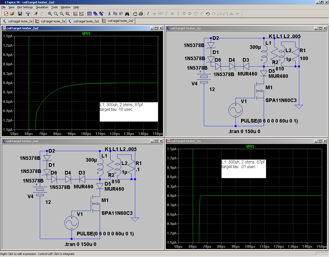

              I quickly combined MOSFET active damping (as I explained earlier) with a accelerating diode and also my damping circuit, and got exactly the same response as with only a diode. My conclusion is that active damping is a waste of time, especially if gate is driven by any kind of decaying voltage, as it screws up small signals.

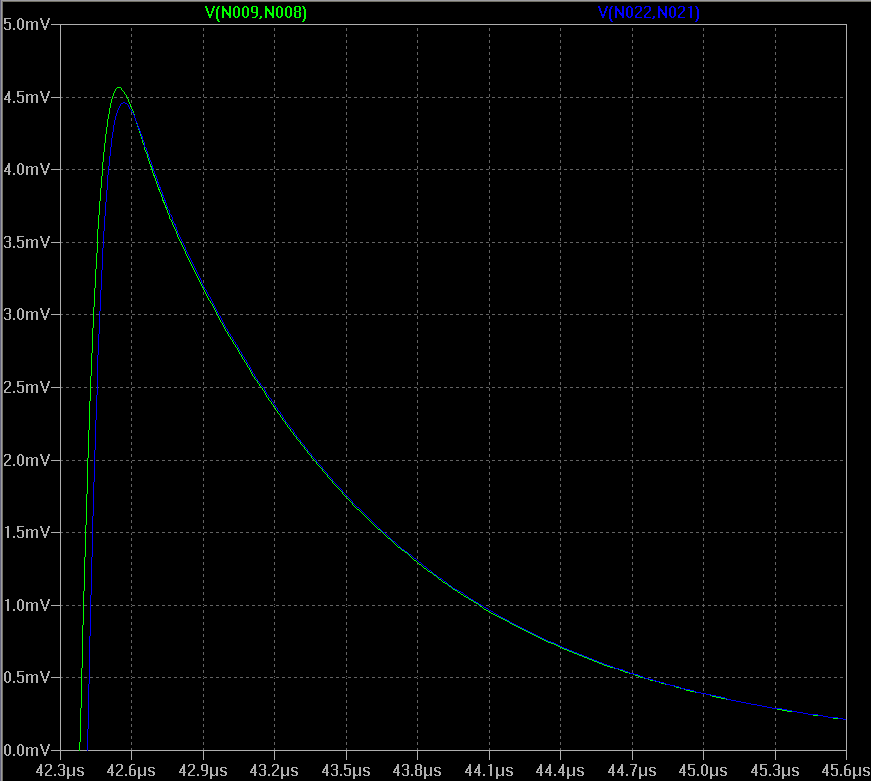

                Slight improvement of target's response:
                This small improvement comes free of instabilities and it only requires a timed switch to turn the R on.

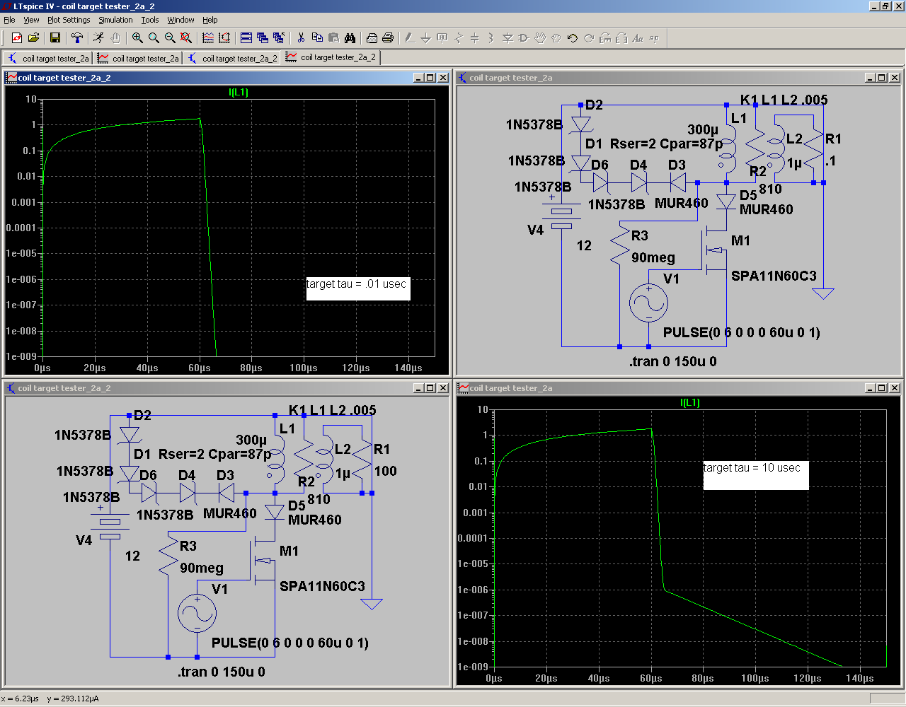

                  Unfortunately the approach is misleading. To grasp it better try observing results in log voltage (or current) scale. You'll be able to observe that the very flyback is the short-lived in comparison with the coil in parallel with any sensible damping resistor. You can't avoid that slope, nor you can shorten it by active damping, because the coil slope starts below 0.1V and runs its course. Target responses fork from this slope, so for a lower level target signal you have to start sampling later. With 300uH and 100p in parallel (a fast-ish coil) and proper screening of MOSFET capacitances, you may start sampling at 15us or so if you are after deep targets. There is no problem to start sampling much sooner if deep targets are of no concern for yours.

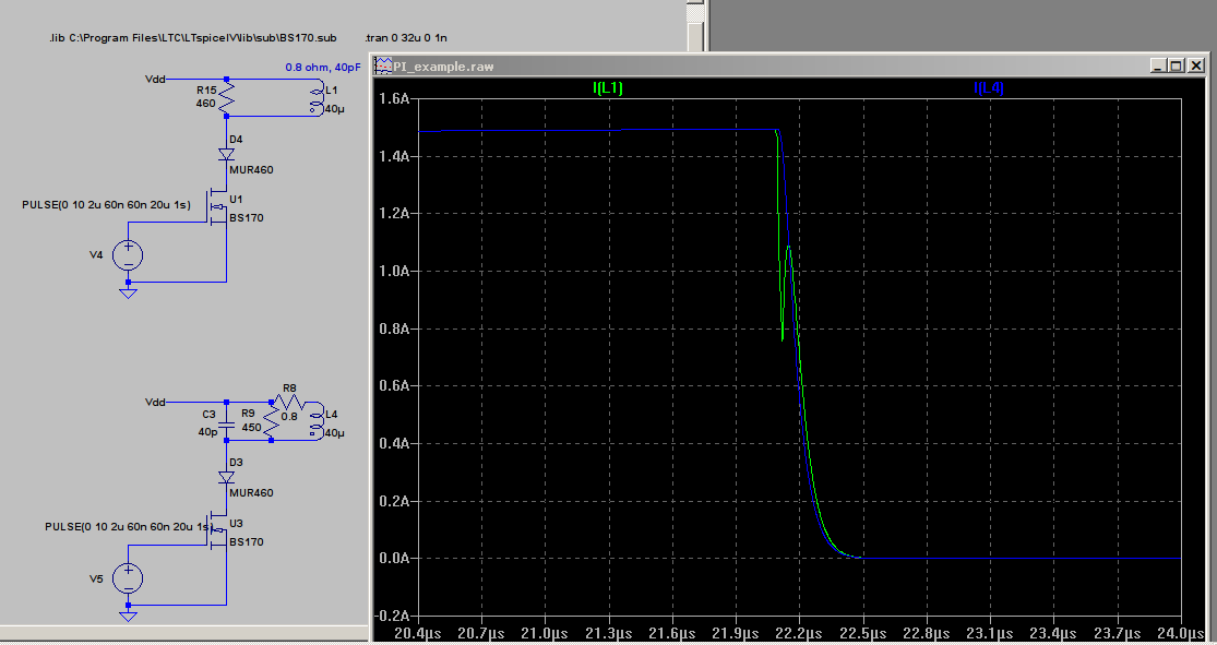

                        Liked Davor plot with a log y scale. Plot the same as reply #24 except for log scale. Had to add R3 to get current to damp closer to zero. The circuit damped to a constant value without it, so it's only needed when plotting a log scale. D1, D6, D4 and D3 are added to the circuit to clamp the decay near 400 volts to match the IRF740 I use on the bench circuit.

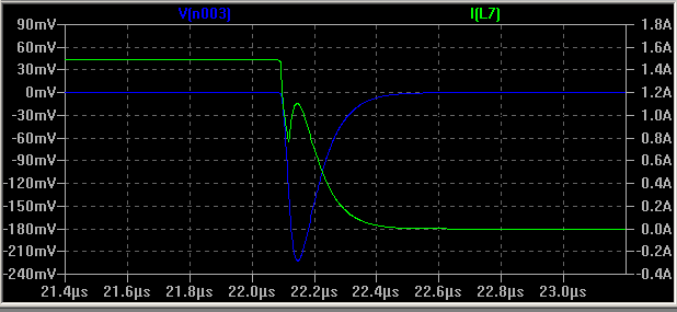

                          Now a funny matter. I've modeling the coil's parasitic capacitance and resistance in LTspice as discrete components. When I switched to the internal LTspice model (filling in the R anc C values in the inductance component form) my circuits started behaving strangely. The discharge is no longer a ramp, but a zig-zagging nightmare.
                          Check these pics below to see wht I'm talking about. I have no idea of what's going on! Can someone provide an explanation?

                          The "bulge" in the ramp of L1, where does it come from?
                          Edit: OK i got it. In the lumped mode can't the current in the inductor's windings is not separatels visible anymore, but in combination with the current of the parasitic capacitor. I coupled a second coil as a "scope" and the induced voltage decay was smooth too. This coil model is not practical when you actually need to visualize the current inside the windings.
                            You can always hover the mouse on a wire you wish to see current going through (voltage probe appears), press "Alt" an the voltage probe changes to current probe. VoilĂ .
                              In reality the series resistance and parallel capacitance of the inductor are distributed, whereas the LTSpice (and your own) are both lumped models. Although the use of a lumped model allows you to monitor the current through the ideal inductor, the result is meaningless.
                                I've been looking for models of real inductors and all I could find were lumped models:Now if I understand correctly, all the current that flows into the lumped model is actually flowing through the windings and contributing to the magnetic field.
                                The magnetic field would be then the sum of the currents in the distributed capacitor and in the ideal coil.
                                The "elbow" in the transient would then be what the real magnetic field looks like (oh s***!).
                                However, when I couple the lumped inductor to an ideal inductor to see what the induced voltage is, the "elbow" is not there. So I assume LTspice only couples the current flowing through the ideal inductor, not through the whole of the lumped elements. Is this a "bug" in LTspice or is it the way it should be?

                                I(L7): total current flowing in/out of the lumped inductor model with 40uH, 40pf, 0.8Ohm (elbow present)
                                Blue line: induced voltage into a coupled ideal inductor of 0.01uH (no elbow)
                                Quite confusing!
