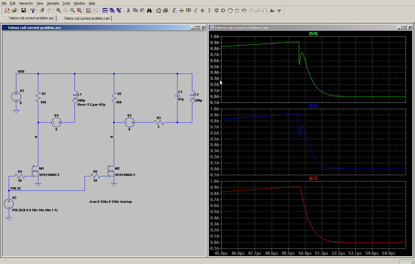

            [ATTACH]31274[/ATTACH]

              Please have a look at the attached image.
              This shows two PI transmit circuits side-by-side. One is using the LTSpice inductor model with parameter passing, and the second is using an ideal inductor with externally defined parasitic components. The current waveform is the same for both examples, as measured via a zero-volt voltage source (which is a short-circuit). I have also plotted the current through the ideal inductor. Clearly the mysterious "kink" in the waveform is due to coil parasitics, and is not a bug in LTSpice.
              Try plotting the current through C1, and you'll see the main contributor.
                Qiaohi, I already found out the lumped model and the discrete model coincide in LTspice.
                My point was slightly different. The capacitance in the real coil is distributed, so there are two possibilities bugging me and I don't know which one is right:
                1. The current in the distributed capacitor is circulating in the coil windings and contributes to the magnetic field.
                2. The only current causing the magnetic field is the one corresponding to the idealized inductance.
                In case 1, the induced voltage in the target would show the "elbow" caused by the capacitor current. In case 2 it will not.
                Now, when couping an ideal target to an LTspice lumped inductor, the voltage induced in the target show no "elbow", so clearly LTspice thinks option (2) is the right one. My question: Is LTspice wrong or right?

                        OK - I understand now what you're getting at.
                        The answer to your multiple choice question is #2.
                        Non-ideal inductors require the addition of extra components, such as a series resistance and parallel capacitance. If even more accuracy is required, you can also model the characteristics of the magnetic core using a second-order polynomial, and magnetic core losses with a parallel resistance. However, for PI metal detector purposes, a magnetic core is only present when a metal target gets close to the coil.
                        You can see what's causing the non-monotonic behaviour in the negative slope, by monitoring the current in the parallel capacitor. The "elbow" is due to resonance produced by the parallel combination of the inductor and its self-capacitance. If you then add I(L) to I(C) in the plot window, the result is the same as I(R). A lumped model is perfectly satisfactory for this application, and distributed parasitics are only required when you get into much higher frequencies where a transmission line model will be necessary.
                        So, to recap, the current measured in the series resistance is indicative of the behaviour of the real inductor, whereas the current in the ideal inductor is indicative of what's happening to the magnetic field. This is why the loosely-coupled target model does not display the same non-monotonicity in the current waveform. Basically, it's not a problem, and LTSpice is correct.

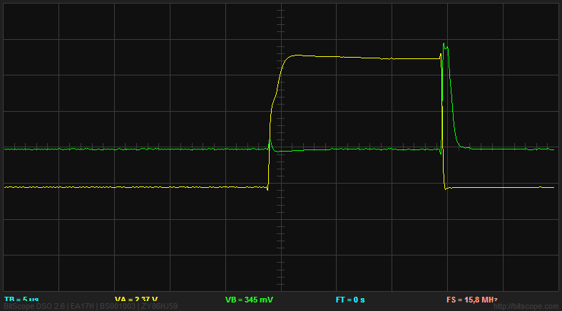

                            The following is a PI experiment (breadboard).
                            Coil: 13uH, 15pF, 0.8Ohm
                            Pulse width: 15us
                            Vdd. 9V
                            Preamplifier: single-stage, transconductance, 3K3Ohm load, schottky transistor.
                            Damping: MOSFET with constant Vgs.
                            Oscilloscope: 2V/div, 5us/div.
                            Yellow trace: coil voltage.
                            Green trace: amplifier output.
                            I've found the trick to make active damping work is a trasconductance amplifier. Notice one single stage can amplify well into the volts range with very low noise.

                              Teleno, just wondering why you use such a low coil inductance, the norm is usually around 300uh ?
                              • #45
                                My goal is to detect small gold particles at a shallow depth (gold inside rocks or right on the bedrock). Kind of what the Falcon MD20 does but using PI instead.
                                The time constants are very short and the only way out is to use low inductance and high current. Active damping allows for earlier sampling. Since tau's are short pulses can also be short, which keeps consumption at bay.
