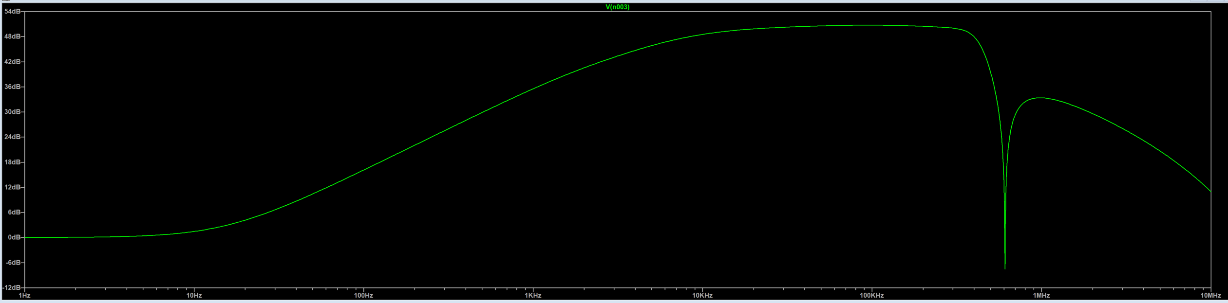

            You are right ..... I put a diode in series with the current sink so it goes open circuit when the voltage across the coil falls below 0.6 volts ... this would normally cause unacceptable ringing ....
            HOWEVER .... if the front end preamp has a response as plot below then the ringing is eliminated :-) the clue is in getting the coil to cancel its own ringing.
            This preamp has a gain exceeding 50db but attenuates ringing and 0db DC gain. Its verrry niiice.

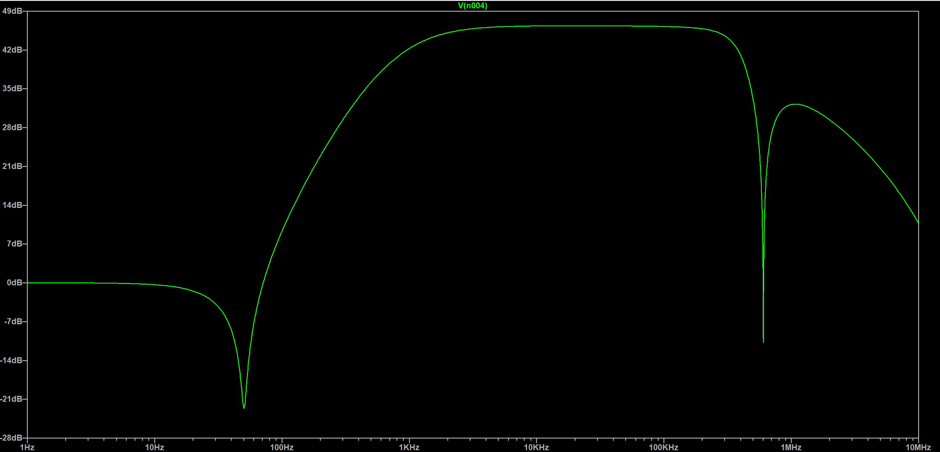

              .... we can bust the hum also :-)

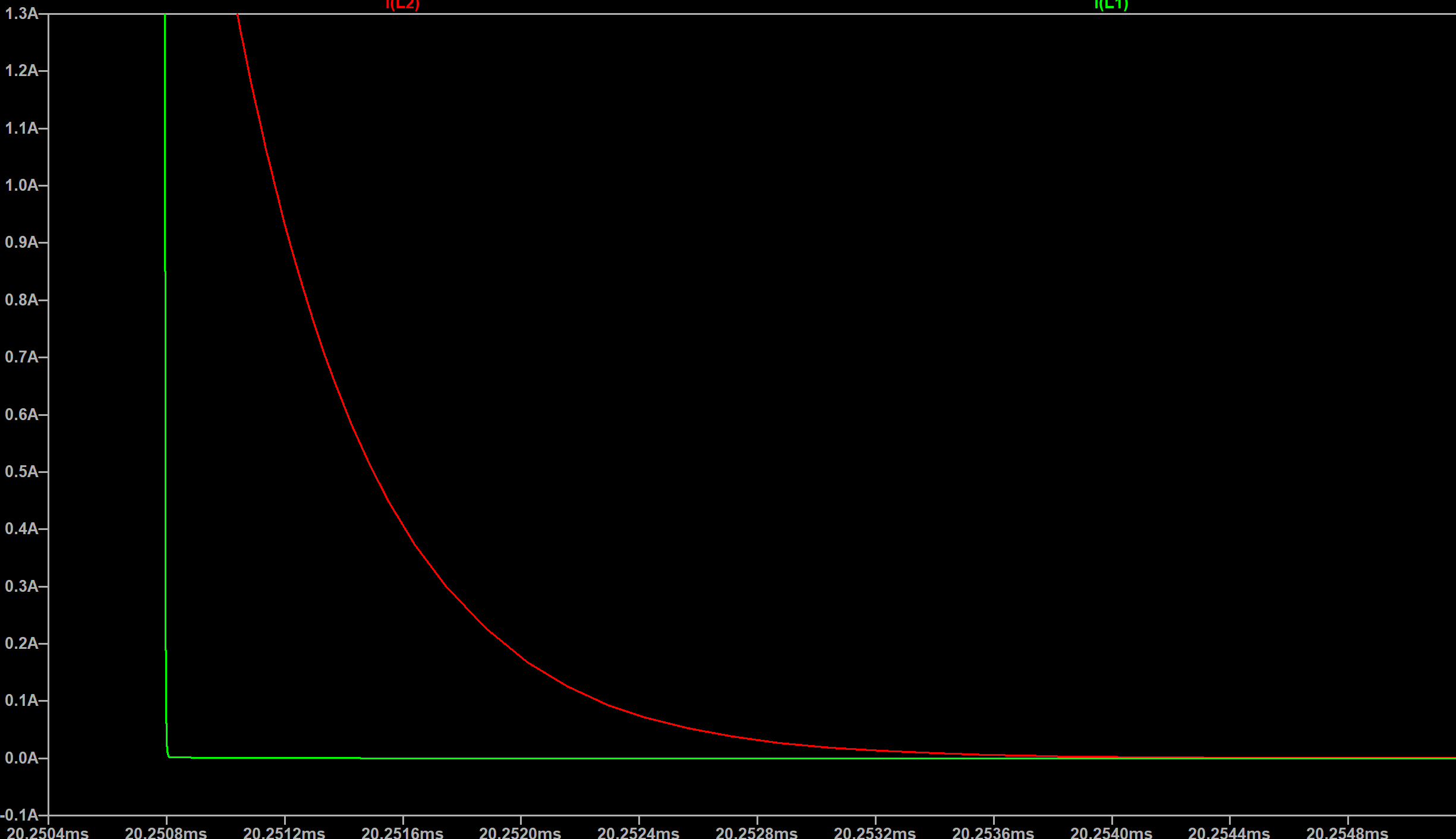

                            ...yes correct ... optimal damping requires very fast switching of the current sink ... the current sink goes open circuit when vcoil = approx 0 volts ... however there is always a small residual. However the results are spectacular .... the PIC below shows a saving of over 6 microseconds in the coil damping using an active damping circuit and ring cancellation. The peak coil current was 6.5 amps. The green trace is active damping .. the red trace is 500 ohm damping resistor for comparison.

                              ... there are two questions ( and many answers here ) ... First it may or may not be desirable to sample earlier ... however the second question is that for a given delay ... the more the coil has "settled" after the flyback the higher the gain that can be applied without overloading the front end preamps. ...and also keep noise out etc. A major noise source is the hot damping resistor in high gain systems for example. The bandpass response in the active damping scheme reduces hum and other magnetic noises below the TX frequency which would otherwise be sampled and produce unwanted noise in the detection band.
                              So there are some improvements provided by active damping in earlier sampling but I have found you can use much higher gains in the frontend prior to sampling which greatly improves the sensitivity of the PI detector for a given coil size.
                                [ATTACH]44133[/ATTACH]
                                I've been using I/T=E/L to calculate current decay. Your graph shows infinite change, wondering how that can be.
