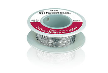

        I use silver bearing solder. This stuff works beautifully. 62/36/02 0.6mm
        I get it from The Source in Canada which is Radio Shack in the US.
        http://www.radioshack.com/product/in...ductId=2062725
        I bought a roll of lead free silver bearing solder from China, the stuff is the worst I have ever used

          SVEN1........Thanks much for your suggestion ! I just ordered a roll of the "Silver-Bearing Solder (1 Oz.) #:2160638" from the Radio Shack ad on e-Bay.
          Radio Shack has been closing many of their stores, due to financial problems and is advertising/selling on e-Bay.
          I went to the hyperlinked address, i.e. http://www.radioshack.com/product/in...ductId=2062725 in your post and the only difference is the diameter of the product I bought being 0.015" (1/64"), whereas it appears you are using 0.6mm diameter (0.0236 inch), but the price was good $6.49 + .47 tax = $6.96 total and FREE shipping with Estimated delivery: Thu. Oct. 2 - Thu. Oct. 16.

              Has anyone used the Silver-bearing Solder in 1/64" (0.015") diameter for soldering components to a thru-hole PCB ?
              How did it work for you ?
              Thanks in advance for feedback.
